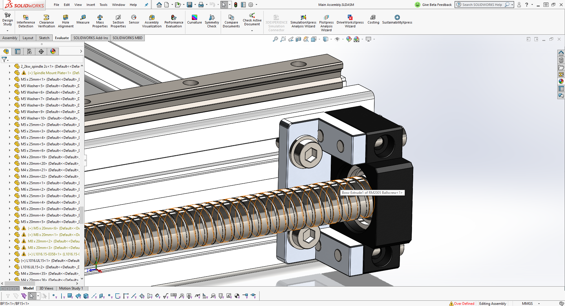

  4. I holed the extrusion cad model then emailed them the model as a .stp but you're using solidworks which they do so you can send them a solidworks file. Make sure the holes are the correct size lol, should be 13mm I think but check this they can tell you if you ring them.
    As for counterboring just tell them to counterbore every hole on 1 side with the correct size head but again they will know this is a pretty standard operation. There's no need to model the counterboring.
    Make sure your hole size is correct! I can measure the correct bolts with a vernier calliper but will have to wait till tomorrow.
    You are using 9045 and 4545 extrusion? If so you will have the same issue I have if using BK12/BF12 ballscrew mounts the hole distance is 45mm between the tracks and the hole distance for the mounts is 46mm.
    My Y axis I'm having custom mounts made for the gantry I'm just going to wangle the mounts into T nuts but did consider custom T nuts offset by 0.5mm. I still might have them made.

    Ok i will ping them an email and ask how best to send to them, My extrusions are only 40x40 & 40x80, i have drawn up mounts that bolt to the Extrusion and then take the BK & BF15 supports. I will 3D Print these first to check how well they work, then have them machined or attempt to machine myself.
    I THINK the 40x40 & 40x80 will take an M10 Bolt? Im not sure and im also not very clued up on the tolerances i should be putting on any the holes i have on the Build, at the moment through holes i have just allowed 0.5mm tolerance for the bolts to slide through - too much or too little?
    I would have to check that through bolting into the extrusion would not interfere with the mounts for the bearing supports at either end of the X Axis, if so i will just have to use brackets.
