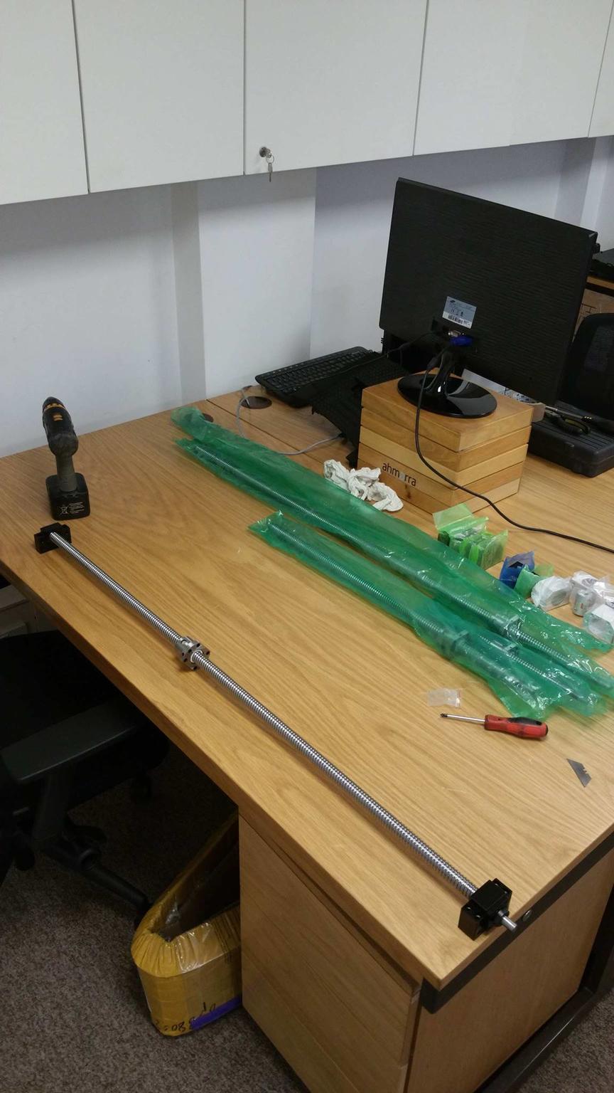

    So my Ballscrews were dispatched from China last Thursday and arrived yesterday, upon first glance they look to be pretty decent (for £170 delivered!), none seem to be particulary bent compared to what i have seen in some threads / videos, the RM2010 screws seem to be slightly stiff but im hoping this will clear up once they are greased / run for a while.
    Ballnuts, supports etc look pretty cheap but will do the job just fine.
    Ordered the extrusion which should also be here this week and also all of the fixings.
    3D Printing the aluminium parts to do a dry assemble, still waiting to hear back prices for the aluminium plates but wont order anything until i have assembled it using the plastic parts to check everything fits properly.
    Alex
