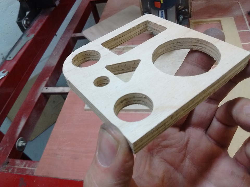

    My belt drive cnc was built for milling foamboard but recently thought it would be nice to cut plywood and acrylic. Basic spec: nema 24, t5 belt, Gecko, Mach 3, 900w spindle (12-26,000rpm)
    I was reading this very helpful F&S thread below, which gives a good indication of what i should be aiming for. However as my machine uses, belts and v-groove bearings and is a light weight design for speed I am wondering if there are setting I can use which will at least give me a chance of cutting something denser with multiple passed with reasonable success.
    http://www.mycncuk.com/threads/4330-...-and-feed-rate
    I can see from cutting through 9mm ply using 2mm passes that the tip of the single flute cutter is blacking pretty quickly. The timber is not blackening but 20mm/s is not very fast is it ha ha and probably part of the problem.

    Seem to be getting somewhere with the 12mm ply cutting after carrying out everyone's suggestions + tightening a slightly slack gantry. Thanks for everyone's help.
    Feed 20mm/s
    Speed 15,000rpm
    3mm, two flute up cutter on 2mm deep passes
    Mach3: Velocity 2500 and acceleration 500
    I'm not getting the F/S issue of cutting corners i had before and neither is the cutter or timber burnt.
    I am however still getting a furry edge, the block of wood was lightly sanded to get rid of the burr edge so they are not so prominent in this image.
    I'm going to invest in a 3.175mm down cut and compression cutter to see where those results take me. At the moment i'm only intending to cut smaller parts and perhaps some cabinet doors at a later stage when I upgrade the gantry and whole machine to R&P.

    I set Aspire to profile cut a 400mm square at 100mm/s and timed how long it took to mock cut out the full 1600mm. This took 51.40 seconds. So at 30.9mm/s actual speed, clearly not the 100mm/s set in Aspire. The spindle speed is not set in Aspire but on the actual spindle.
    I tried the test again using a faster speed but it gave exactly the same time to travel 1600mm. So it must be that motor tune setting are incorrect or inhibiting speed.
    My config settings are 26 stesp- 2000 velocity - 1000 acceleration
    (As as side note I recalibrated X and Y axis so they are scaled correctly).
    lets say as a rule of thumb I wish to cut out 12mm plyood in forms less that A4 scale with a mixture of straight corner and curved shapes, 10mm slots and 8mm holes etc. So reasonable detail.
    I'm a little bit stumped why I couldnt change its speed in Aspire and why 100mm/s does not translate to its actual speed. I'm missing something basic am I not ha!
    Any ideas welcome

    Well is sounds like you have a max vel. setting somewhere that will limit your commanded speed. What software are you using?
  10. The Following User Says Thank You to Clive S For This Useful Post:
  11. #9
    Hmm..i hadnt thought of that i'll have a look in Mach3 tomorrow. Thanks
  12. #10
    Your velocity is set to 2000mm/min, which is about 33mm/sec. The Velocity setting is the Maximum Mach3 will move at.
    Gerry
