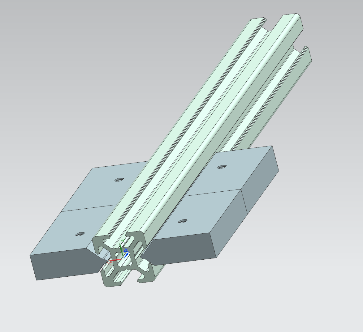

    Well, 260euro for 6x 1300mm + 6 MGN12H, just payed it so is done.
    That will not stop me buying the Delrin balls though. Just for the experiment. By the way as the guy originally designed the bearings not in parametric, i took my time yesterday to redesign them from scratch. I did not like the not squarish design. I have also some other idea about the preload and how will look at all. This is the result for the moment. More purification when i have the balls and have tested the length so the balls fit tightly and exactly

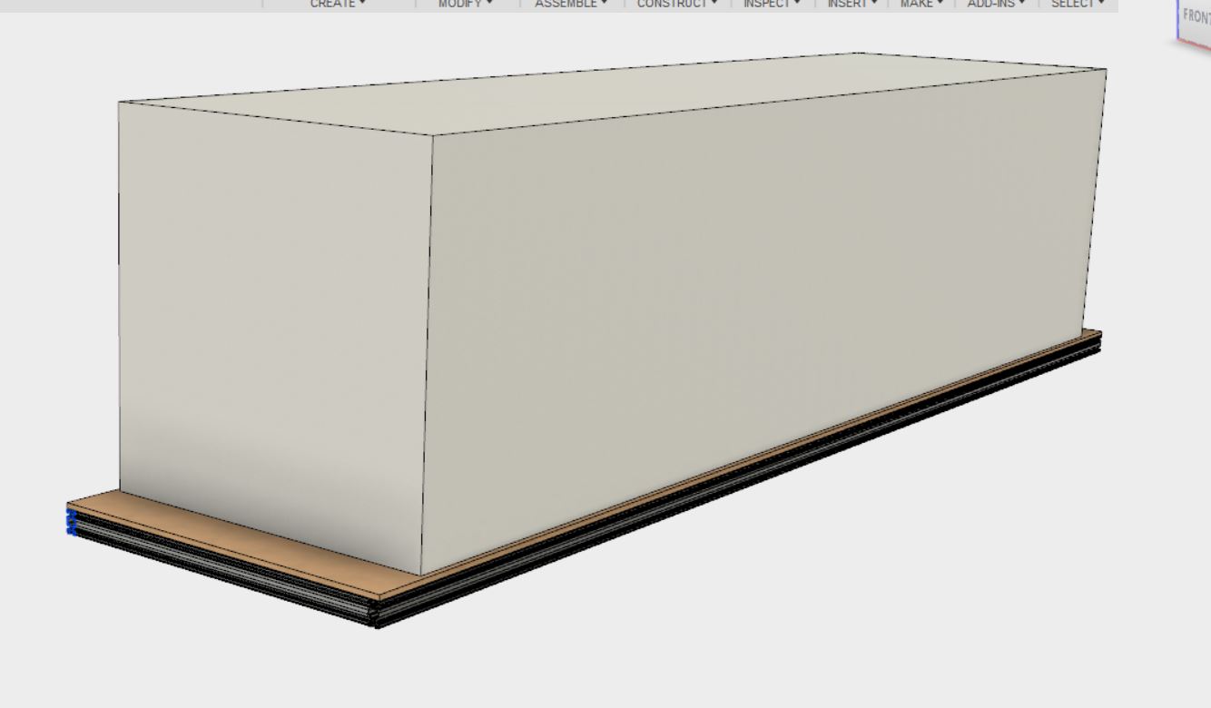

    I started drawing my thoughts up is there any difference running the linear rails on the side rather than top of the extrusion?
    I don't see any problem with that
  6. #26
    Quote Originally Posted by charlieuk View Post
    I think there is not absolutely any need the foam block to be supported by the structure . It could easily be simply on the floor or lifted by rests of foam. or a bed formed from foam leveled by the wire.
    Same could be said for my design, but the cross bracing supports the smaller alu profile i am using against twist.
    project 1 , 2, Dust Shoe ...
  7. #27
    The problem comes when you have to move the blocks of polystyrene around, the blocks are not all that light and I'm dealing with 16' x 4' x 2' blocks so having a smooth and flat table to easily side them on to make it posable just about by myself were your method I probably could not. I allso will be putting mine in a 20' shed that has a wood floor so I need to build some extra strength into the design so it is self supported.
