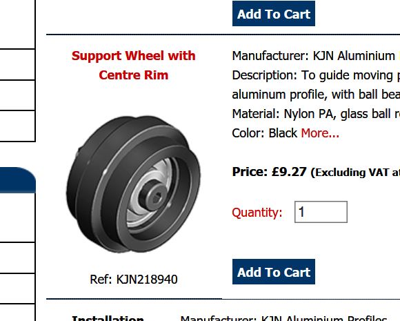

  8. #38
    I'm thinking maybe these and 3 per side for the main axis and maybe stick with the linear rail for the vertical. It sucks I really hade to cut corners but for the amount it will be used I cant justify 1k on linear rails.
    other wise I guess It would be using some sort of bearing carriages to run on some steel guides. like cnc router parts do.

  9. #39
    Quote Originally Posted by charlieuk View Post
    Most probably that rollers will not do. Inside there must be angular contact bearing or a bearing with no clearance. I am 99% sure thats not it. Plus they need to be turned, not molded plastic

    Charlie I think you need to be realistic regarding the tolerances here, I don't know but surly you won,t need more than a 1mm for cutting foam you are going to get sag in the wires etc. I think something like what you are planning should work ok.
