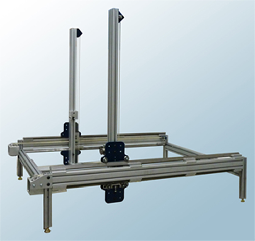

    spent a while looking into other rail options. I spoke to the guys at hepco however even there basic utili track is going to be more than genuine hiwin so that's out!
    I think its going to be between plastic rollers direct on the extrusion or making some sort of v wheel of bearing setup that runs on steel.
    I have seen a few options for this there is one were they are using angle steel bolted top and bottom to which the bearings run on which would probably give the most stiffness if I were to want to run it as 4 axis (sorry pic is a little small)
    other wise I think I will maybe try and make my own plastic wheels ether by turning them on the late from something or perhaps 3d printing them maybe ?

    Thanks for the update glad they are ok and will do the job. As much as I want to use slides at probably over £700 by the time they arrive just to do two axis I think I will give the roller idea a go first and do a few quick mock ups and see if I can get the stiffness to do what I want at least for starters. The aluminum on its own is the best part of £500 so to do such a simple job that im after a machine that would end up at around £1500 is going to be over my budget.
