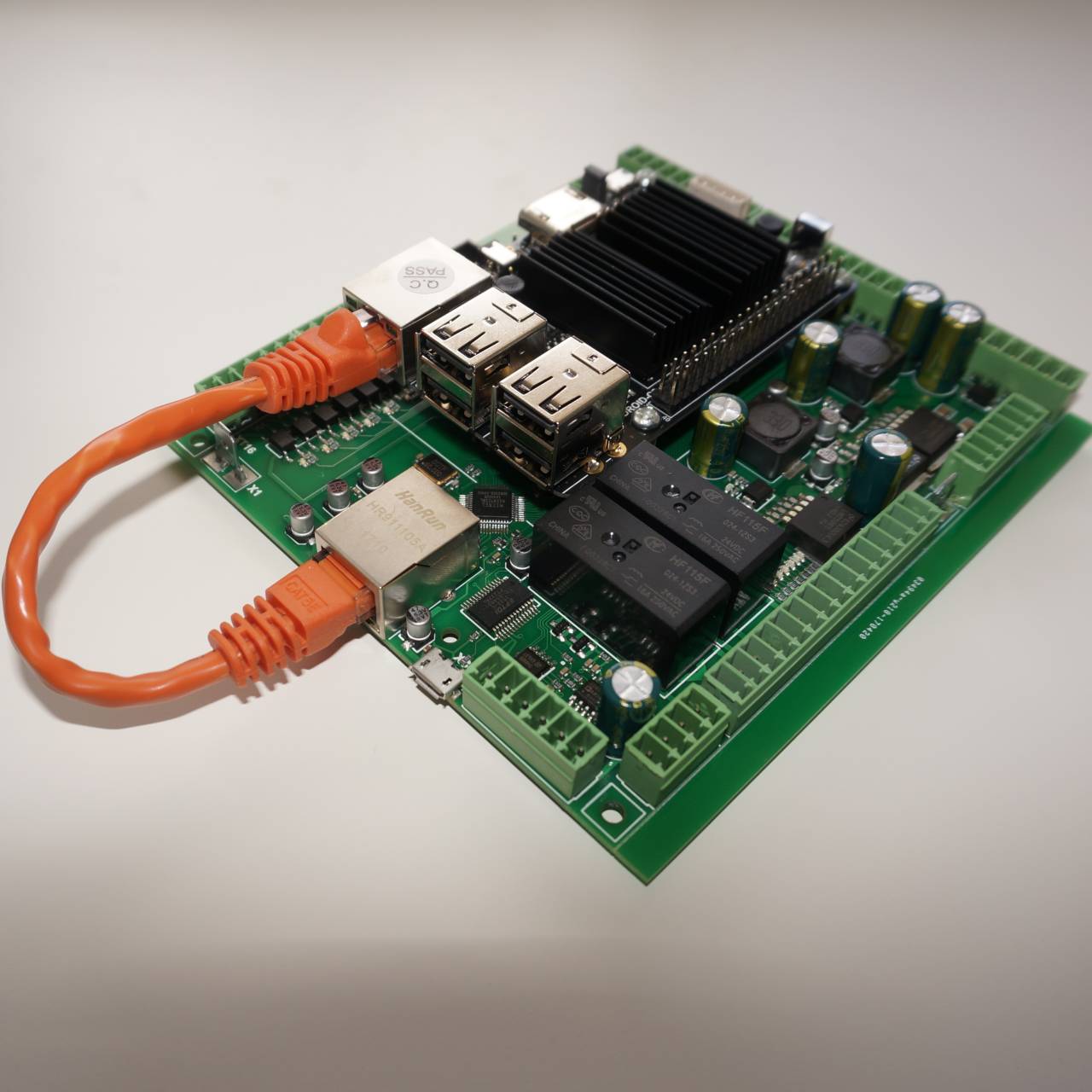

    About pricing.
    I looked at CS-labs and kflop prices.
    Cheapest 6 axes CS board is 559 euro, add there Mach3 licence. For about a half price you can get 6 axes ET6 board WITH COMPUTER and software included.
    kflop + galvanic isolated inputs board going to be more expensive then ET6 as well (again computer is included in ET6 kit).

  5. myCNC-ET6 board contains
    - 6 axes pulse-dir (3MHz)
    - 8 galvanic isolated inputs (2 groups of 4 inputs with separate supply to use PNP and NPN sensors)
    - 2 relay outputs
    - 2 open collector outputs
    - 3 PWM open collector outputs
    - RS485 modbus
    - 10V DAC output
    It seems kflop does NOT have any galvanic isolation, relays, transistor outputs for IO.
    I mean If you need to build similar MINIMAL system with kflop you need to add their IO board ($199).
    A set will be more expensive, than ET6 kit (ET6 + Computer).
    I don't tell all our boards are cheaper. But looks like we offer more affordable entry-level solution.
    Keep in mind we offer Ethernet controllers, not USB. It can be important for industrial applications.
