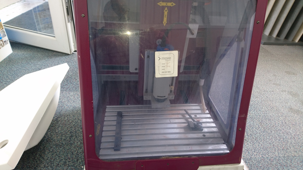

    Im starting a new thread on a new toy i have bought, Im almost a novice in CNC, years ago I did build 3/4 of a plasma table but Ill health and circumstances meant it never quite got finished
    any way, the story so far,:

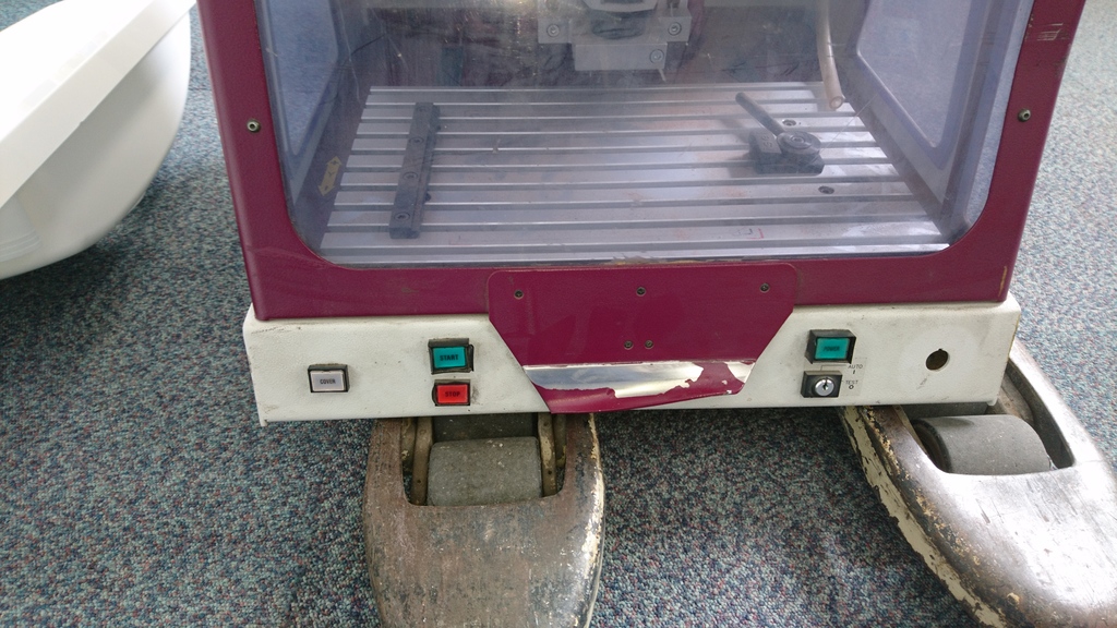

    in return for fitting a 4 post car ramp I was given a brand new 3Hp single to 3 phase inverter, I found my self at a loose end with half a day spare in Chester, so I wandered down to Chester engineering just to see if they had cheap mill, lathe something to use inverter on, wandering around there was a small cnc desktop mill with "OFFERS" on it so being cheeky and having £100 "play money" with me I offered them that CASH after a bit of bartering and shaking of heads I paid my £100 over and had mill put into my Smart car, Just.

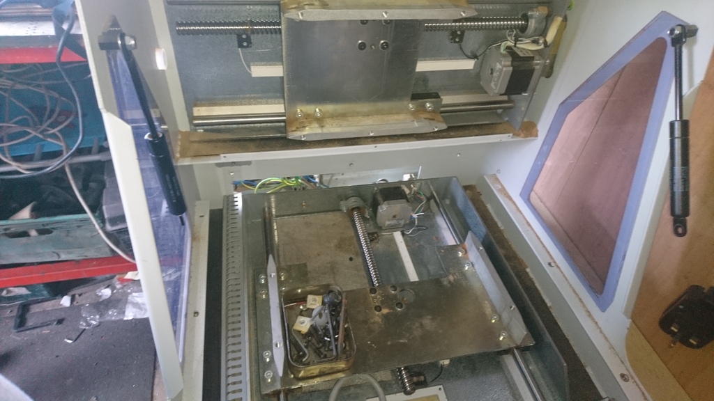

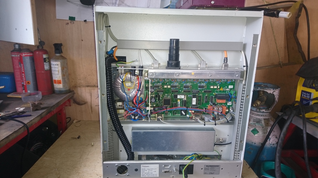

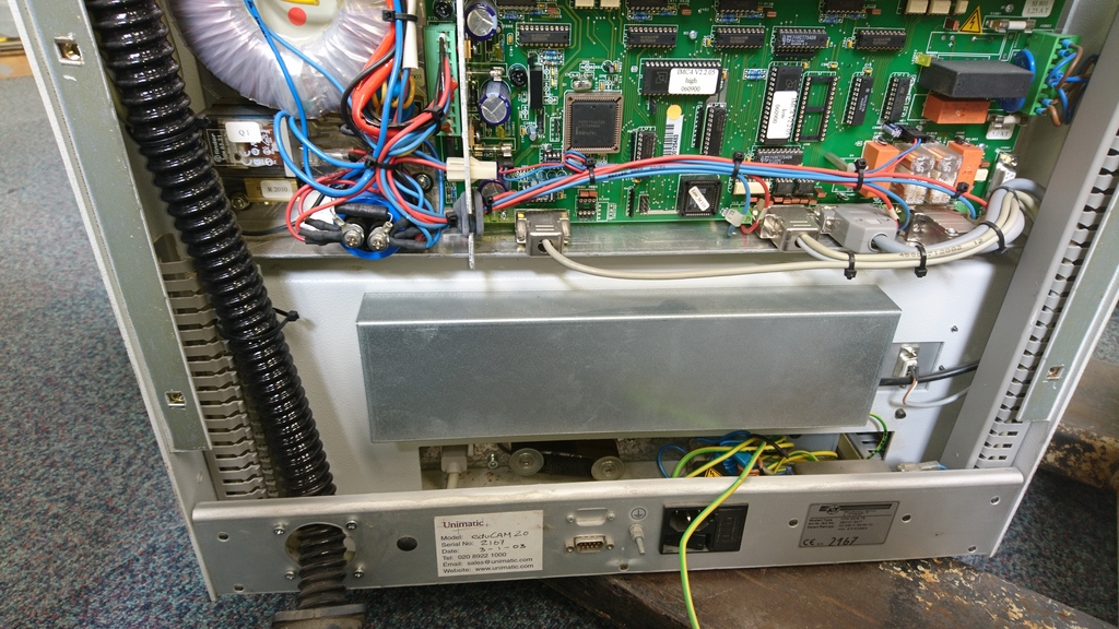

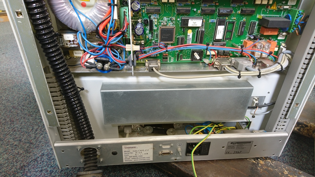

    so here is what I have please see pictures below, I have been out this morning to look under all covers and see whats there, they are 8 wire Isel steppers,
    It powers up all axies hold strong under power, I can not push them so i assume all steppers are fine, light comes on, and cabinet unlocks, seems to have had little use on any thing other than MDF
    what im thinking is as machine is old, slow evedently, and software is a hell of a price, even though i have been offered a KAY software for £50 I think i would rather put that money to making it run on Mach 3 that I already own. I have no idea what to use yet Im open to your suggestions PLEASE when I remove existing circuit board I will have a area in back some 500mm wide 400mm high and 100mm deep, that i would like to get a Micro itx mother board PC, a power supply from a shuttle pc that i have but can only get to run on vista, A BOB of some description and its PSU and 4 stepper drivers X,Y,Z and A should i ever need, so apart from key board, mouse and monitor it comes as a self contained unit,
    All your views, comments and ideas will be most welcome,

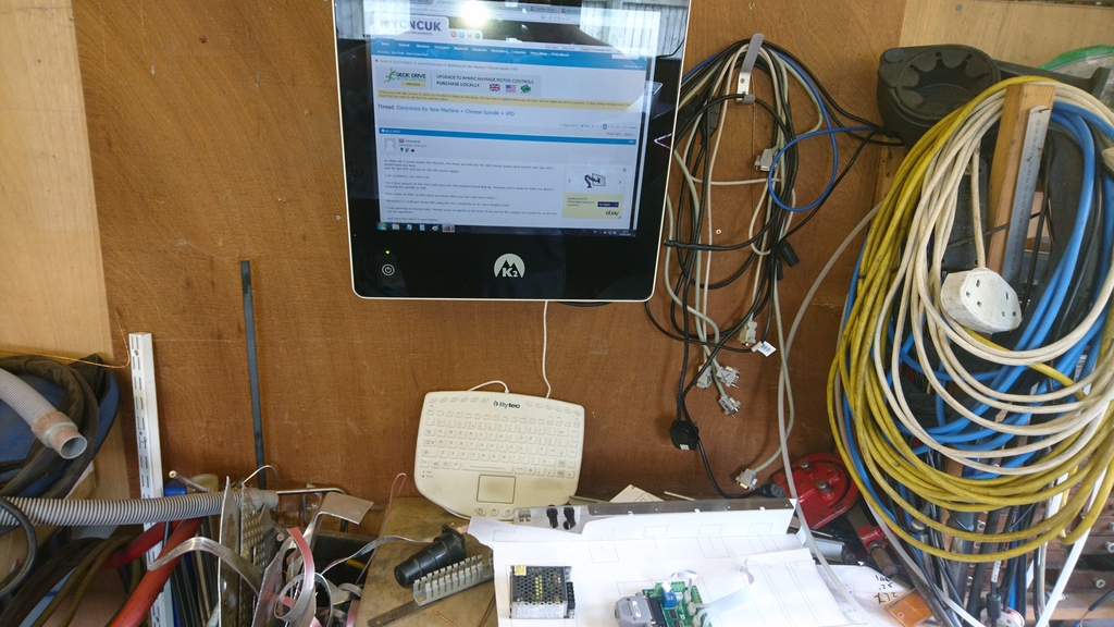

    A bit of a update,

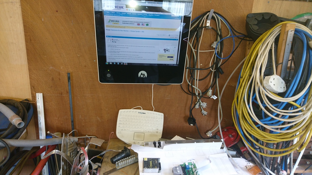

    I have bought a touch screen "medical all in one" pc from ebay just as a mancave PC to run Frankie Isel at £8.33 plus delivery was a bargain (i had a £25 voucher from some where)
    I have bought a UC100 motion control and A KK01 BOB, from CnC4You and ordered some CWD556 form china £20 cheaper each, may have to wait a few weeks but loads of other things to do in meantime, also ordered a 36v and a 5v switch mode psu's to run things, Im going to use original steppers there isel High-Torque Stepper Motor MS 135 HT and Thanks to Clive S I have a idea how to wire them now, Bits for JazzCNC e stop circuit are on way form Ebay

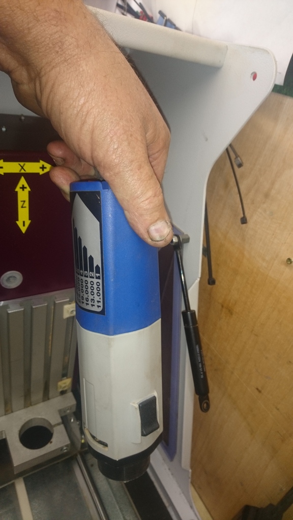

    Still need to decide weather to go with original router head, nut and collets missing or go for a brushless spindle motor that probably wont cost much more than a replacement nut and collets

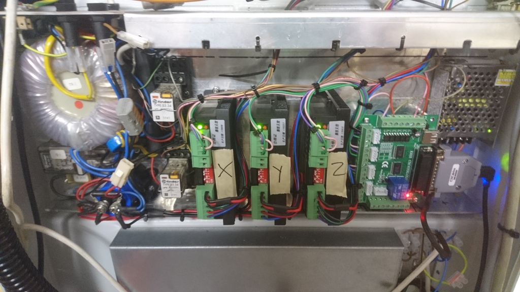

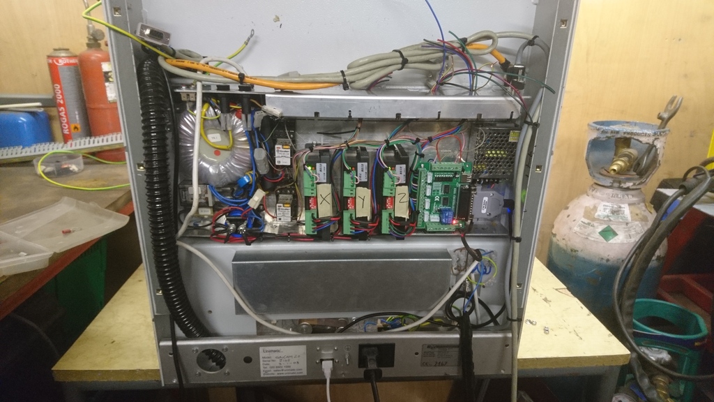

    I had a quiet day went and wired electronics, I have used a KK01 BoB, CWD556 drivers, a UC100 motion control ( but bloody thing keeps dropping out no blue light) I have used 3 of the windings on origional transformer I built a couple of rectifiers to drive the E-Stop and limits through a couple of relays
    Just waiting for some 9 pin breakout boards to connect to origional motors But all powers

    all running now I need to decide what way to go with software untill today i thought my Mah3 was a full version but after a update its showing demo, so Mach4 (but after playing all day with demo cant get head around it) Mach3 licence
    or the outsider UCCNC I did think of fusion 360 but pc is only 32bit Please someone give me some pointers
    Steve
