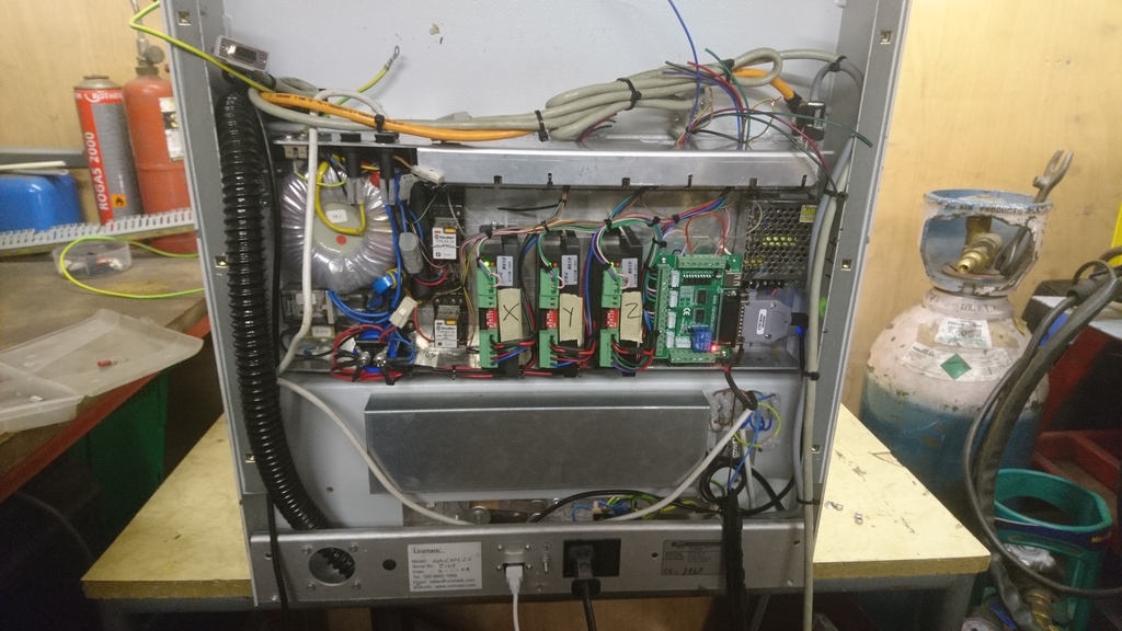

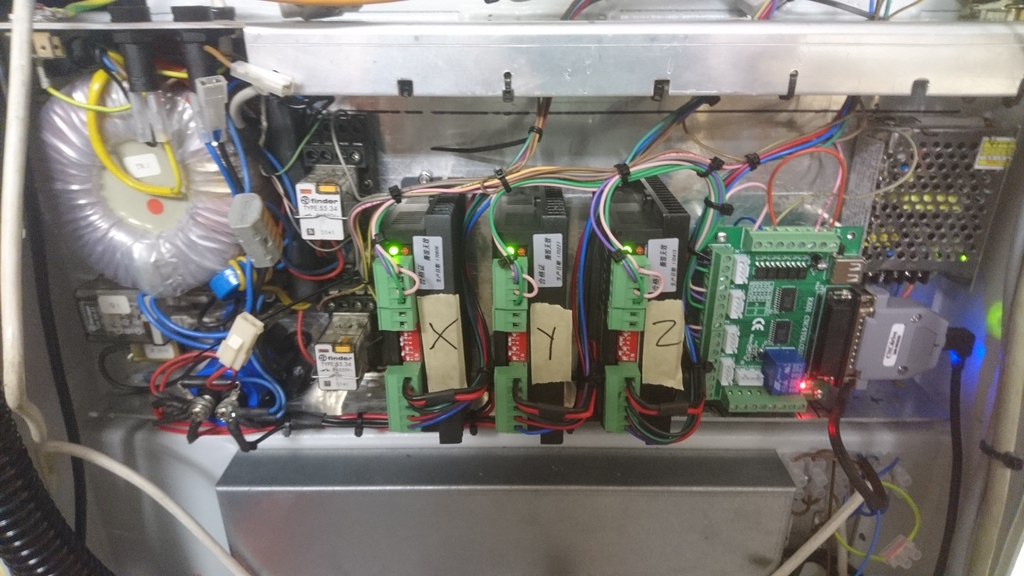

    I eventually managed to open the back cover. Drivers are L292, limited to 2.5A.
    I found the electrical diagram of the IMC4 controller here:
    https://www.mikrocontroller.net/topic/367459
    For those who want to upgrade the machine without changing the whole electronic part, this upgrade card may be interesting (requires Kay control software):
    https://www.spline.nl/machines/cpm.php
