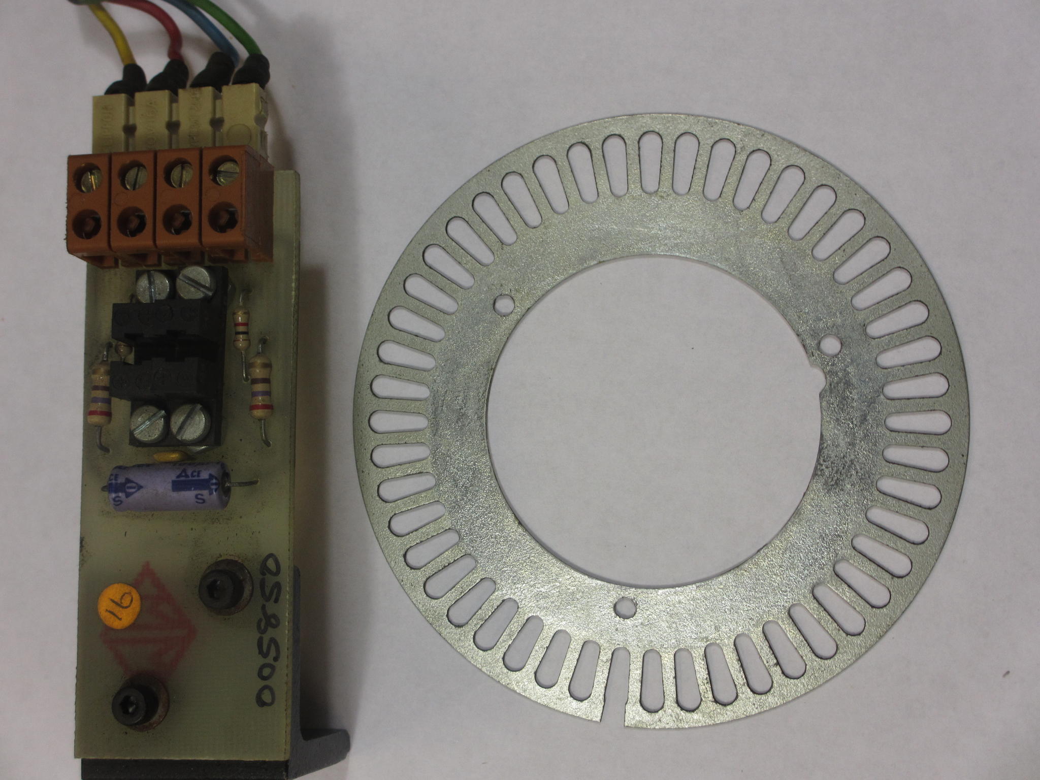

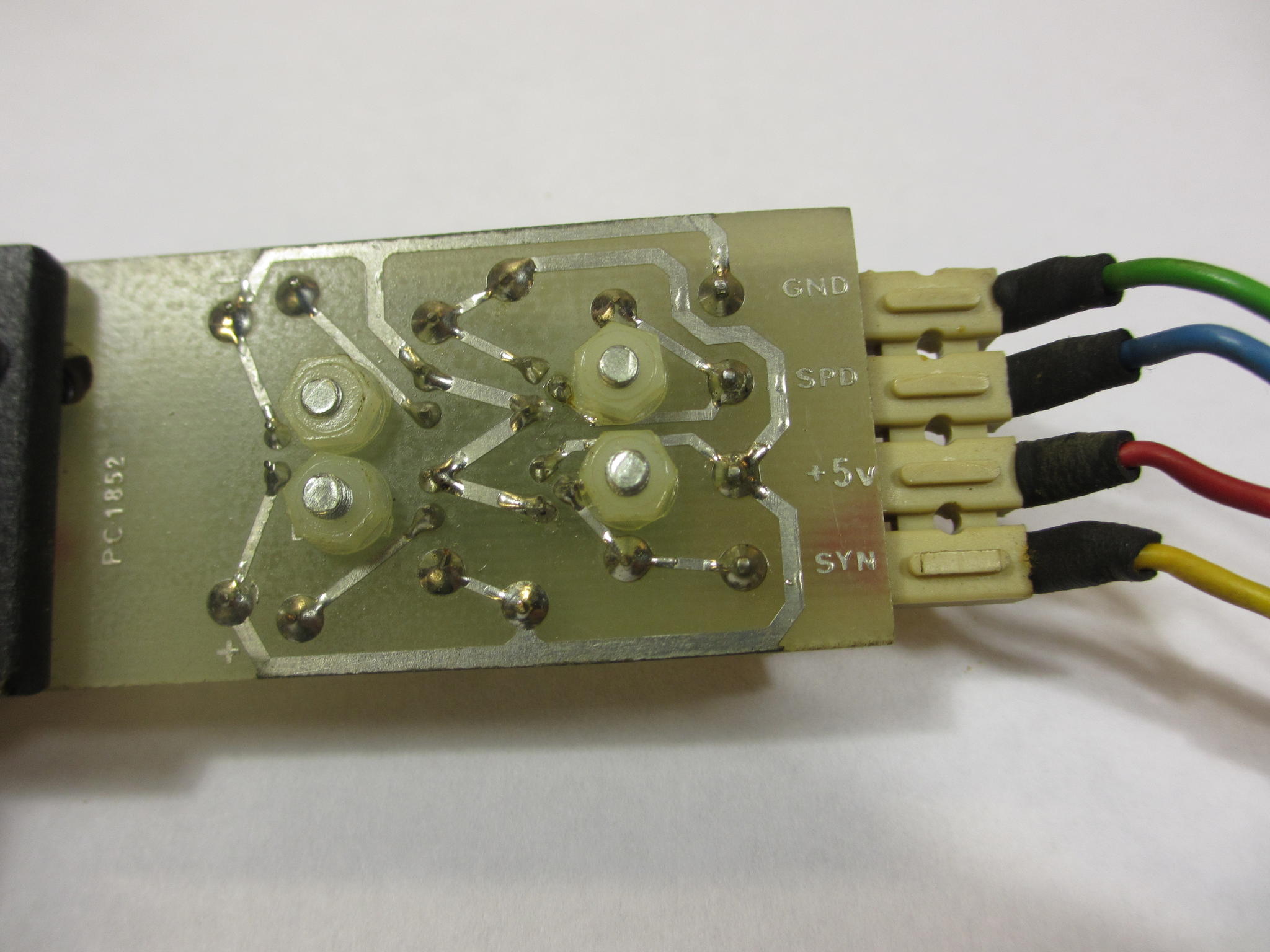

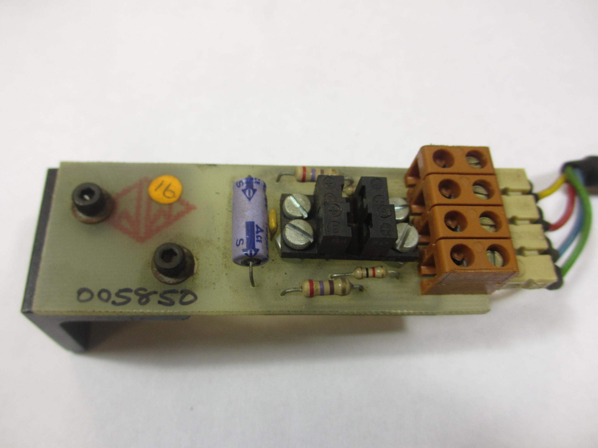

    Does the spindle have a full incremental encoder, with A and B outputs?
    I know my cyclone only had an A output, and I had to connect up the additional terminals in the encoder to get the B output.

    To be honest i've not really looked into the encoder yet and how it works. ( hopefully a few photos are attached !)
    But it appears to have 2 sensors , can you enlighten me anymore from the pics ?
