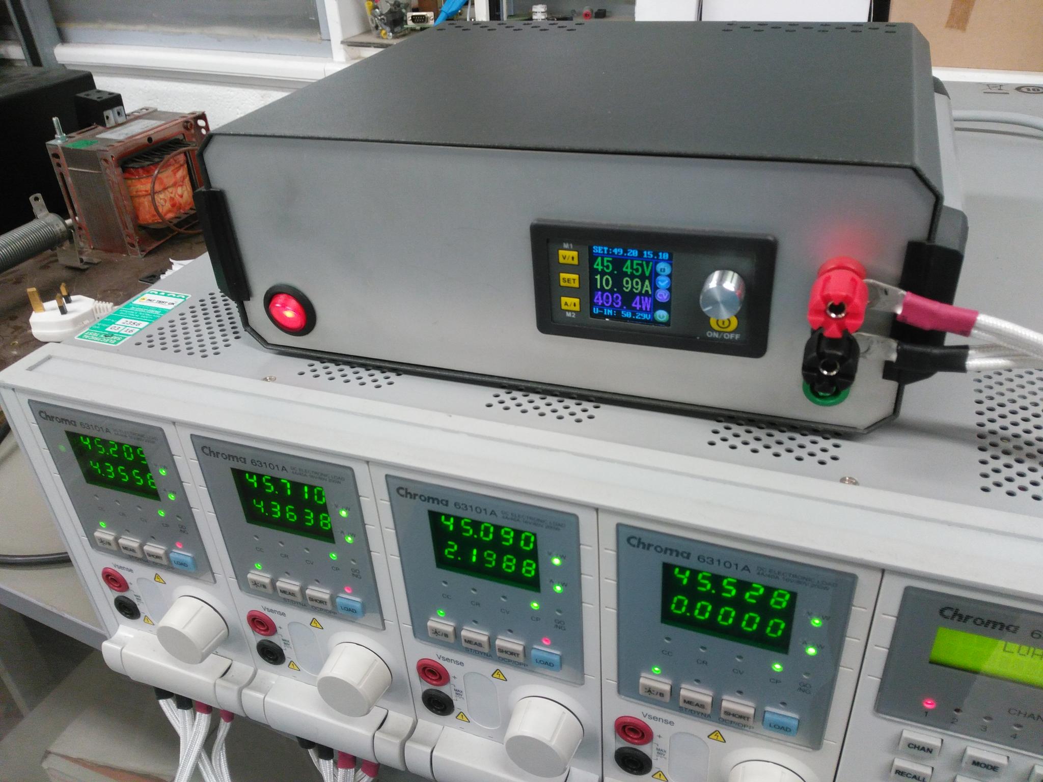

    One of these:
    https://www.aliexpress.com/store/pro...22388c28Yvk2a1
    With a suitable transformer - or batteries if you want.
    Housed in a case, if you want ...
Name:	2016-11-16 00.33.25.jpg
