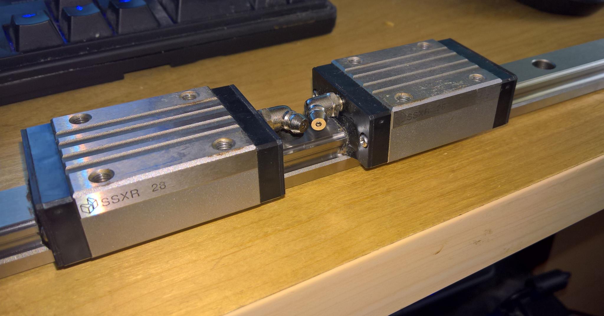

    I have some Misumi SXR 28 blocks & 20mm rail.
    I can't give a practical opinion as i haven't used them yet, but they appear to be very high quality.
    The blocks run very smoothly with no discernable play.
