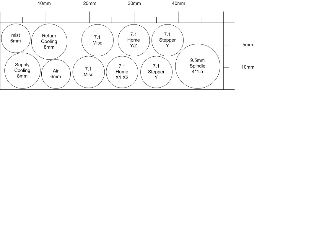

  9. #118
    Ok so,
    Cable chain,
    Will this fit?
    Looks like it is gonna work.
    Things to put in the drag chain.
    Ground wire 4mm2 6mm
    Spindle cy 4x1.5 mm 9.6mm
    Home/stop combined
    y/z home switches cy 4x0.75 7.1mm
    X1,X2 home switches cy 4x0.75 7.1mm
    y stepper cy 4x075 7.1mm
    z stepper cy 4x0.75 7.1mm
    Spare 1 cy 4x075 7.1mm
    Spare 2 cy 4x075 7.1mm
    Supply / return line spindle cooling 2x 8mm
    compressed air line 6mm
    coolant line 6mm
    Grtz. Bert
  10. #119
    Quote Originally Posted by driftspin View Post
    Ok so,
    Cable chain,
    Will this fit?
    Home/stop combined
    coolant line 6mm
    Grtz. Bert
    Awesome job!
    Have you thought about what happens in the cable chain radius?
    I think there has to be some "air" for the cables to move..? But I might be wrong :)
    I'm thinking the cables in the outer layer needs to get longer than the ones on the inside...?
    No limitswitches? From what I understand softlimits are ok for some...

  12. #120
    Home/stop combined
    Bert.
    Why do you need a ground wire in the drag chain, also if you want to use cy cable for the switches why not use 3 core 0.5mm. I just have 4 mm air lines in mine and find it ok. You could also use 1.0 mm to the spindle as it is 3 phase and the 2.2kw will be split between the cables.
    Just a thought.
