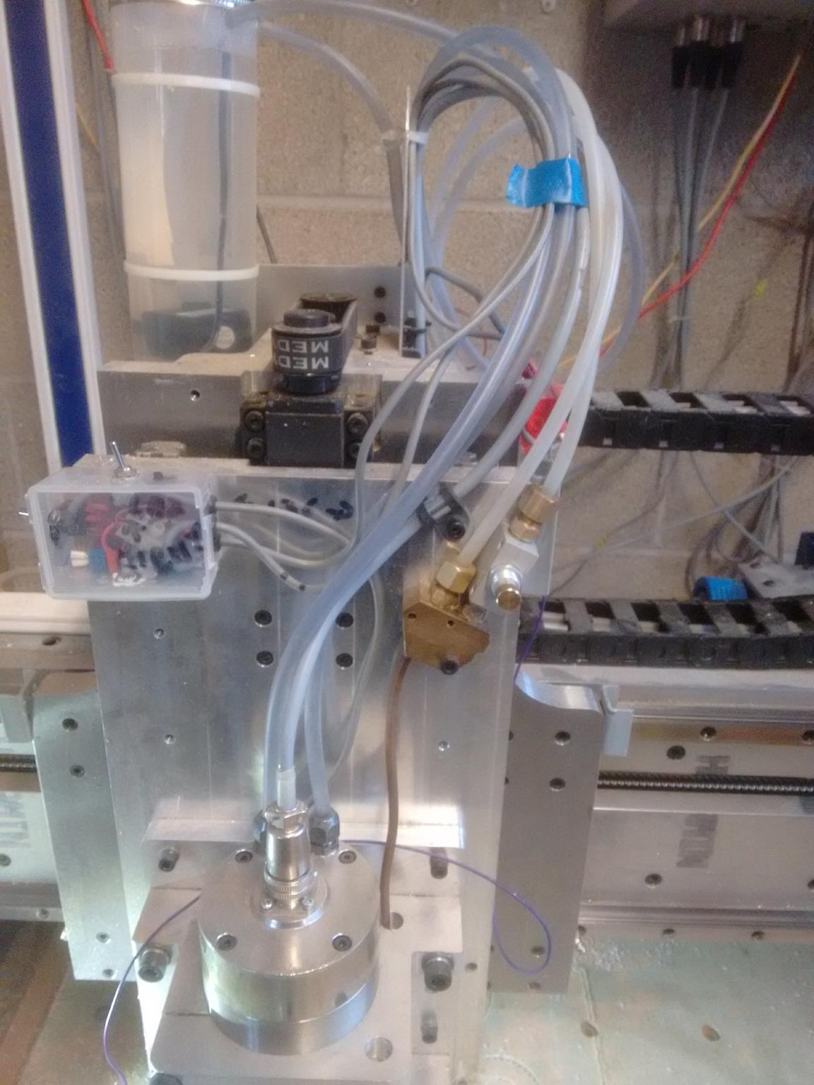

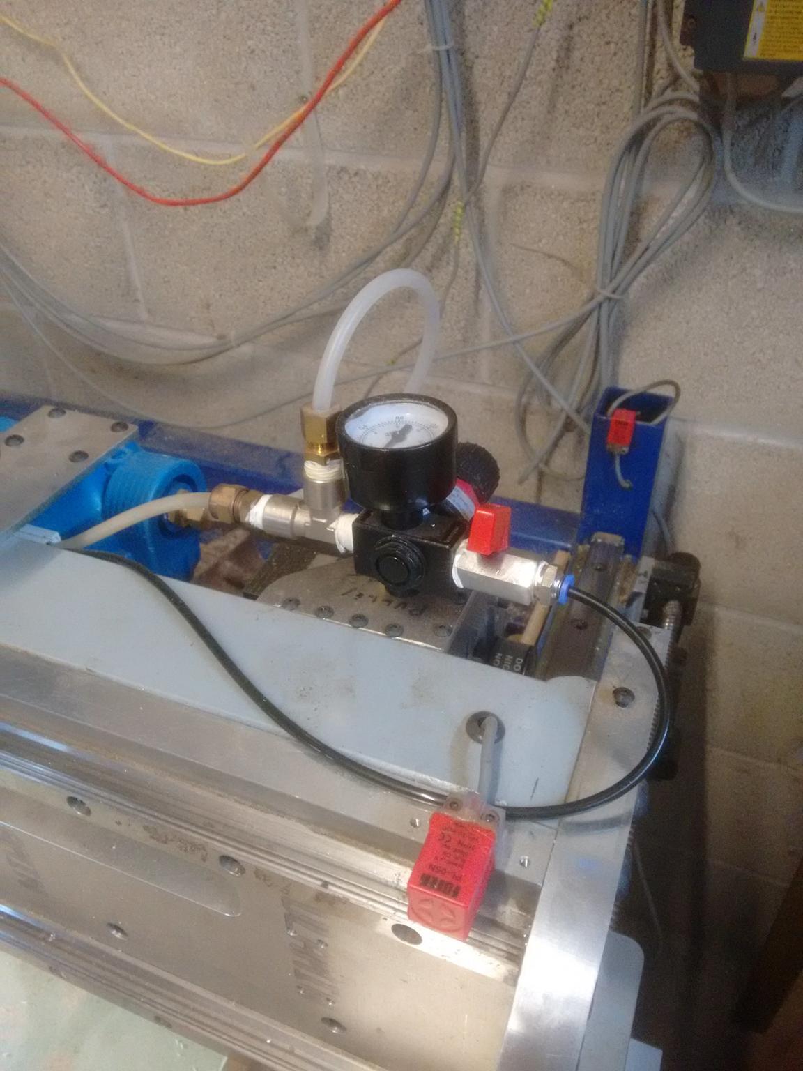

    Q1
    I would like to know about pc pump radiator setup on z assembly for spindle cooling, is it an ok option?
ID:	24048Click image for larger version.
ID:	24049Click image for larger version.
    The black tube into the reg. is feeding the air into the blue water filter with WD in it (just behind the gantry) and also to blow the chips away. You can see the cooling water 1Ltr on the gantry.
    The fan is 120mm
