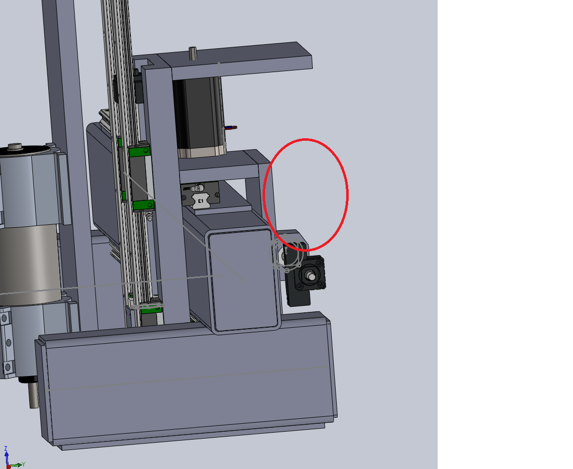

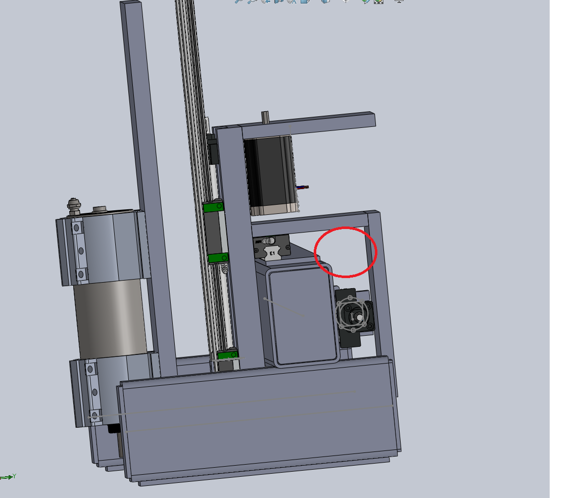

    Hi All,
    I would like your opinions on the following.
    Since my Y axis ballscrew is at the rear off the gantry, i have to make a choice.
    Have the fixed end of the cable chain and ball screw inside the z-axis assembly or out side.
    Like this or that:
Name:	Gantry CableChainLocation 2.png
ID:	23665Click image for larger version.
Name:	Gantry CableChainLocation.png
    The chain would rest on top the gantry with a simple L support screwed to the back of the gantry to allow for a chain wide enough.
    Moving end of chain would connect to the top z assembly plate near the nema
    I feel keeping the box that surrounds gantry as small as possible, is best for rigidity.
    On the other hand i would not have to make a separate floating support system for the cable chain.
    Adding more weight and vibration.
    Also i think having it on inside would look much better.
    Grtz Bert.
  4. #73
    Hi Bert,
    Personally structural integrity wins over cable routing every time. So I would go with the image on the left with the closer ballscrew connection. Then make the neatest job of mounting the cable chain on the back. Wouldn't worry about weight and vibration of the extra support bracket holding the cable chain.
