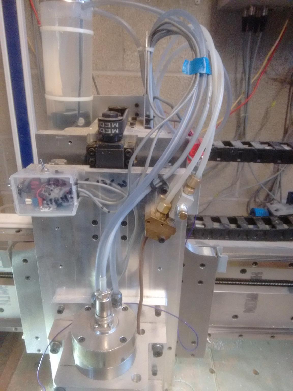

    The black tube into the reg. is feeding the air into the blue water filter with WD in it (just behind the gantry) and also to blow the chips away. You can see the cooling water 1Ltr on the gantry.
    The fan is 120mm
    Ok,
    I realise now i need a solution for connectionbox sensor to cy cable.
    Thanks for the pictures.
    I am gonna think about through gantry cable ways for x1 x2 sensors..
    Some extra planning.
    Grtz Bert.

    I use something like this on the back of the gantry with less that 1 ltr of water. https://www.aliexpress.com/item/80mm...ceBeautifyAB=0
    but you can get one with a little bigger and fit a 120mm fan.
    Re the VFD 2.2Kw is at the mains side so at the motor side rough figures prb. about 4A per phase ish.
    re the 4mm tube I find that more than enough flow. I have it at about 8 bar and regulate it down on the gantry.
