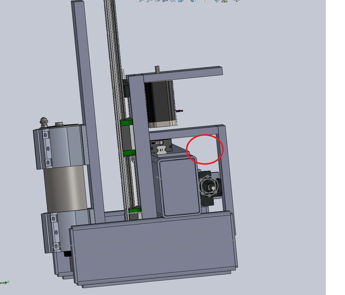

Hi All,
I would like your opinions on the following.
Since my Y axis ballscrew is at the rear off the gantry, i have to make a choice.
Have the fixed end of the cable chain and ball screw inside the z-axis assembly or out side.
Like this or that:
The chain would rest on top the gantry with a simple L support screwed to the back of the gantry to allow for a chain wide enough.
Moving end of chain would connect to the top z assembly plate near the nema
I feel keeping the box that surrounds gantry as small as possible, is best for rigidity.
On the other hand i would not have to make a separate floating support system for the cable chain.
Adding more weight and vibration.
Also i think having it on inside would look much better.
Grtz Bert.
