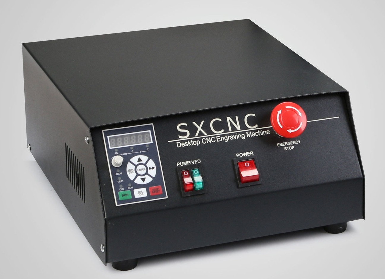

    Anyway here's the pics
    and the spindle, it's 2.2kw water cooled
    hope the image quality is good enough.

    Thanks John, i did reply to you but my reply never appeared, weird one that, pics as requested
    I can not see very much detail but I guess the control box and VFD will look like this

    Nothing lights up at all John, completely dead, that's why i'm hoping it's the main power switch on the box that has gone, because if it isn't then surely i would get something.
    Those pics look accurate you posted, and the e-stop is wired into the power switch on the front of the box, i have a switch coming tomorrow so i can test that theory.

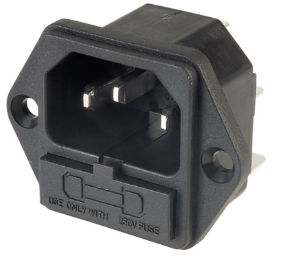

    Oh did you check if the kettle cord input plug on the chassis has a separate fuse? Some do.

    most machines have a fused IEC inlet like this
Name:	fused IEC inlet.jpg
    have you checked both fuses - in the plug & mains inlet ?
    with the power off you should be able to prove
    you have continuity between the L, N & E terminals on the back of the inlet and the 3 pin plug

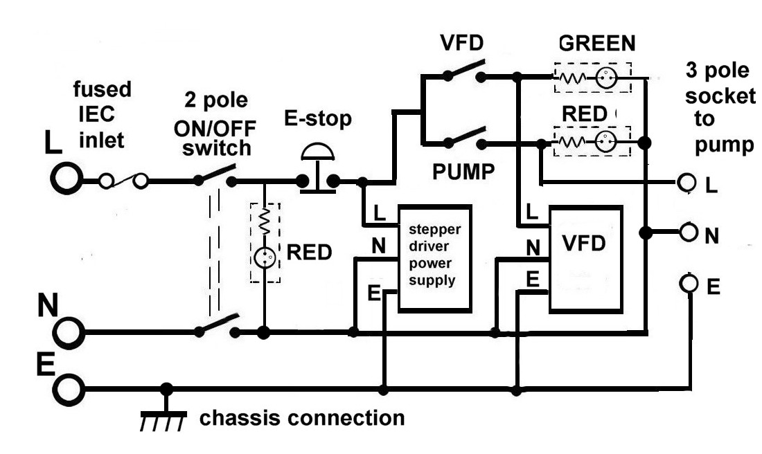

    as the E-stop switch is a single pole mains switch
    it should break the live supply from the IEC inlet -
    double check the switch is working and it does not switch the neutral as the Chinese have a habit of doing
    resistance checks on the double pole on off switch should prove if its working , or not
    John

    a possible wiring diagram
Name:	possible mains wiring.jpg
    note - the E-stop is shown as being after the main ON/OFF switch
    it could be before
