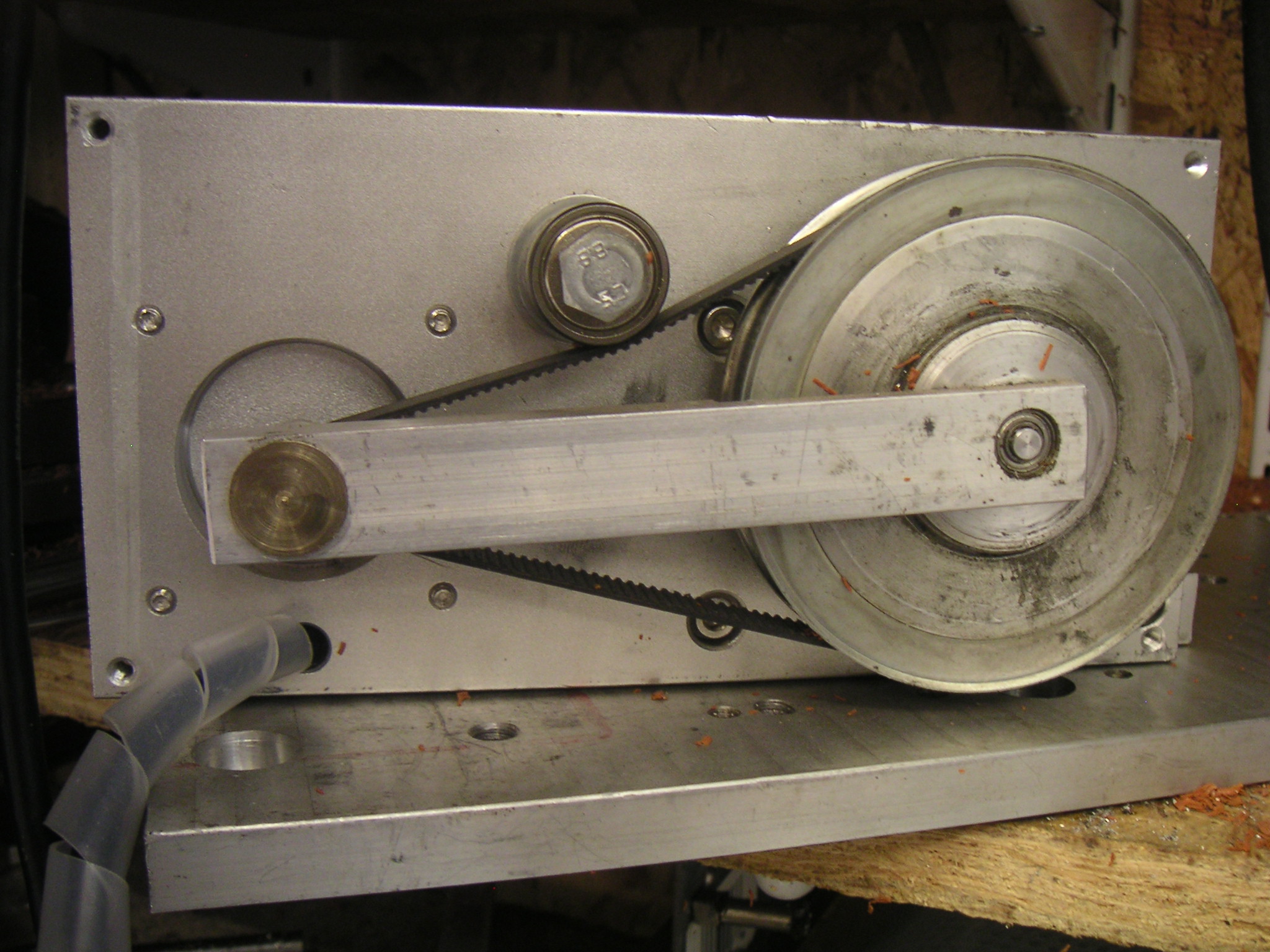

    magicniner, do you have any photos of the mods you have done to your 4th axis. I would like to see it. from your experience with these, do you thinkit would be ok for 4th axis wood milling as is, or a bit of modding
  10. #20
    John,
    I have an early pic of the "proof of concept" I knocked up with what I had lying around,
    I've subsequently re-worked the spacer support with alternate bearings to reinstate the through capacity of the spindle, it does what I need in brass, bronze, aluminium and steel.
    I don't think it would have been up to much without the tensioner to remove backlash, without the support the stepper shaft bends if you tension the belt,
    Regards,
    Nick
