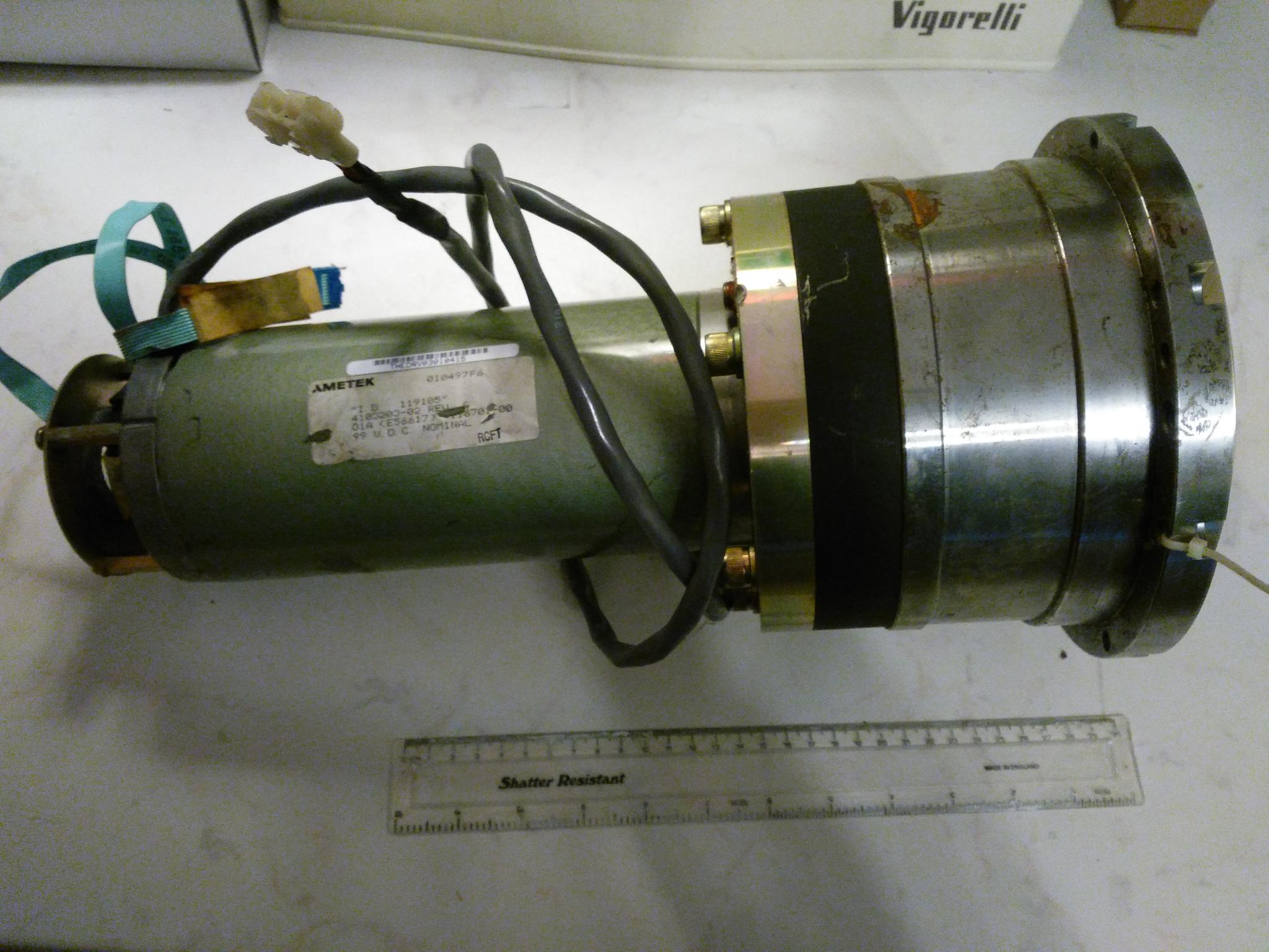

    I chose it for the decent through capacity which you don't get with harmonic drive versions, - Nick
    Picked up this harmonic drive some time ago for a 4th axis project, not yet got round tuit. 50 -1 with 25mm through and pre-loaded cross roller bearing on the output ring

    Quote Originally Posted by johnsattuk View Post
    Yeah,
    Harmonics with through capacity exist but are not fitted to the Chinese eBay 4th axis models under discussion here, nice thing to have in the parts drawer, please post some photos when you've completed a project with that,
    Regards,
    Nick.

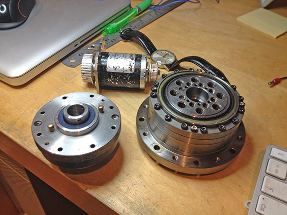

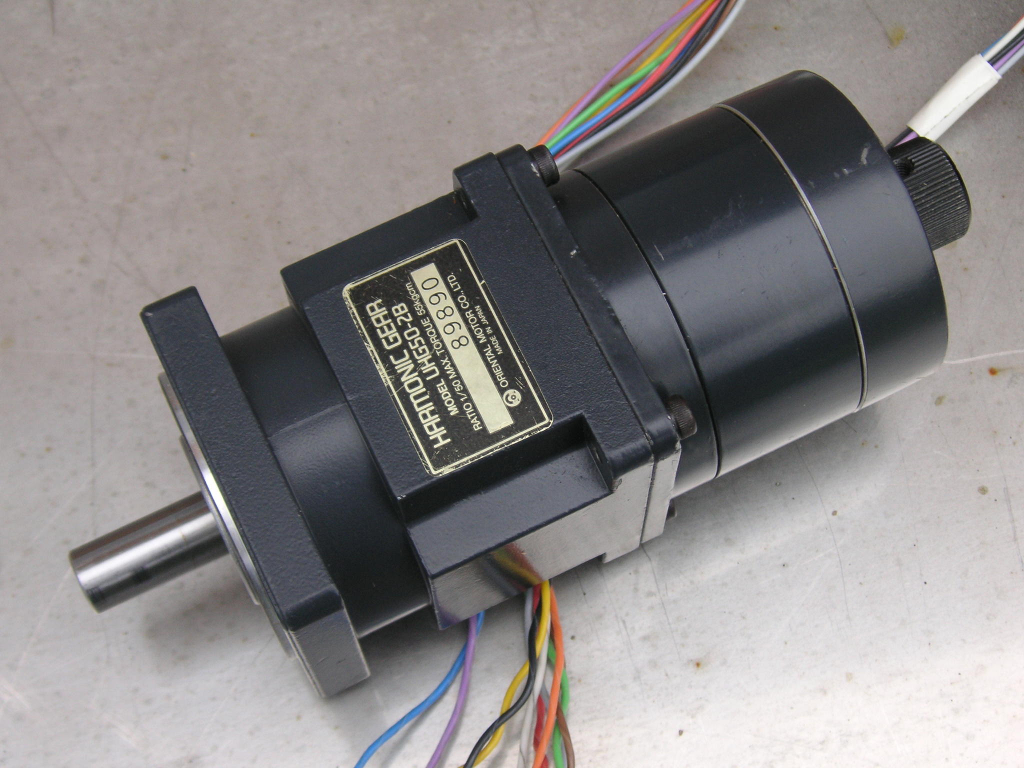

  4. #24
    I just found these things existed but I already feel a deep need to own one, was this an e-bay find?
    Yes, came across it after I had bought a 5phase stepper with 50-1 harmonic drive ( 25000 steps /rev ) which I was going to belt drive a head 2-1 so that I could incorporate a through hole. I also have some very low backlash 5 phase 10-1 (5000 steps/rev ) epicyclic drives that I thought I might use with perhaps ~4-1 belt drive.
ID:	22616Click image for larger version.

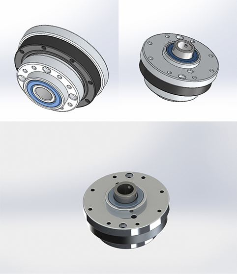

    Edward's Avatar
    Lives in London, United Kingdom. Last Activity: 3 Weeks Ago Has been a member for 9-10 years. Has a total post count of 114. Received thanks 3 times, giving thanks to others 0 times.
    I use lots of harmonic drives for my motion control rigs. I buy them second hand from ebay, but I have also bought a couple of modern brand new ones from the Harmonic Drive rep in the UK. They are very expensive new. HQ is in Germany but usually made in Japan, they own the monopoly, so the cheapo Chinese contraptions may not live up to expectations re. "zero" backlash, quality of bearings and so on. A brand new size 25 HD will usually cost a couple of thousand. I paid £1500 for each size 11 for a camera rig. They are beautifully made.
    The one above from Johnattuk is a proper one with very good angular bearings. These usually come from small robotic machines that are decommissioned, a lot from S Korea, and a bit old, but perfectly usable. Some work perfectly, some have seen better days and will work, although they may be a bit bumpy at certain speeds, which you wouldn't probably notice on cnc rigs, but you do notice in motion control where perfect smoothness throughout the range is paramount.
    The one you bought, Robin is too small, being size 11, with small bearings. You need at least a size 25, with size 14 being a bit marginal. Typical price for a good decent second hand size 25 with hollow shaft is around £450.
    Here is a render of one of mine showing both ends
    Edward

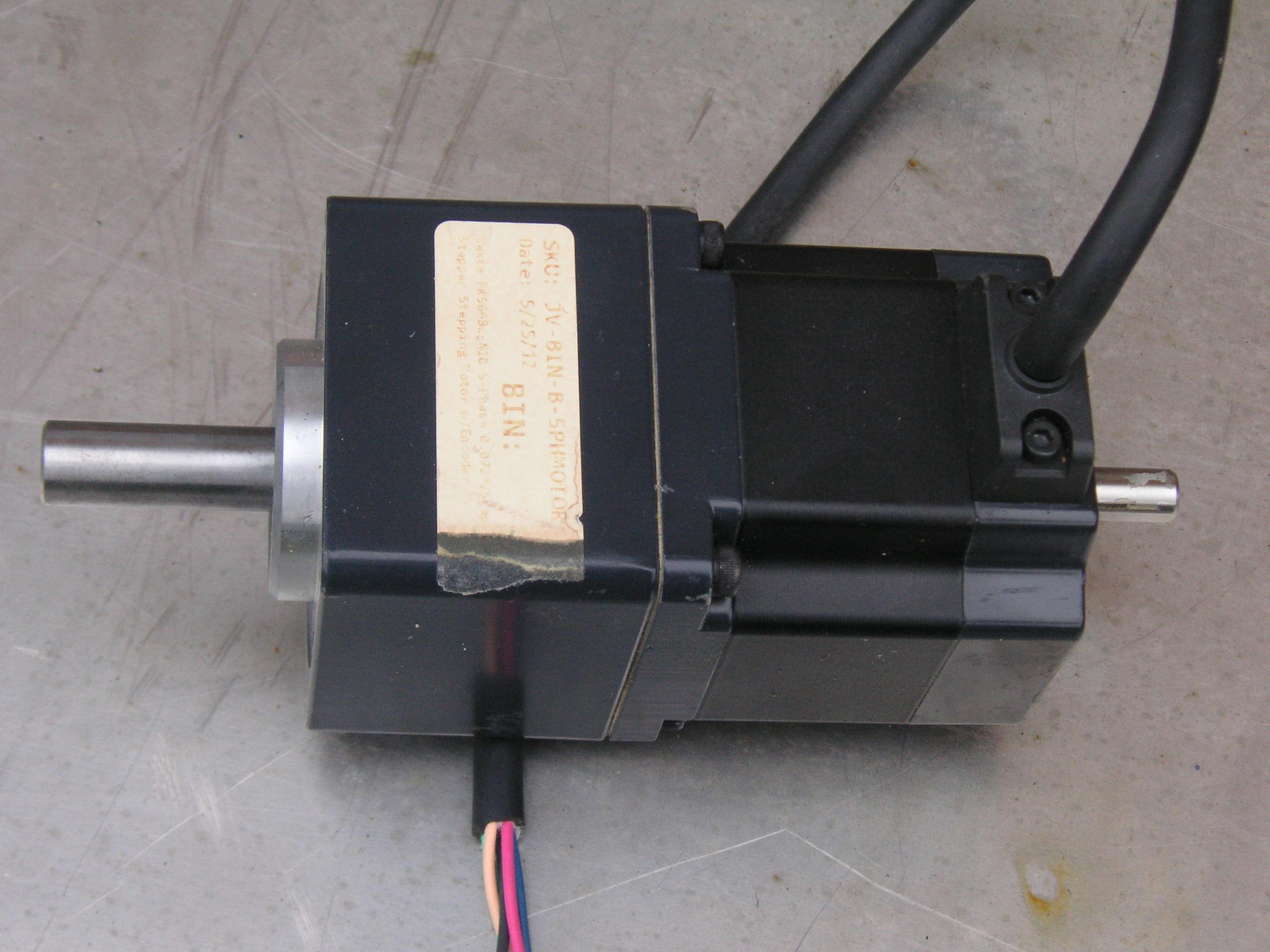

    And this will give you a perspective on sizes. Size 11, size 14 and size 25
