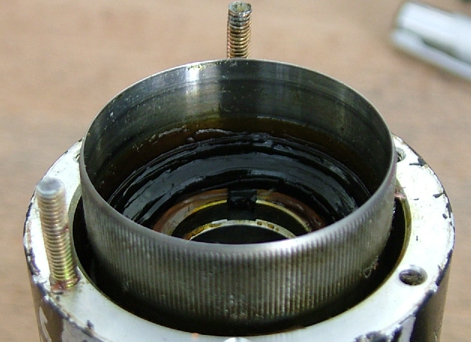

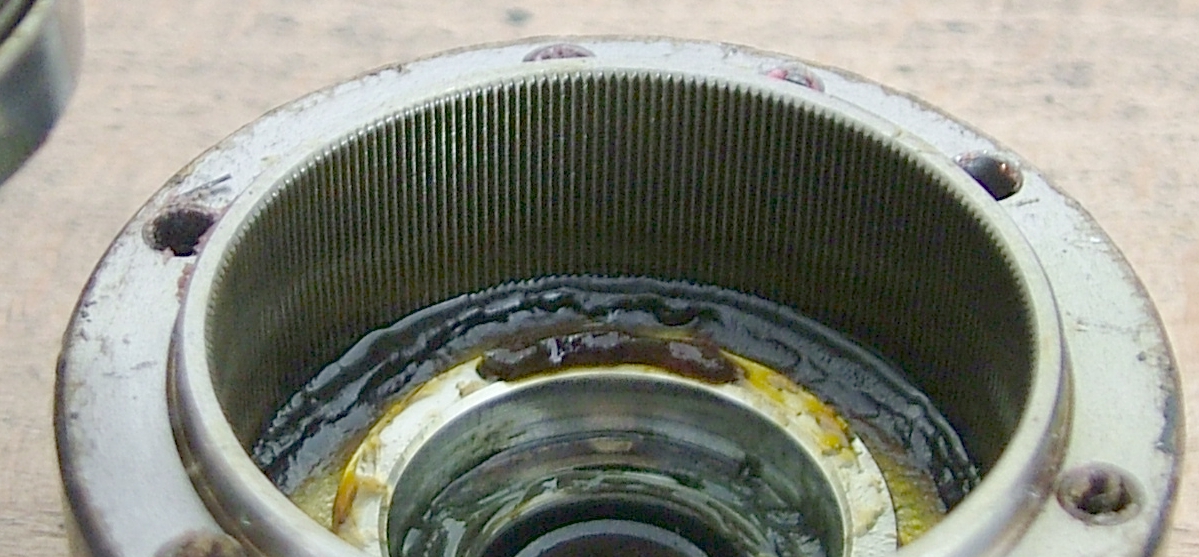

    I just took that harmonic drive apart, one screw head decided to snap off, one had to be drilled off.
    Much as expected, only remarkable thing is how fine the gear pitch is.
    These gears are about 28mm diameter...

  7. #37
    Not just the fine pitch but also the fact that they are flexible to mesh and I am not totally sure about the inner workings, but I think they have one more tooth than the gears they mesh with, or vice versa. Incredible concept and I guess very difficult to machine such precision.
    Edward
  8. #38
    Quote Originally Posted by Edward View Post
    Edward
    Need 2 teeth difference and because of the fine pitch, need a bit of care when reasemmbling as it is easy to be one tooth out, do not force.
  9. #39
    I have to get those headless screws out before I can reassemble.
    M2.5 and darned close to the bendy cog. I don't have anything suitable to grab them with.
    Any ideas?
  10. #40
    Have you tried two or three nuts locked together perhaps with heavy duty locktite retainer as well
