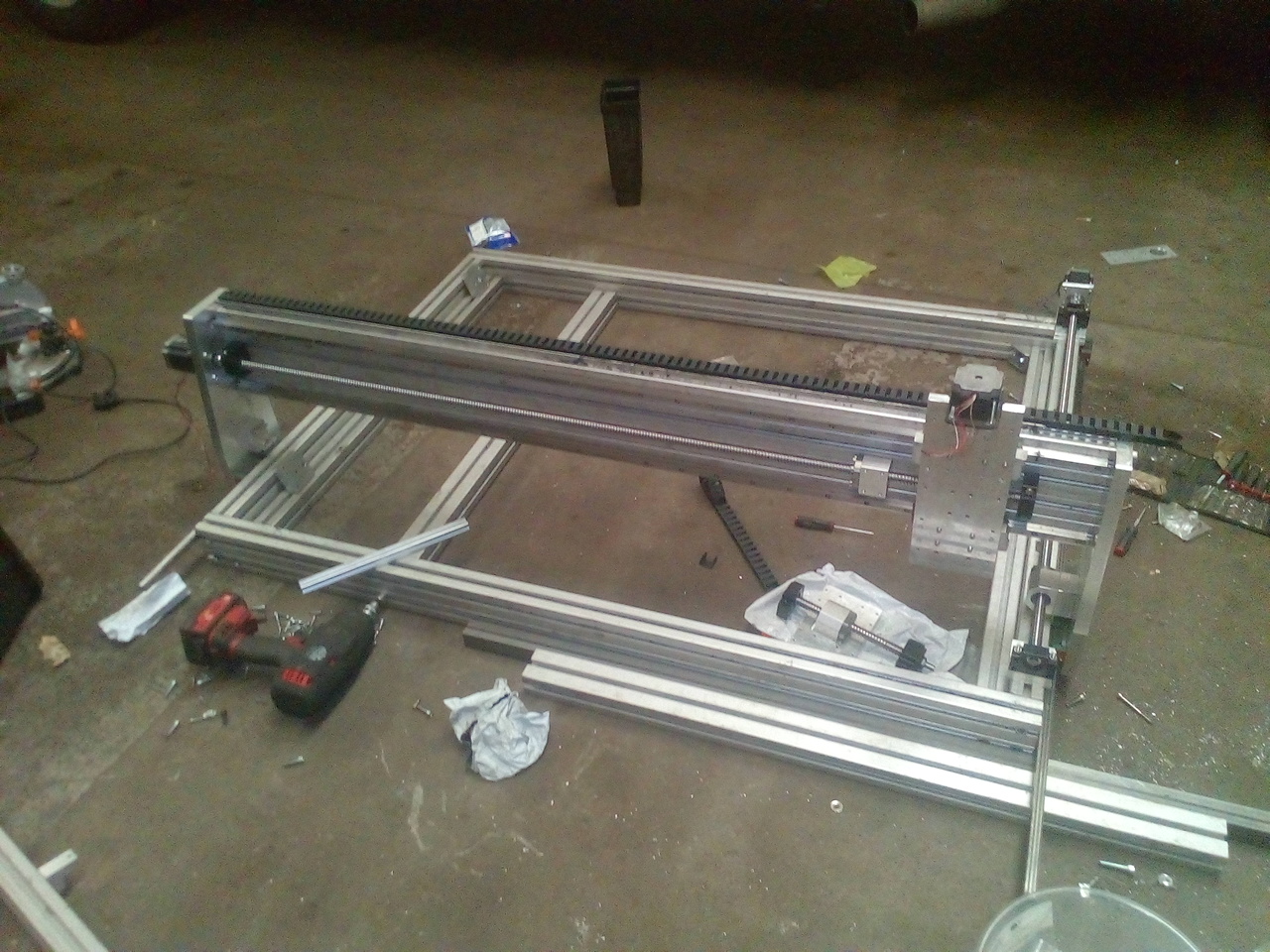

    See the little bit of 2020 extrusion on the side of my machine (I'm in the process of building her up at moment) that's what the frame of the Xcarve is made of, that and MDF.
    When people say build your own it's not because we're cocky it's because you really can get more bang for buck.
    My whole build cost less than an Xcarve but I worked hard to recover parts and buy 2nd hand it was a lot of effort. You could though build something very similar for around £2.5K using new bits and doing no manufacturing yourself (I outsourced everything) just assembly.
    I had absolutely no clue at all what I was doing when I got here 4 months ago this site has been my support and between the great members who know have forgot more than I will ever know lol and great thread content I've muddled through.
    It did help that I could CAD before I came here.
    I can point you in the right direction for getting stuff made if you fancy it.
    Also you wouldn't make the gantry the longest axis (Long story why I did it but I am going to change it)
    And in comparison to most peoples machines on here I built a toy.

    Well, sticking my neck out and risking being laughed out of the forum, if you think you would be happy with a toy, why not build one? I say this in all seriousness - my first router was built in a hurry because I had promised someone that I would make a presentation plaque and then needed to make a machine to make it.
    That machine was to the JGRO design. There's plenty of information and build logs available on the internet, and the design is available free. Basic structure comes from 8x4 sheets of MDF, one 3/4 and one 1/2 (or as I had to, metric equivalents). Leadscrews and guide rails are cheap and crude but easy to make. I bought motors, drivers, and a spindle that were a bit OTT for the job but I had the intention of carrying them forwards to a later machine (which, more or less, has happened).
    The machine was crap. MDF has all the structural integrity of cold-rolled cow dung; it moves with temperature change, humidity change, if there's an R in the month, and whenever it feels like it. The guide rails needed frequent adjustment and I ended up shimming the Z plate to try to keep the spindle vertical on a warping MDF panel. On the other hand, I used that machine for a whole range of jobs for about 3 years - the original plaque, now on display in a French village, it cut 25mm teak curved profiles for some bits for my boat (slowly, but it did the job) and a heap of intersecting ply panels for my son's architecture degree project. And a bunch of other things in between. It has been replaced with a steel-frame machine of greater capacity, speed, and accuracy, but that first machine cost me relatively little and taught me a lot.

    Actually I'd use a prop shaft repair guy I know (No lathe) but there's something to be said about the suck and see approach, was going to try and build my router without CAD but in the end I had to cad out about 80% of the router just to make sure everything fit.
    As for CAD all I can say is don't give up one day something clicks and it starts to make sense, there's an initial high learning curve but get over that curve and it gets a lot easier. It took me 3 attempts at learning before I started to get it.
    If you do build it yourself it's worth trying to source a local suppliers of aluminium extrusion so you can get it cut and drilled as you need it, I live next to KJN and it was invaluable being able to actually drive there to have the parts processed.
