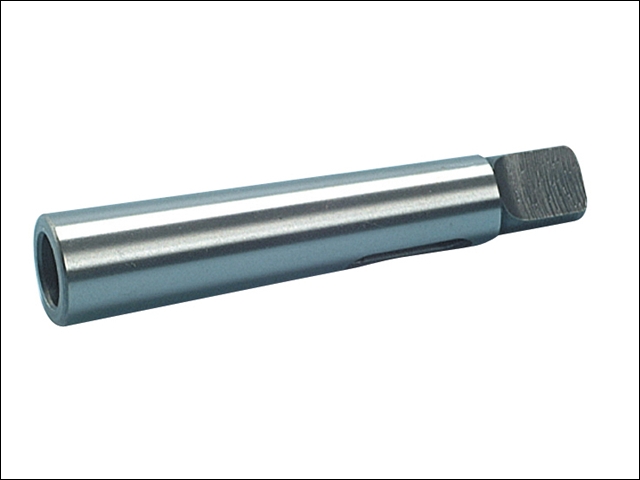

    Thank guys...re slapping the tailstock chuck into the headstock ....I'll have a bash later but I figured the taper specs being different means that thisisn't doable? (headstock is MT3 & tailstock is MT2). Now I'm clueless about these things so you're probably laughing right now!
    Ross...it's my intention to buy an independant 4 jaw....but nobody holds stock (due September) - actually, it may well be that *somebody* does hold stock, but compatibility seems to be a little bit unclear (I'd have thought retailers would have an inkling which lathes their chucks are compatible with - nope). Re making a DXF file....what a kind offer - I've now spent a fair bit of time learning CAD so reckon I can now knock up my own, but I don't have the dimensions ....I do have the mount of course, but it's a tricky shape to measuring accurately - I guess I can have a go then print it out onto paper until it's a good match!

    Hi you will need a MORSE TAPER SLEEVE they are readily avalible for around about £6.
    Ivan.

    Well, you live & learn ....I didn't even know these things existed! It certainly saves me dicking about trying to know up my own mounting/adapter plate!
    Many thanks to all.
