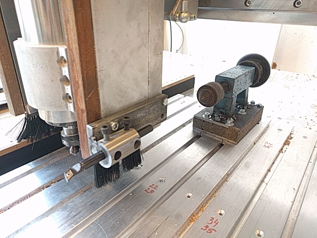

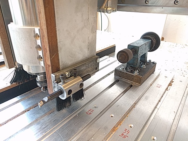

    Ik have a 4th axis that I can use as a lathe, it has a 12 nm closed loop stepper.
    With help from a friend I can now run it in both positioning mode and continuous mode.
    It has a 1:1 transmission and can run up to 1500 rpm, which scares me....:
    I use linuxcnc.
