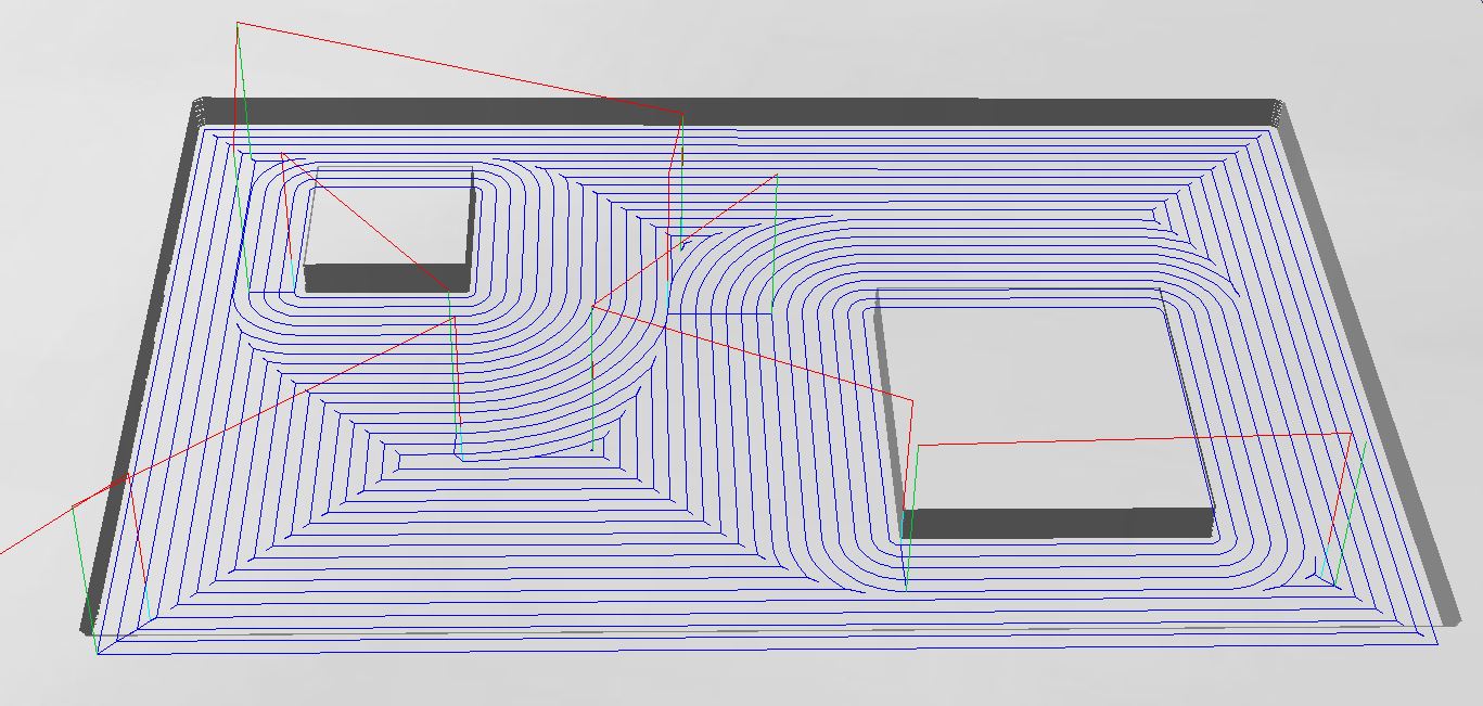

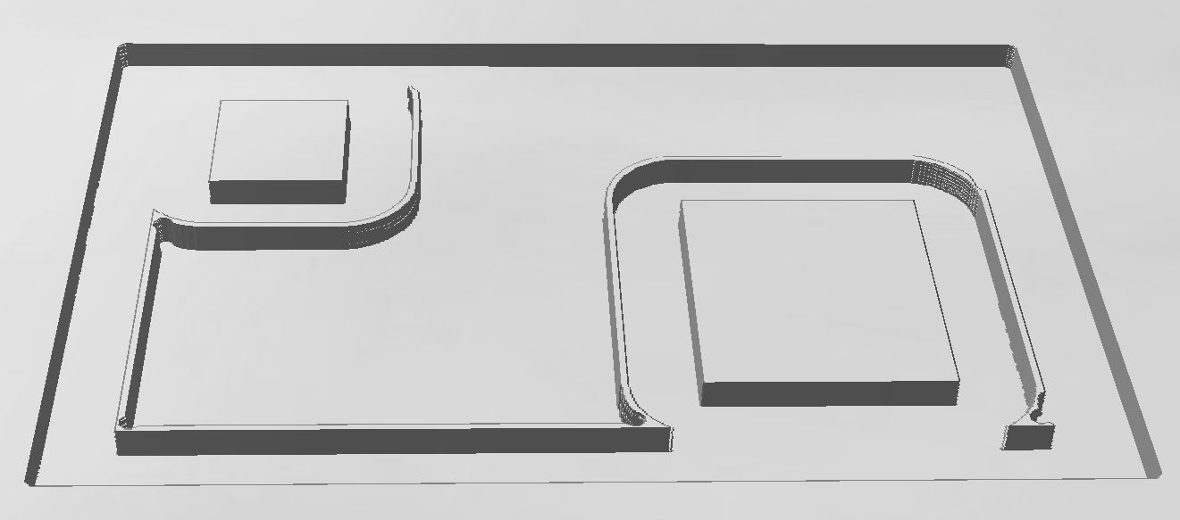

    Am I the only one to consider vectric pocketing strategies awful?
    I was playing around with Aspire and tried some pockets and here are the results:
    The tool enters 3/7 times through material for one pocket. No option to keep the tool down in the pocket.
    I have to choose between climb and conventional. But what if I don't care about the direction (or I'll have a finishing pass anyway) and I only want a fast and efficient toolpath?

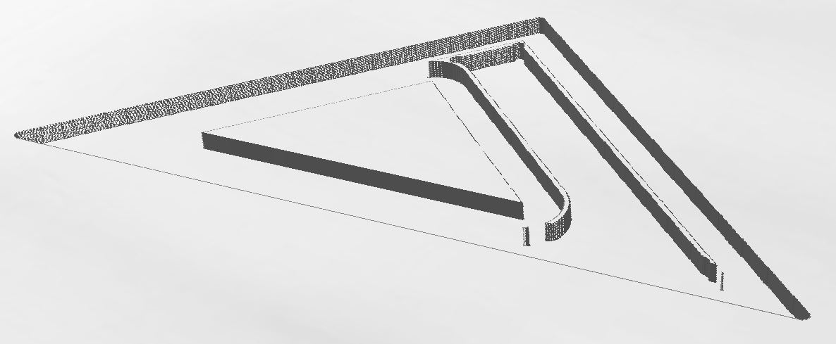

    What about this last part of the toolpath? I can imagine this thin edge being cut in acrylic... or the sound it makes if cut in foam.

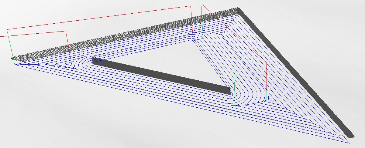

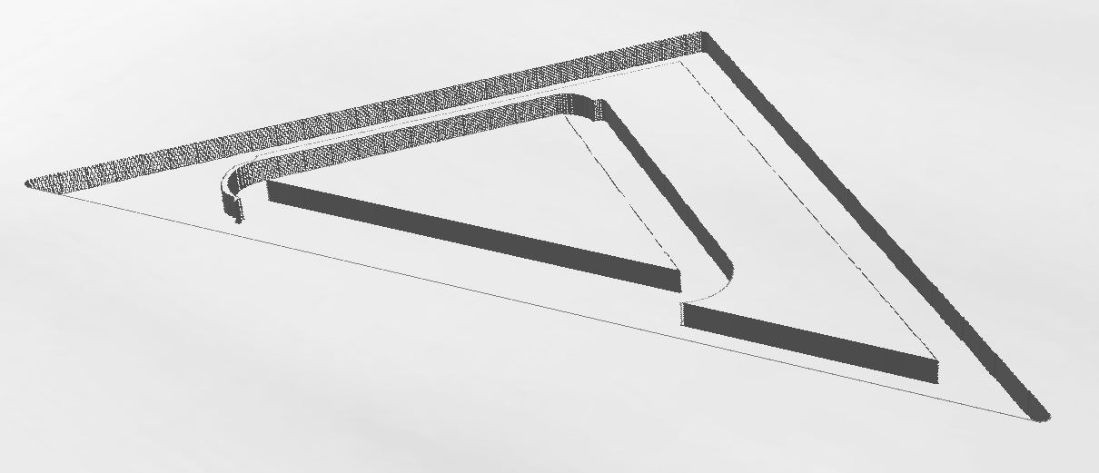

    The triangle has even more situations like this:
