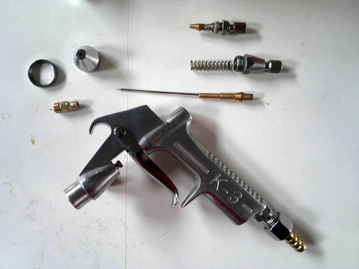

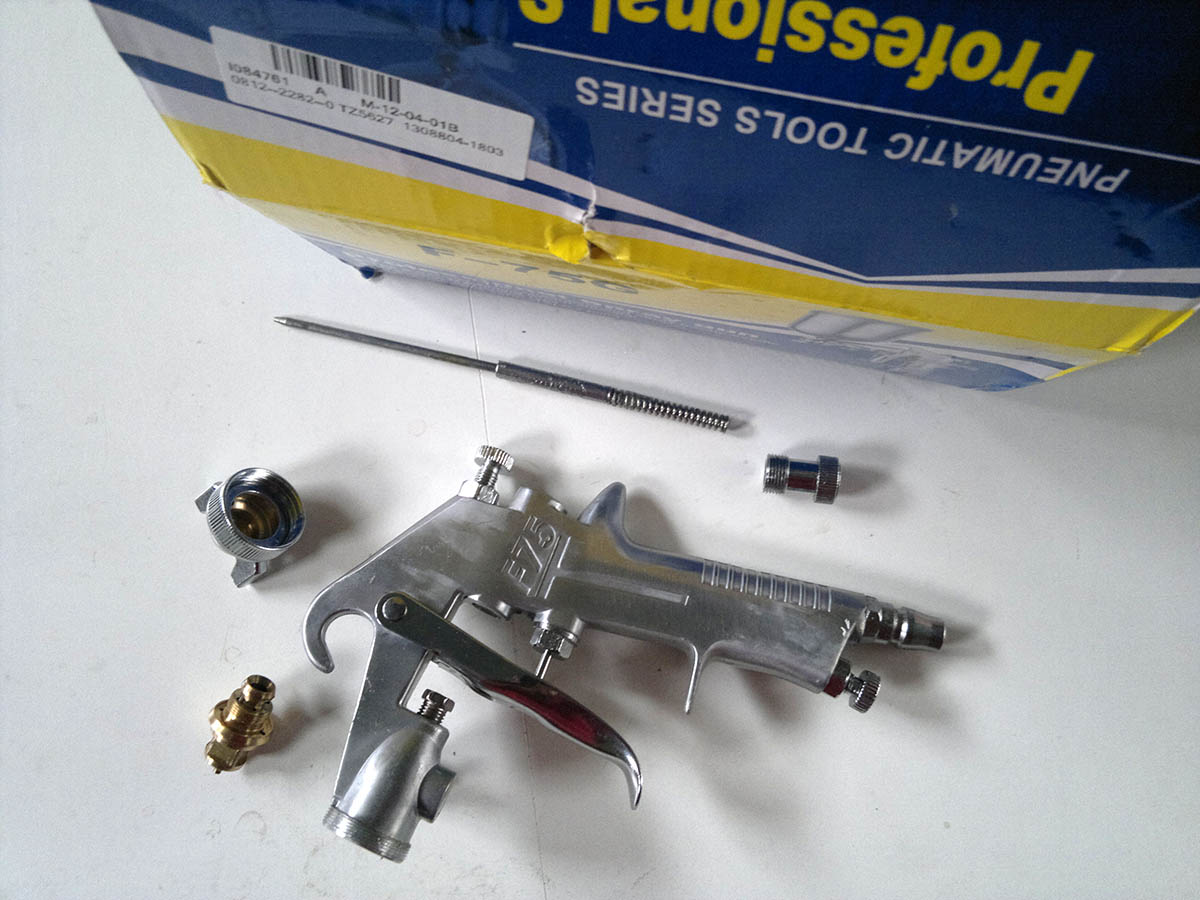

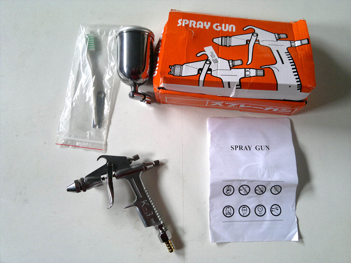

    After reading Boyan's post I order both models that he recommended.
    Claiming that a brass nozzle cannot be removed from an aluminium body spray gun is hilarious.
    Here is what I've got. I haven't used them yet but they look good manufactured for 10$ and 12$.

  8. #27
    I very much suspected that would be the case. I have ordered the little gun. You beat me to a similar post (pipped me at the post ).
    In one of the criticisms of the K3, it was stated that the upper screw adjuster was for 'paint volume', whereas it is for the air volume, adjusting the shape of the cone of paint. The F75 has a fan spray pattern.
    My K3 is on order.

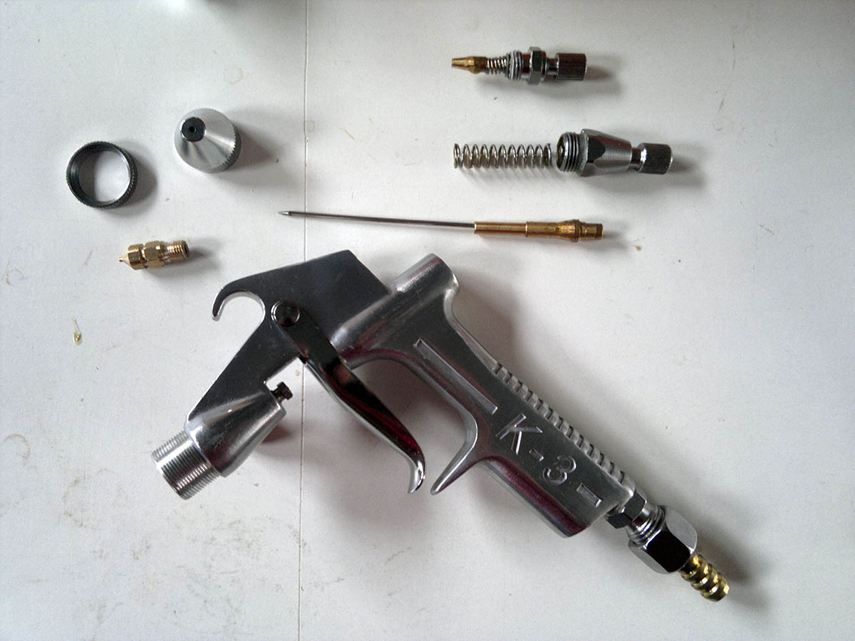

  11. #29
    I received my K3 spray gun this week. Of course I had to dismantle it to clean it !
    The gun requires the use of specialised equipment to disassemble, fortunately I had the kit needed, a 13mm six sided deep socket and ratchet handle.
  12. #30
    Blimey Rob where did you manage to find the equipment I've been looking for ages.
