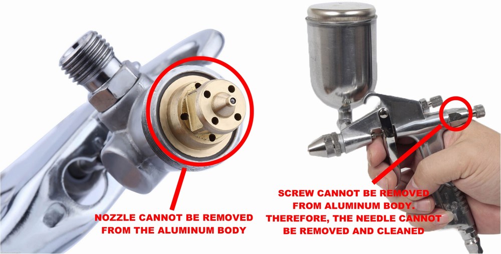

    On all of my 4 spray guns, you do not need to fully disassemble to take out the needle. You just fully unscrew the paint volume screw, remove the return spring and pull out the needle. This K3 looks as though it is the same, so why the problem?
    @ cropwell,
    This K3 Chinese copy is different. To explain in details (have a look into the attached picture):
    • The paint volume is regulated by the screw marked with the RED circle. This screw cannot be fully extracted, but no problem about it, since it does not effect cleaning process.
    • The screw marked with the the GREEN circle, only determines how far the trigger can be pulled. For example, you can preset a trigger pull to the middle, in order to achieve a specific paint cone and remain as is. This screw can be fully extracted, but there is no effect to anything else, since the trigger spring is secured by the screw marked into BLUE circle.
    • The part marked with the the BLUE circle, guides the needle and secures the trigger spring. Normaly (as happens on genuine Iwata model) this part should be possible to unscrew and release the spring AND the needle by gently pulling back. Unfortunatelly, this part, CANNOT be unscrew because it is part of the aluminum frame. The entire "screw" appearance of the part, is just decorative - not functioning! Therefore, the trigger spring and needle are traped there and cannot be extracted!
    I hope the above explanation, can clearly give a picture of the problem.

    Quote Originally Posted by Philipp View Post
    By the way, this is how the spray gun should be disassembled, but I guess that the manufacturers of this Chinese-made piece of crap (previously presented as "the purchase of the Century"), did not bother to think how this tool will be cleaned after use! Typical Chinese-made useless crap for once paint and throw to garbage.
    DON'T BUY CHEAP HVLPs - TOTAL WASTE OF MONEY

    I've got two cheap paint guns, and I've never had any reason to remove the needle, or even dismantle the nozzles, so I'm failing to see why you're making this out to be such a big problem. Flush the gun once you're finished with it, and it's not a problem.
    But I'm also wondering why you're only contribution to this forum has been to criticise these spray guns?
    Looks like I am just going to have to buy one, just for the hell of it. It would make sense for part #17 on the diagram to be left hand thread. Just a thought. These Chinese must be damned clever if they can assemble the needle assembly with part #17 in the body already.
    I am really curious to hear HOW you clean the tools after use.
    Just fush the guns? Really? Wow! I guess you never use real enamel paint, lacquer or epoxy (!!!) as first post claims. Well, maybe I am wrong, but I always disassemble my paint tools after use, clean them with proper thinner and assemble again to be ready for use. If this sounds "too much", I am sorry for respecting my tools "too much".
    ...maybe because these cheap Chinese-made tools are totaly useless? Do you think that I would criticise if I had great tools with low price? I say again - I forgot the most basic rule "if you pay peanuts, you buy monkeys" and I was stupid enough to think that purchasing cheap tools would also do the job. That is why!
    Well, I do not know if they are "damned clever to assemble the needle assembly with part in the body already", but I know that they are smart enough to fluid the market with cheap copies that do not work.

    I received my K3 spray gun this week. Of course I had to dismantle it to clean it !
    The gun requires the use of specialised equipment to disassemble, fortunately I had the kit needed, a 13mm six sided deep socket and ratchet handle.
