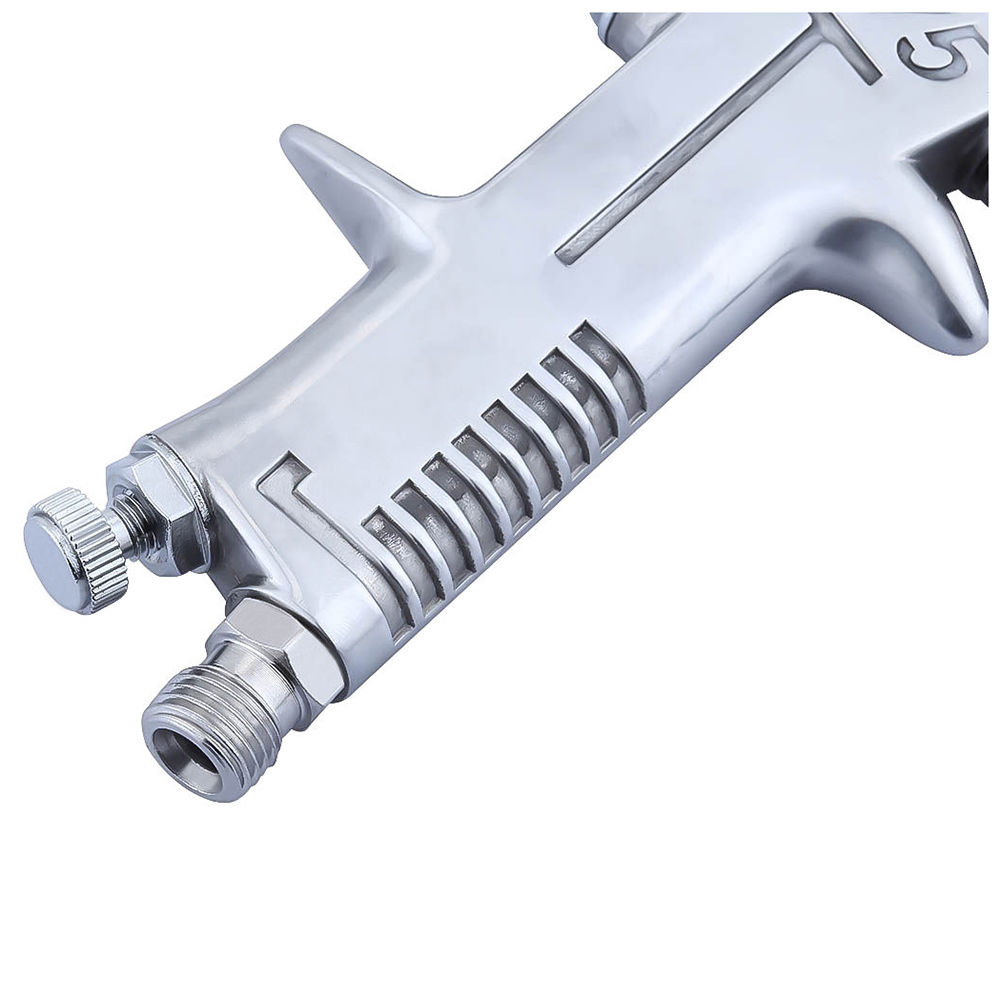

    1. F75 spray gun 1.5mm nozzle
    . Ridiculous 10 euro gun . Ebay number 142241555112
    This is my new gun from before a month as i hacked up my 400$$ 3M gun and did not want to spend 60euro on a nozzle. This is the best bang for a buck ever
    This spray gun sprays epoxy , polyurethane, water based acrylic, wood lacquer, wood tint. Thick or thin. Its up for a job like spraying a whole machine or even a car or a van. Though its not a big gun with a large deposit. I dont know what the chinese did and who copied, but this thing is a beast.

    So as a conclusion if you are to have only One Do All Spray gun, then the F75 1.5mm nozzle is the gun for you
    . And drink a beer with the money saved.
    Hope thats helpfull
    2023 update.
    Still have the guns and even painted a car with the bigger one. So i still recommend them.
    But now I would say they are really good only for small projects. It was pain in the a%% to paint big projects and especially thick polyurethanes that i had to dilute. Same with the epoxy base which has probably become DIYers best universal base as it sticks to anything, wood , plastics, bumpers, cars, etc. and is antirust.

    I totaly disagree with you. These two sprayguns are totaly watse of time and waste of money. To explain in details:
    After reading your enthusiastic review, I was stupid enough to forget my "if you pay peanuts, you buy monkeys" and decided to buy both of these Chinese-made spray guns from ebay. Like to hear my pesrsonal review? NONE of them works! Yes, they are good to spray air only or maybe fill cup with water and play a little, but these spray guns are actually useless! Reason? It is IMPOSSIBLE to disassemble them in order to clean them after paint spray.
    I DARE you to show us pictures with these cheap Chinese-made "F75" and "K3" spray guns fully disassembled, with needles and nozzles free and ready for clean. To make my point more interesting, I dare to ANYONE who already purchased these cheap HVLP copies, to post pictures presenting the areas shown into following pictures disassembled. Long strory short. Wanna waste money? Buy one of these. I was stupid enough to buy both, because I thought these were a "bargain" as I was fooled by the review. These cheap Chinese-made spray guns are crap.
    DO NOT BUY THESE CHINESE-MADE CHEAP CRAP

    Phill, are you high or sth? "I DARE YOU..." , "It is IMPOSSIBLE to disassemble...". Do you think me for a fool to recommend something in forum which i have not tested at least an year/in fact 3years/. Or you missed to read my other gun is 400euro paint gun, so i have a base to compare.
    If i have to explain you how to disassemble a screw, even if its stuck, then this is not the exact place me thinks. Its a CNC forum, not "Fix it at home". Anyway if some people were drinking Coca Cola instead of stronger liquids, they will know the answer, at least for steel screws.
    Firts of all you dont need to disasemble the back part to clean the needle. The needle is cleaned when you disassemble the nozzle. In fact you need to do that every couple of times of use, but not always, if you clean the gun using water or the respective thinner, right after use. Fill can with thinner, spray a bit and then with your finger stop air from nozzle. What happens then its bubles start inside the gun and go oput back from ca, that cleans pretty well the needle without dissassembly. Though i always dissassemble when using 2k paint.
    I use these guns daily without any problems or need for more expensive guns. Even painted my car with the bigger one. So why dont you take a step back, find a good brand tool like Stanley and unscrew it. With crappy tools there may be a problem if you push too much.

    As expected, your pics shows these cheap crap HVLPs without having the needles extracted. For example, the so called "K3" is a cheap copy of the Iwata's HVLP - I guess you already know that. According to instructions, the yellow marked screw need to be extracted in order to release the spring and slide the needle out and clear the way to easily clean the parts. None of this can happen and as far as I see in your picture, you also cannot remove the needle. So, I wonder how you clean the needle... or maybe you dont?
    Show the K3 FULLY disassembled! Can you? I bet not! Know why? Because these screws (that should be possible to be extracted) are manufactured by Chinese copy makers as one part fixed on aluminum body.
    Long story short? As said before, I was fooled by your enthousiastic review and believed that these cheap crap can do the job. Obviously, they cannot
  12. #10
    On all of my 4 spray guns, you do not need to fully disassemble to take out the needle. You just fully unscrew the paint volume screw, remove the return spring and pull out the needle. This K3 looks as though it is the same, so why the problem?
