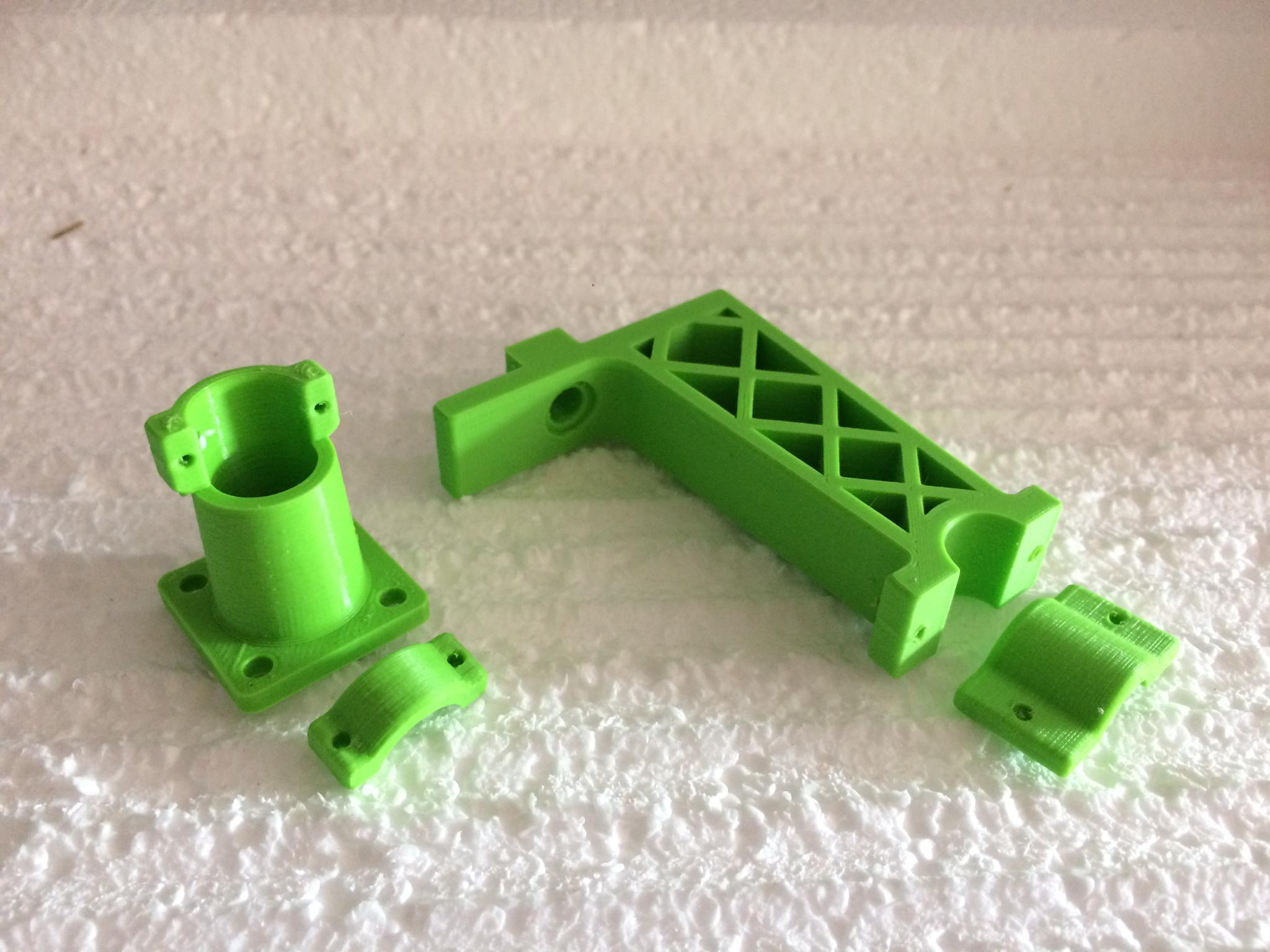

  2. #22
    I was looking at the picture on page 1, but now having seen your reply I've noticed the second image. Not keen - I'd be concerned that such thin-walled printed structure certainly will be porous and provide little to no mechanical relief. I'd agree with Clive's suggestion - get some saddle clips (or similar rigid mount) on the plate and tie-wrap the cable-form to these. It works on fast-jets, should be fine on a milling machine.
    I am far less concerned about the printed part failing now than the plug they come with. I can apply all the force I want with my hands to the spare I printed and could not any signs of movement or cracking between the print layers, its got a 3mm wall that tapers up and solid infill, the layers are extremely well fused together, I have been so impressed with the strength of parts that come of my prusa! The only thing that may destroy it would be a few hefty blows from a hammer. Now I have the printer I will also re do the cable support that was bolted to the main frame above the old plug. The wire will never move in the blue tubing ( it was a sod to get on) and that is permanently fixed to the printed part so should never move and have taken any chance of stress going onto the motor wires inside.
    The plug witch now is obvious was the failure point on the system and considering the plug was still locked down when I removed it after it failing shows it is a weak point and when you look at them the fitment and would assume the contact of the pins to be fairly poor and im not going to risk it again, In the past I have noticed the locking collar has managed to loosen its self over time although that wasn't the case when it blew and was the first thing I checked. remove the fault and remove the problem.
  3. #23
    Quote Originally Posted by charlieuk View Post
    3mm wall that tapers up and solid infill, the layers are extremely well fused together, I have been so impressed with the strength of parts that come of my prusa! .
    What material?
  4. #24
    Just pla I have done stacks of stuf with it now and have been so impressed. I have stronger filaments but not yet found the limits of pla easpesialy when it comes to small things like this I would be very sure the cable would give way before the printed part ever gets close. If you have that sort of load going on the cable you have something very wrong!

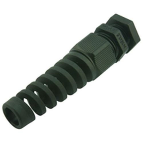

    On the strain relief grommet - can the cable move about independent of the spindle? If it can it really needs to give a gentle flexible support to the cable so it does not flex in the same place. Instead the cable should curve gradually to spread the stress out. Otherwise with repeated movement the cable itself may break where it exits the support bracket. You can either design a new grommet (mk3 !) with some gradual flex element as you move away from the spindle, or buy one of these:
    Top right end clamps either side of the spindle end plate
    Bottom left end is the spring element providing graduated support
    But if it exits the spindle and goes into an energy chain (which is also supported at the spindle end) then I think you are OK as you are as this will act as the spring flex element.
