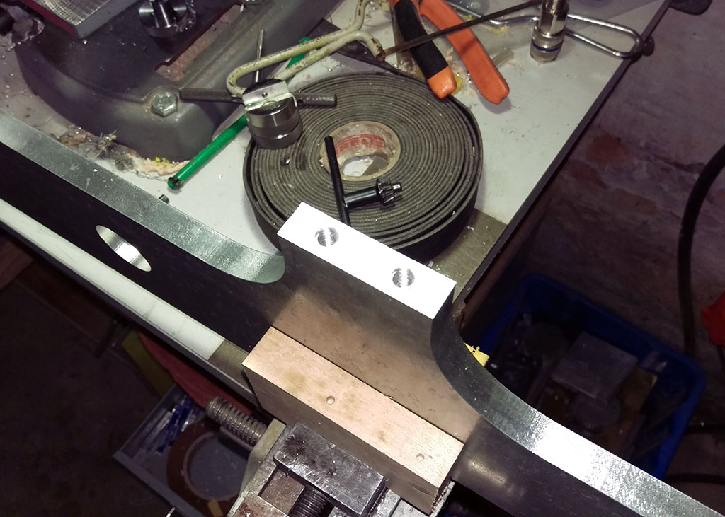

    Anyway. I made a couple more of the L brackets, these needed slotting for a bit of built in adjustment - nice to have those extra long 5mm end-mills to hand...

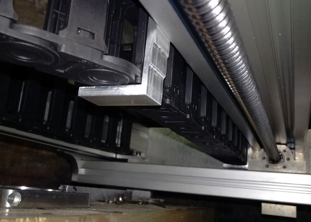

    Then it was on to the spacers. First I machined a channel for the L-bracket to sit in - the channel would also locate onto a fixture so that the reverse could be machined in order for the spacer to locate into the extrusion:
    It's looking like it should work okay:
ID:	22841 Click image for larger version.

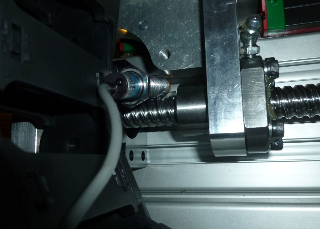

    Support bracket modified to take a sensor:
ID:	22846 Click image for larger version.
ID:	22848 Click image for larger version.
    It's not a pretty effort. In retrospect I didn't need to put the hole right at the edge, worrying about the sensor being able to pick up a target - I could have placed it further in-land (dodging the existing horizontal screw holes) and made the targets tall thin bars secured into the extrusion with countersunk machine screws to keep it low-profile. That would have been the more elegant solution, for sure. Ah well, it works and I can always make a new one later on, though I probably won't..!

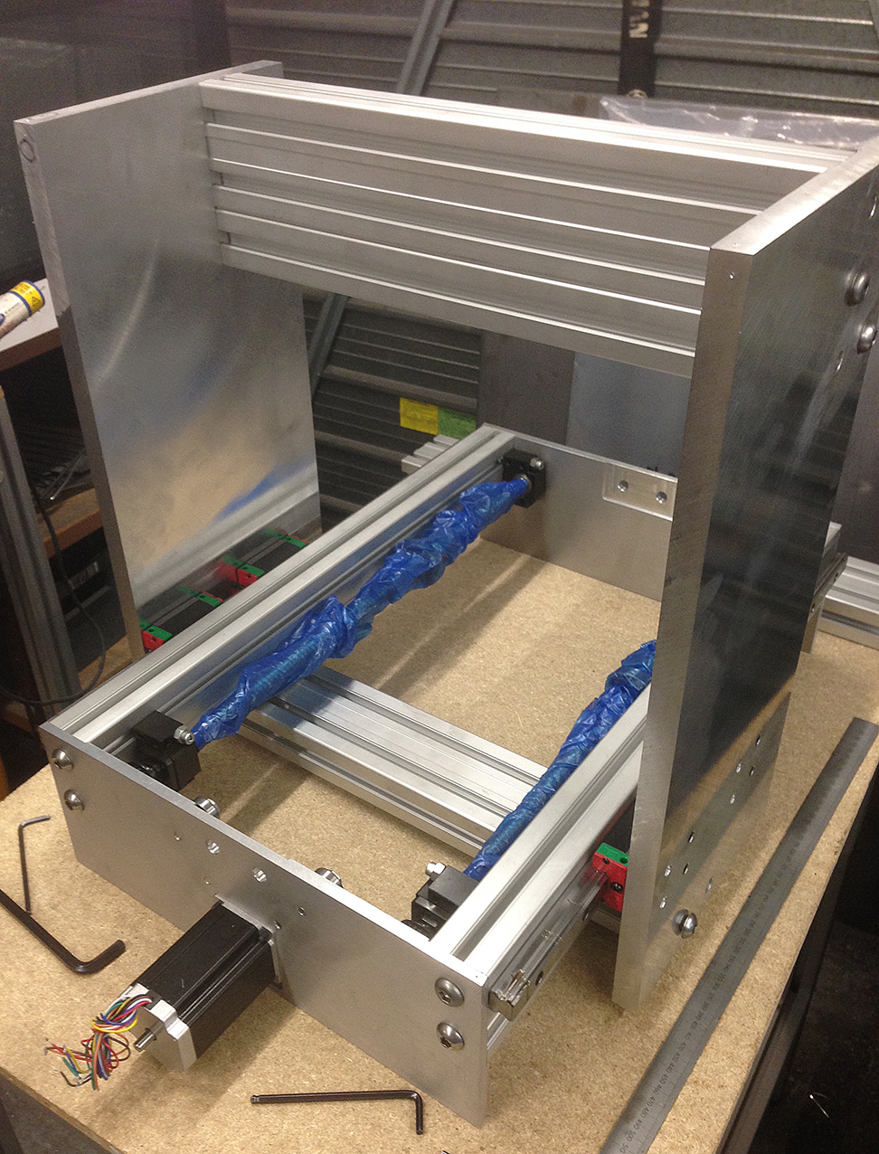

    Thomas, I don't, I'm afraid - I have various bits and pieces which I've wanted to compile, but they're spread over various drives etc. The mini-mill, despite its shortcomings continues to serve me well - if it helps I'll attach a .pdf of the main frame structure. After that it was just a case of buying 4x20mm ecocast plates and getting them drilled at a local shop (not sized, just drilled) - to accept rails and bearing housings etc. The idea was then to use shims to square up the plates as best as I could relative to each other - kinda worked - well, it's a bit out, but at the sizes I work at it's not that big a deal - where I do need better squareness I skew my drawings by a small amount (what I've been able to measure) before making the toolpaths - yep, it's an imperfect workaround but gets me close enough..!
    The idea behind the mill build was to make it as easy as possible to put together, while at the same time being able to have a closer look at the hardware (and learn a bit more about how these things are put together..) I wouldn't copy what I've done - it certainly works and gets me some excellent results, but having learnt from it I'd do a few things a lot differently..!

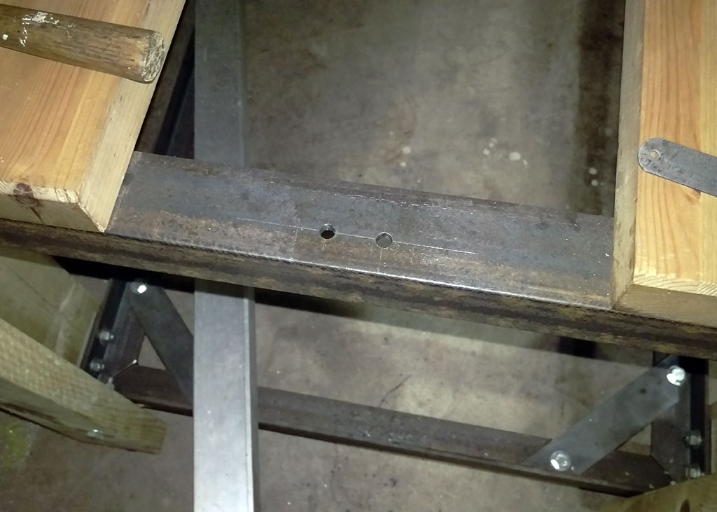

    Another thing I thought I'd have a look at is creating a mechanical union between the router and the bench that it's sat on - I was going to screw some strategically placed blocks down to prevent it from walking but thought that I might as well add some mass to the unit as a whole and leverage the weight of the bench (and all the stuff that'll eventually get stored down below) to help hold the router down.
    I took the feet off and drilled/tapped a couple of M8 holes in the middle 'foot' - too late to use the corner 'feet' - lack of space notwithstanding, I'm not strong enough to lift the router off by myself - I could have attempted a bit of a balancing act, but laying out on the steel L-section would have been, at best, a very awkward affair...

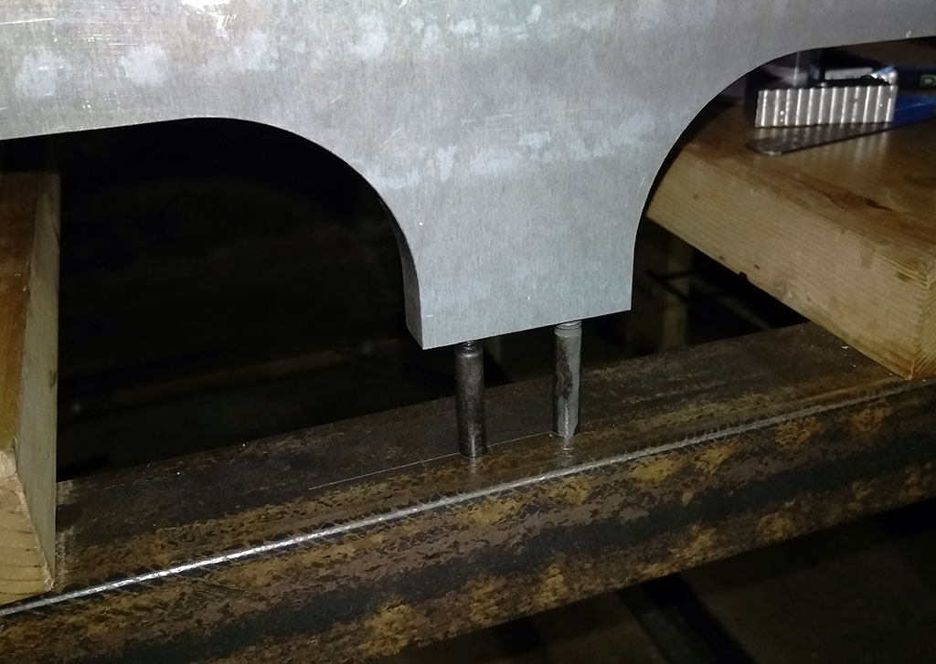

    Next I drilled a couple of 8.1mm clearance holes for the bolts:

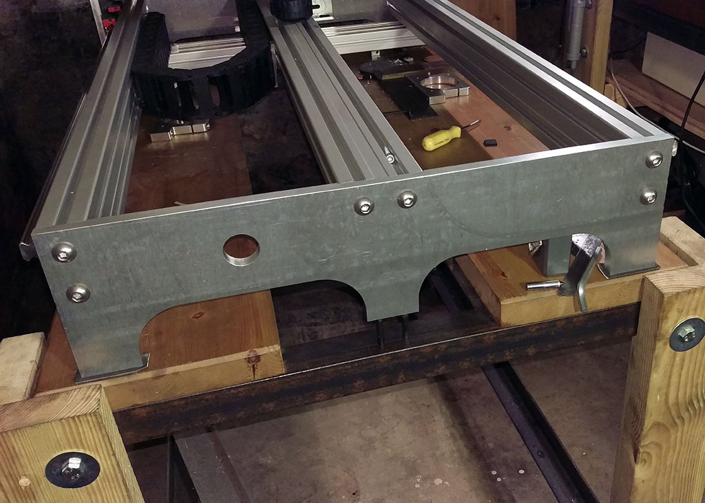

    And then bolted the router bed down to the bench sub-frame.
ID:	22874 Click image for larger version.
    There will eventually be a third plank running up the middle of the bench - I'm leaving it out for now so as to be able to get access to the underside when needed.
