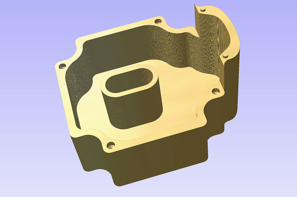

    It's coming together. I've been busy making some of the smaller bits and pieces on my mill:
ID:	22728 Click image for larger version.
    And here's a vid showing some of the cutting that went in to these smaller parts. I've taken to using a drilling strategy to cut out large chunks out of the stock so as to avoid deep slotting. I can deep slot, but I'm not a fan - it can get a bit loud for a confined space and it means using a fair bit of WD40 which I'd sooner avoid. The spindle bracket was cut dry, ok - the odd squirt of WD during the drilling routine, but the profiles themselves were cut using only air.
    I'll hopefully darken Clive's doorstep again (if he hasn't tired of me by then) to cut the mounting holes for the spindle bracket - it's a bit too tall for my mill when stood on end.
