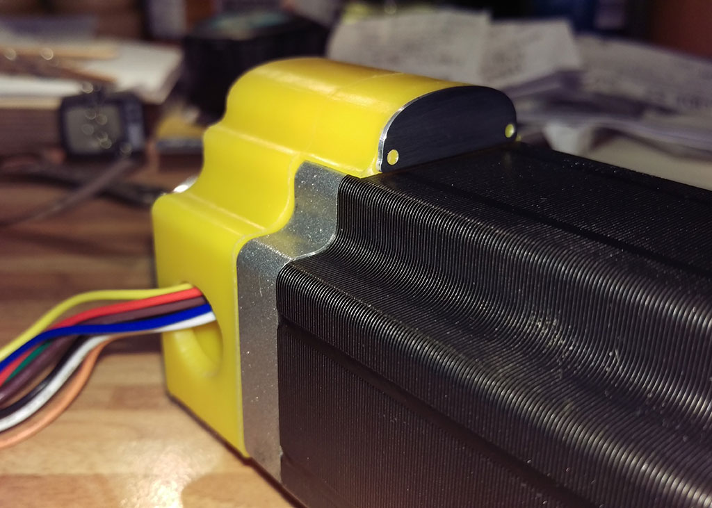

    I've spent a bit of time this week making some NEMA23 motor covers. See that large chunk of plastic..? I spotted it in a scrap bin outside an industrial unit coming out of band practice last Sunday. I didn't just want to take it, so I drove back in the morning and asked if I could have it - the answer was 'yep' and I've been chuffed about it ever since - 750x220x50mm - got to be the skip find of the month, huh? Not sure what it is, but it cuts very well... I've got a feeling that it might be worth trying to cut this conventional as opposed to climb. The 6mm cutter's quite aggressive and the material is surprisingly hard, so I've kept the DOC/step-over quite conservative. Here's a vid:
    The cut's not as clean as I'm sure it could be, but the burr knocks off very easily with a bit of wire wool/fine sand-paper. I tried using a t-slot cutter for the under-cut (where the wires come out of the motor body) but even with the spindle at 3krpm it was still way too hot - I'll use aluminium caps to seal 'em up - an extra step, but it'll work - here's a bit of 3D to show you what I mean:
    Still want to try making these covers out of some walnut I've got lying about (much to Clive's amusement) - no reason why a decent hardwood shouldn't work, eh.?!

    Re the T-slot cutter for the sake of others I have done plenty of these but the cutter needs to be spun at 600-1000 RPM.
    Going to be a very nice machine, Keep up the good work and vids.
    Those covers for your motors are going to add mojo! Nice touch!!!

    Covers pretty much finished now - just waiting for a bunch of 16mm cable glands to arrive (in black) and then I can pair up and solder what's coming out of the motors onto lengths of CY cable. (Of course, the walnut covers will be getting brass cable glands...) A couple more pics:

    ...and a vid showing the machining off of the extra bit of plastic that was used to clamp to whilst cutting the main body along with a quick bit at the end showing the cutting out of the alu caps:

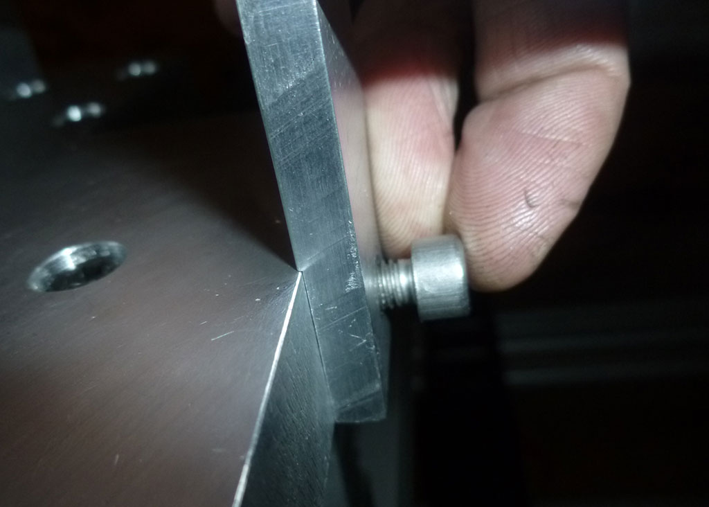

    Started on the Y-Axis E-chain earlier today. I've got a length of chunky alu L-section that I rescued from my Dad's shed a while back and it's pretty much the ideal size for this job - well, maybe a little on the heavier-duty side...
    First job was to drill and tap a hole on one of the plates that makes up the side to side moving part of the Z-Axis. Rather than take the whole thing apart, I used the plate edge tapping kit I 'designed' and had made by Dominic when I first joined the forum. Worked nicely...

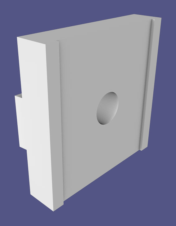

    Next I need to make a 7mm spacer that will sit between the L bracket and the extrusion at the other end of the axis. Should look something like this:
    Again, recesses and proud bits are to prevent it (and the L-section) from rotating once bolted on.
    There'll be another bit of L-section positioned somewhere in the middle to prevent the chain from sagging...
