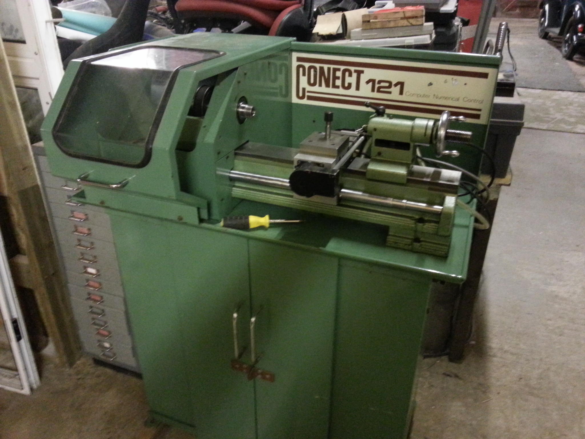

    Ive just picked up an old (ish) Conect 121 cnc lathe. Looks to be in good condition and No excessive wear.

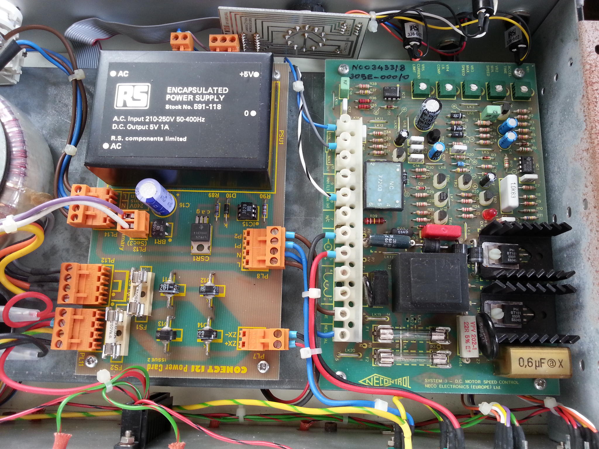

    I plan to replace the stepper drives as others have done but Id like to use the original spindle drive and stepper drive to test it and get it up and running. I cant seem to find much information so if any one has a wiring diagram or knows the points to connect Id be grateful.

    From what I remember, you can trace the step/dir control pins back to the original controller chip.
    However, they are 80s technology, and I don't think it would be worth the hassle. Even a couple of the TB6600 drives should give an improvement in performance, and they can be had for less than £10 each. Combine those with a cheap BOB, and you've got all the major components covered.
    The only thing is you'd need to ensure the 0-10V for the spindle speed is isolated, or upgrade the spindle drive to something that doesn't need an isolated speed control.
    So if if i power the BOB from the 5v of the conect board will that not work?
    Yes I will replace the stepper drivers but I would like to use the DC spindle motor?

    As long as you can get the part number of the stepper chips, and find a datasheet, just trace the PCB tracks. Or there will only be 2 tracks that go to dedicated pins on the controller chip from each stepper chip, which leaves only two options as to what is the step and dir.
    You really need to find out what the spindle drive is. Mine was a SCR style drive (very common for DC motors), which means the speed control terminals are at near mains voltage. Connect them to anything other than an isolated 0-10V, and something will be releasing magic smoke.
    Dam, I have no idea what drive it is. The machine is from 1986 and has the Lander control board. it does look like the input is 240v and there is a transformer before the motor.

    Post up some photos.
    It won't be a transformer, it'll be a choke.
    I know mine came with a Cheetah drive, but I had to replace it with a KBIC, as the Cheetah was blowing fuses.

    Thanks, you pointed me in the right direction. bit of googling and it is an SCR drive and its a Neco one. Ive found the 3 control wires but not sure if the enable will be ground, +5v or +10v
    Will I damage it trying different combinations?
    Ultimately I think i Will have to replace the motor and drive but it would be good to get it running to make sure the lathe can manage what I want to do with it.

    Tracing back the spindle control side of the main controller it seems to be fed from a dedicated 20v Dc circuit.
