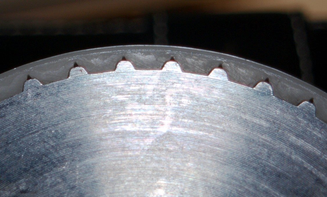

    I have just got a sample AT5 pulley & belt from Beltingonline.com, Supplier of power transmission and conveying products
    It seems ok, but a lot of people here seem to use HTD pulleys and belts so i might order a sample one of these to have a look at too,
    Photo of AT5 belt on 44 tooth pulley

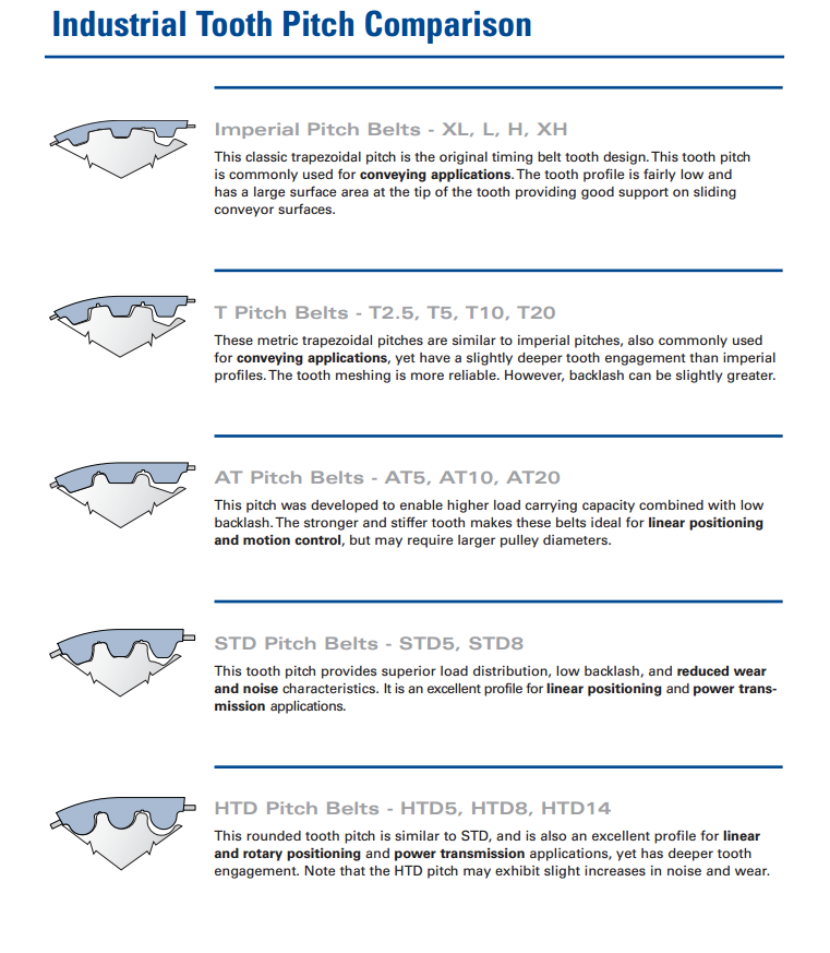

    Sometimes reading the manufacturers general guide lines on the first page is better than reading 100 posts on forums. Its all there, the good and the bad in bold letters:
    Are you too far to go back now? Belt and pulleys are so cheap. I would not be worried if i were you. As Jonathan confirmed, backslash is eliminated if tightened properly. However i would be worried if some of the pulleys you intend to use are the smallest for the belt size. Up to 18-20 tooth i mean. Implementing smaller than 18 tooth pulley is a call for problems with any belt.
