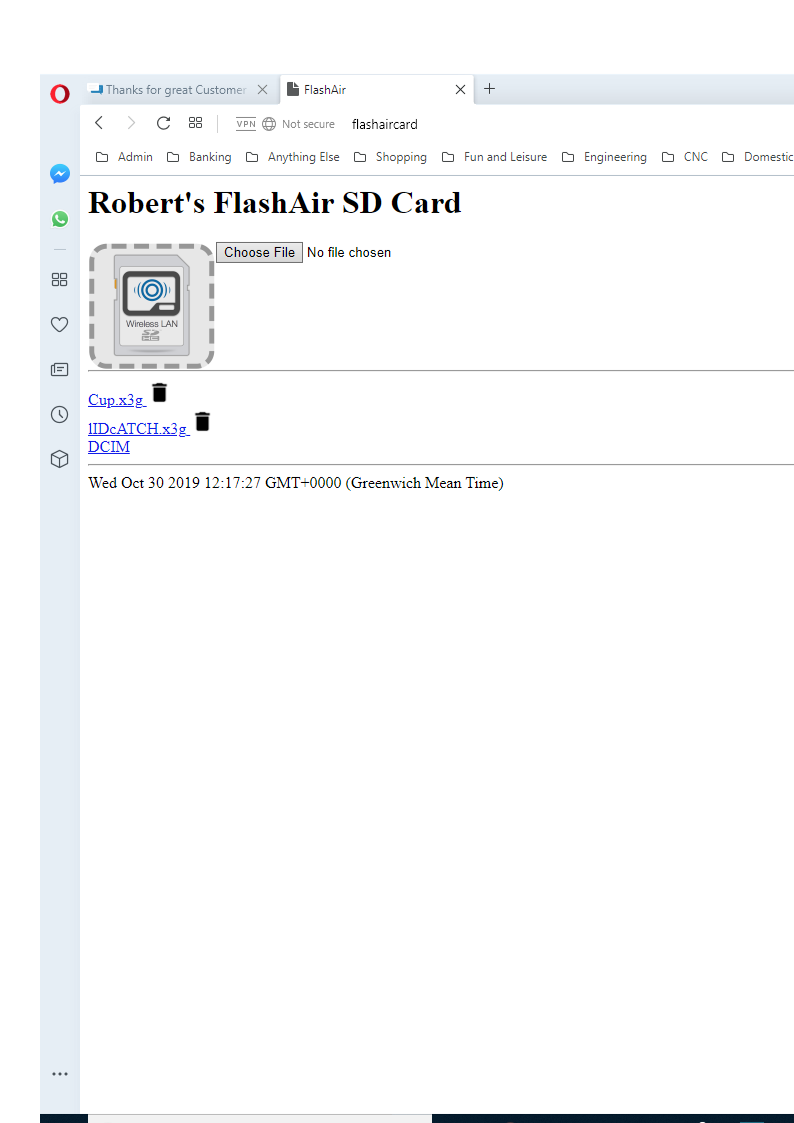

    One thing that I have done is install a WiFi SD card, so I can log onto it and upload and delete files without messing about taking the card out. The card is a Toshiba Flashair and I had to modify files on the card to get it to work the way I want it. Now it works well, but the range of the card is quite limited, so I have to have it near (within 6ft) to get a reliable link.

    Hi Rob,
    We had a nightmare time with our Creality CR-10S when the SD card slot started playing up and not recognizing the card. We've instead swapped to using OctoPrint which is a raspberry-pi based controller for the printer (so plugs in via USB). One of the biggest benefits is it runs a webserver as the control interface, so we can slice a model, open a web browser, then drag and drop the G-Code file into the printer, and off it goes. We also get a graph of the temperatures, and a live webcam feed. Can't recommend it highly enough, incase you haven't looked at it before!

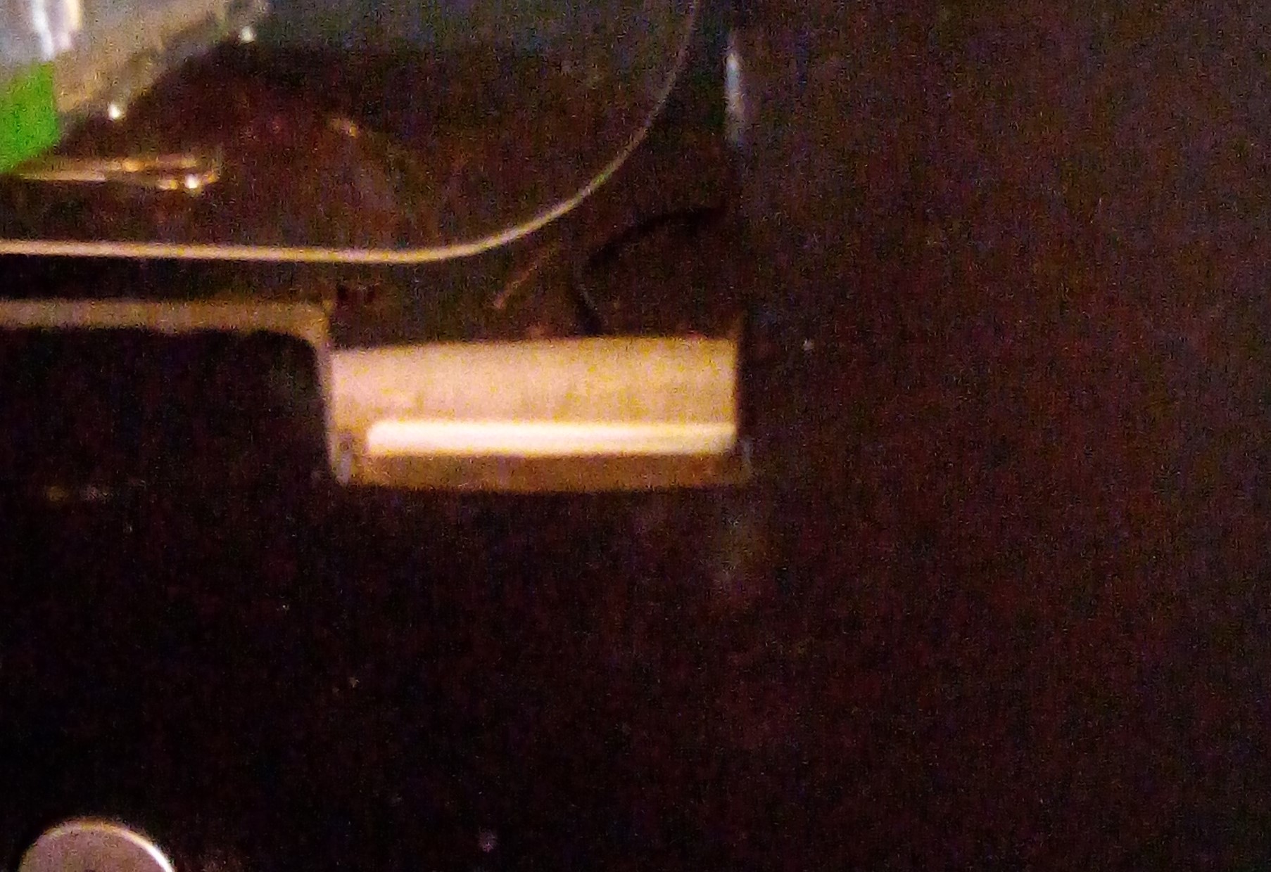

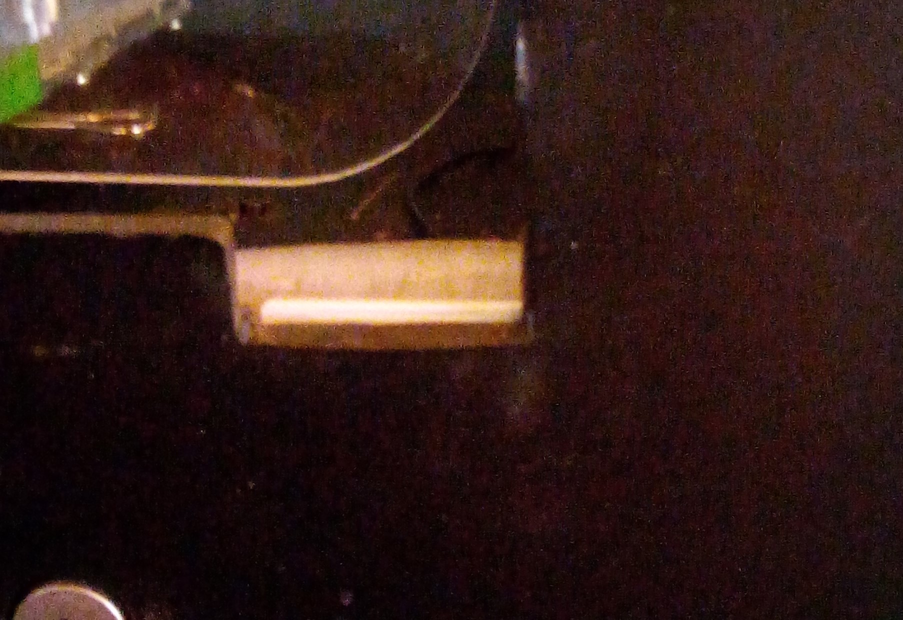

    I know damn well what you mean about an SD card playing up. The problem with the D4S is that the card slot is stupidly placed so I tried several things. You also have to appreciate that there is a gap behind the card slot, so the card can easily fall into the machine and get lost in the electronics compartment.
    First attempted solution :- Fill the gap with a printed fillet. - Result - fewer lost cards, but more awkward to insert and take out card.
    Second attempted solution :- SD card extender, good idea but failed very quickly, resulting in card misreads.
    Third attempted solution:- Cut away the machine enclosure to get access to the card.Click image for larger version.
ID:	26672 (sorry about poor quality photo)
    Fourth (successful) solution:- WiFi Card. It works well enough to stick with it and no major change to machine.
