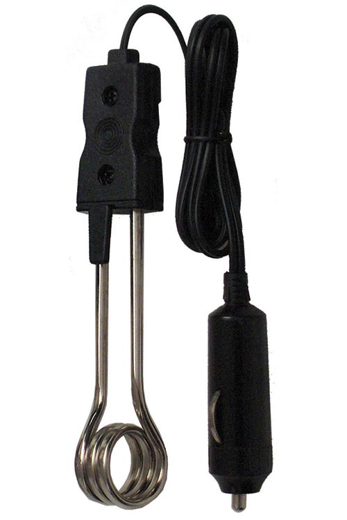

    Just tried one of these in a 500ml glass jar and it worked pretty well.
    Took a good 10-15 mins to get up to temperature so would expect a lot longer with 5l tubs.
    Runs at 12v and draws pretty much bang on 10A so 120watts.
    Going to test wit 5L now!
    Lives in East Lothian, United Kingdom. Last Activity: 17 Hours Ago Forum Superstar, has done so much to help others, they deserve a medal. Has a total post count of 2,992. Received thanks 376 times, giving thanks to others 9 times.
    The specific heat capacity of water is 4.184 joules/gram/deg, so to raise 5 litres of water from 20 to 80 degC, would take 1255200 joules (4.184 * 5000 * (80-20)), or 0.349 KWh. Now if you've only got 120W, that means it would take 2.91 hours (0.349 / 0.12) assuming you have zero heat loss.
    However, unless you've got insulated containers, I'd doubt you'd ever get to 80degC.
    Pretty much spot on. Tried it for the hell of it and got the top third of the water to 50c/
    The rest stayed at 16c (workshop room temp). That was nearly 1 hour.
    I am thinking 1000w min really as I don't want to wait too long for it and once one puts the part into the bucket the temp will go down quite a bit. So need it to be fast enough to recover from that.
    Wondering if something like this would work?
    https://www.aliexpress.com/item/900W...809794841.html
    Keeping in mind a 5L bucket is around 200-220mm tall?
    Not sure if these are designed for water but should be okay as long as the top is kept above water line I believe.
