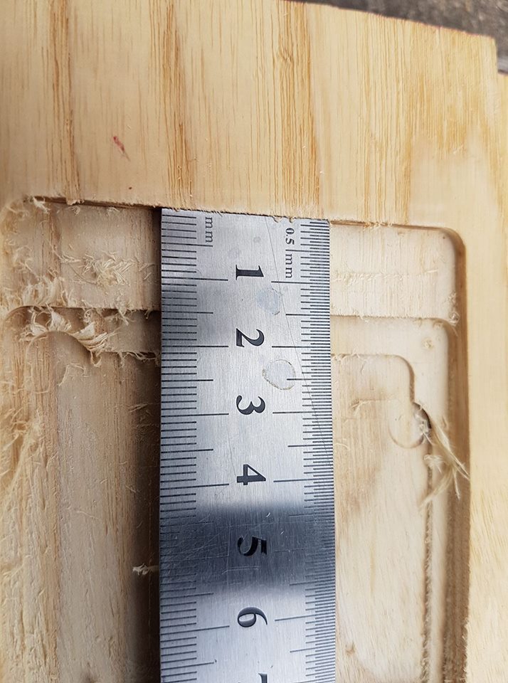

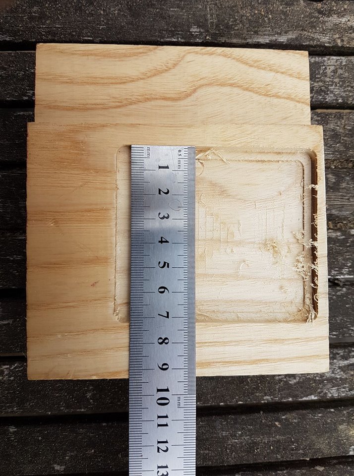

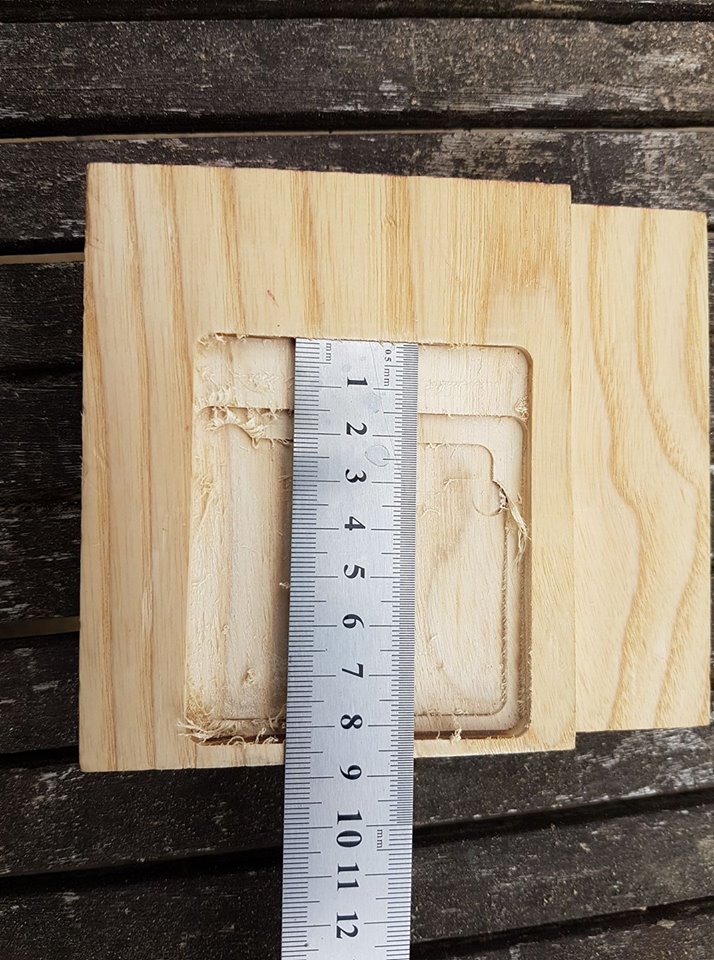

    Hi Guys managed to get 5 mins down the shed, haven't changed the settings or file format saved as mach3 format. Asked it to do a pocket cut on a piece of wood cut size 70mm x 70mm found on third pass it changed the start point 15mm to the right it does this on text as well. Gcode below (sorry couldnt find another way to post it :) ) I'm using aspire 8.5 and Mach 3 cheers Thanks again

    Well the code looks good to me every time the Z drops down the X and Y start at the same place.
    I would suggest you have a mechanical problem or you are missing steps. pulley loose etc. binding up!!

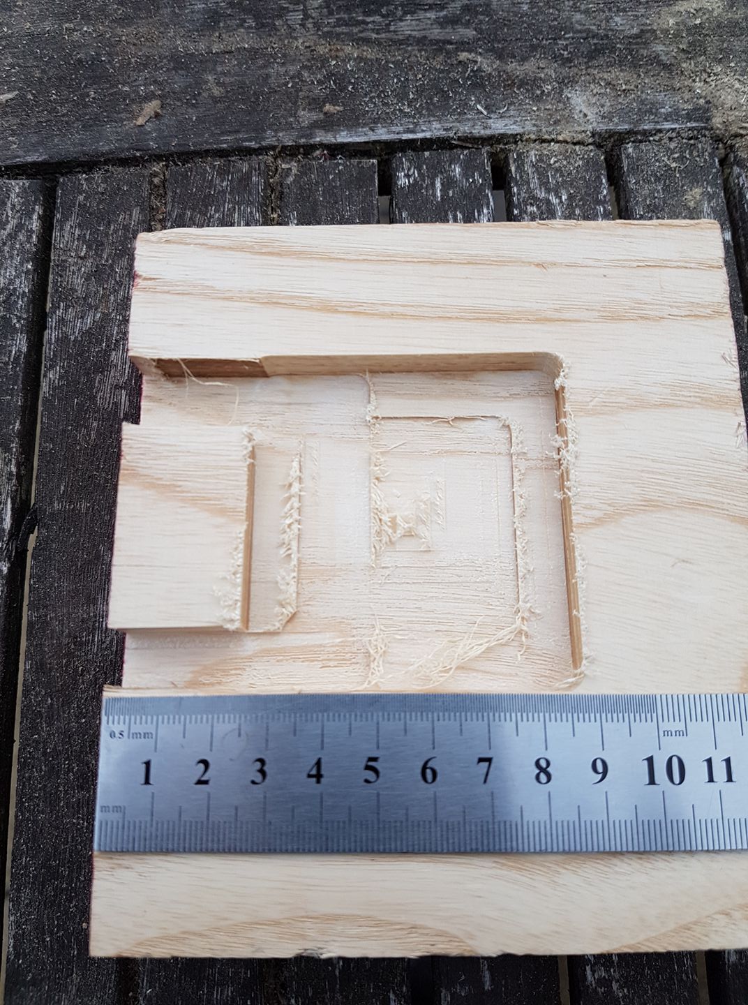

    Hi Clive no binding bud just tried saving as a Gcode file (recommended by Phil) instead of Mach 3 have a completely different issue so I'm thinking compatibility issue with the hardware software think I will email Rhonmac.Click image for larger version.

    Did the machine come with a DSP or Mach3?, check if the Rhonmac machine needs it's own post processor.
