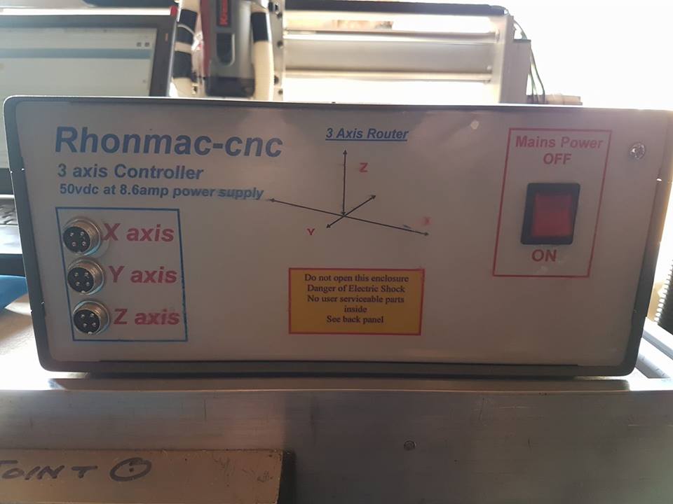

    Right guys tried setting up the machine with the set steps in settings it failed twice to move the x axis and once on the z I tried again success on the next attempts all ok with distance, it has probably failed to move at least 10 times this morning at various settings (all on the jog buttons mostly x axis). so I set up a couple of dry run pockets without extraction and router so I could hear any motor changes on the second cut I heard one at a about 30 % in I am thinking this must controller related now I will post up what they are once I've got the screw driver out.

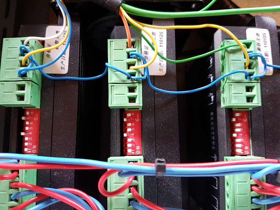

    ok, box opened images of controller cards,pc and control box my steppers are motionking 23hs1404 I have been unable to get the spec for these motors (why dont they put it on the labels?!?!? Click image for larger version.

    Look like your amps are set to 4.5 try dropping to 3.7 that is sw1-off sw2-on sw3-off then retry
    Phill
    I'm confused I have a piece of paper (came with the machine) written on the back in pencil are the dip switches, looks like they are all wrong paper says
    123 off =1.5a with a tick next to it
    sw4 = on Half current
    Micro step 5678
    5=off
    6=off
    7=on
    8=off
    to me it looks completely transposed could this be it....
    I might be wrong but I think it should be sw1-off sw2-on sw3-off = 3.7 amps, 5=on 6=on 7=off 8=on that's 1/8th micro

    Its working after a complete computer rebuild new graphics card I have ran it for 2 days without it making that awful sound in fact it ran for 3 hours constant today it didnt put a foot wrong so thank you everyone for the information and help, now how do I make money with it
