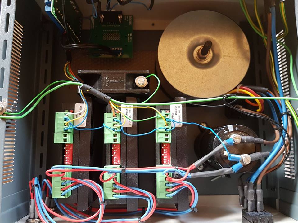

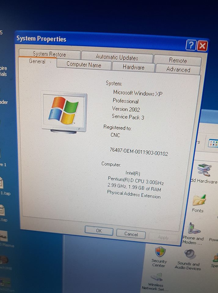

    ok, box opened images of controller cards,pc and control box my steppers are motionking 23hs1404 I have been unable to get the spec for these motors (why dont they put it on the labels?!?!? Click image for larger version.

    Look like your amps are set to 4.5 try dropping to 3.7 that is sw1-off sw2-on sw3-off then retry

    I'm confused I have a piece of paper (came with the machine) written on the back in pencil are the dip switches, looks like they are all wrong paper says
    123 off =1.5a with a tick next to it
    sw4 = on Half current
    Micro step 5678
    5=off
    6=off
    7=on
    8=off
    to me it looks completely transposed could this be it....
  10. #40
    I might be wrong but I think it should be sw1-off sw2-on sw3-off = 3.7 amps, 5=on 6=on 7=off 8=on that's 1/8th micro
