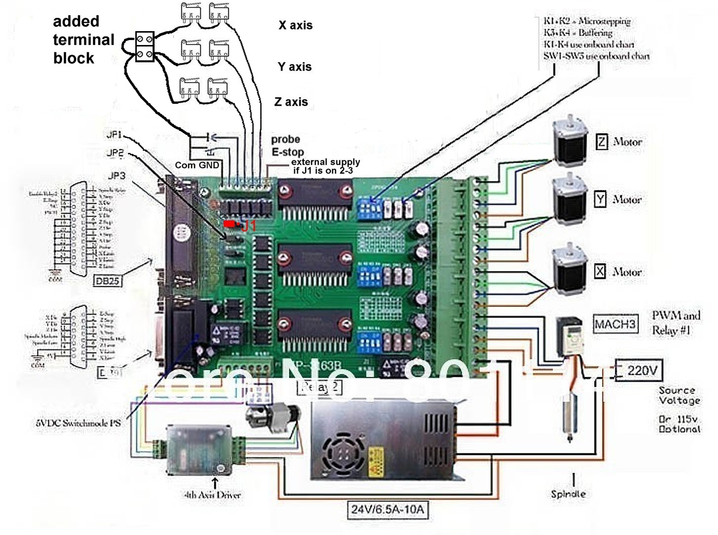

    Hi john I would like to know How to wire 2 limits so when either one
    Is pressed that axis stopes??? Which one Normally Opened
    or Normaly Closed??? Can I use the ground from the pic I upload of my board that has that single black
    Wire ??? Or does it need to come from what you have on your drawing???

    If you are daisy chaining your switches together, ie connecting them in series then they need to be normally closed.
    If you look at John's post #11 he shows you the limit switch cables.
    as Clive said
    wire N/C switches in series
    it should be the safer option as the machine will stop if a wire breaks
    as this is more likely than a two core cable being short circuited
    (although it could happen if a cable is crushed)
    the last diagram of post 11 is for 1 axis ,
    you will need three pairs of N/C switches for the 3 axis
    as mach 3 only homes 1 axis at a time you could connect all 6 switches in series and use just 1 input

    Hi there John but your drawing has com and NO pin connected and mine is NC and COM pin on mini limit switches...
    check my pic of 2 switches for one axis in series connected and tell me if I have wired it correctly???Click image for larger version.
    Then which one of the COM or NC(NO) is GND or +5V and which one signal???
    also Can I use all ground connections from that free connector on the right side of the board near 24V that says::--->> C NO 0-10V GND-<<<---?????
    Where does it say that John shows com and NO? Do you have a multi meter? I suggest you read the post again. As the drawing clearly shows you the way it is wired.
    With a multi meter is is very easy to check you have it OK. You can also check if the two grounds ie the 5V one and the one you referred to are indeed connected together. If you are not sure use the 5v ground
    now I have seen the photo of your micro switch
    I can see why you are confused
    on my diagram the N/C contact is shown as the centre terminal
    and on your switches the N/C terminal is at the opposite end to the common

    I can not find any details of the board to tell if the unused GND
    terminal can be used as an additional Ground / common for your switches
Name:	spare GND .jpg
    you will have to check for continuiy with the switch common terminal
    or use an additional terminal block to connect all the common switch wires together to a single wire from the switch common terminal

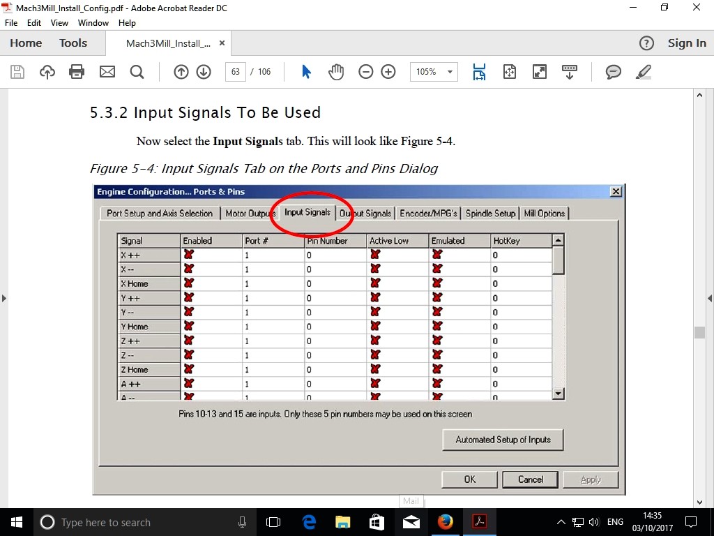

    Now My machine is a cnc6040Z USB 3 axis and I would like to know how and what I need to select from Step 1: of the installing of Mach 3.exe :::of this pic
    And then from Step 2: after installation on this pic---->Click image for larger version.
    ect ect..thank you sorry to be a pain but i'm learning allot from you guys :))

    Hi I suggest you read through the various manuals and installation vids first.
    http://www.machsupport.com/help-lear...eos-tutorials/
    http://www.machsupport.com/wp-conten...all_Config.pdf
