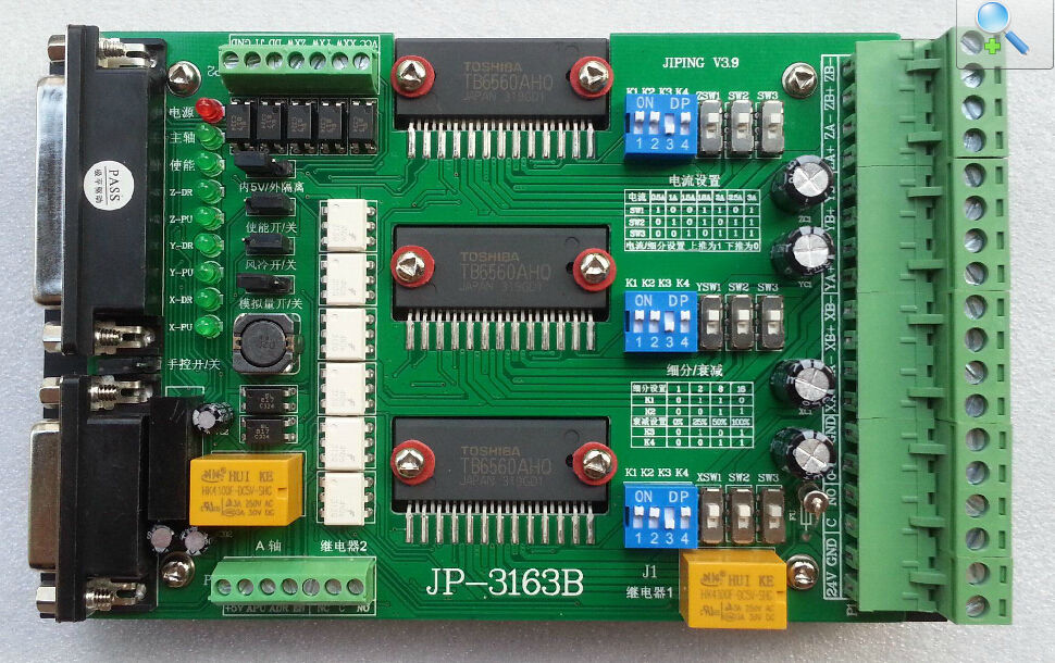

    I need help with wiring my cnc6040Z USB 800 Watt machine 3 axis limit switches -->2 per axis in Normally Closed in series to the board mentioned bellow.
    My problem is I have JP-3163B ver 3.9 motion controller board,On one side it has these connections--> VCC/XXW/XYW/ZXW and on the other C/NO/0-10V/ GND now please tell me do i need to place the 2 wires per limit switch for eg.for the X axis -->Com and NC wires in the XXW slot and Y axis Com and NC in the XYW and same for the Z axis in the ZXW or only NC wire in each of them and all the COM wires in the VCC slot?
    Im so confused ???? plus do I need resisters or is it fine without???? :

    Hi
    do you have a link to the manual you can post ?
    of better still -
    take a photo of your board
    as the google link goes to several pictures
    I think you should find the limit switch connections should go to
    a small 5 pin header on the board and not to any large screw terminals like the connections for the power and stepper motors
    John

    Hi.there I have tried to attached a pic of the actual board I have minus the DB9 which is optional on mine.now i also have [cnc6040z .settings file ] which i can not open and would like to know how to upload on this page it is saying invalid format please tell me how to upload??? I need your help on wiring limit switches and setting exact parameters in mach 3 or 4 demo according to these documents which came with the machine.???

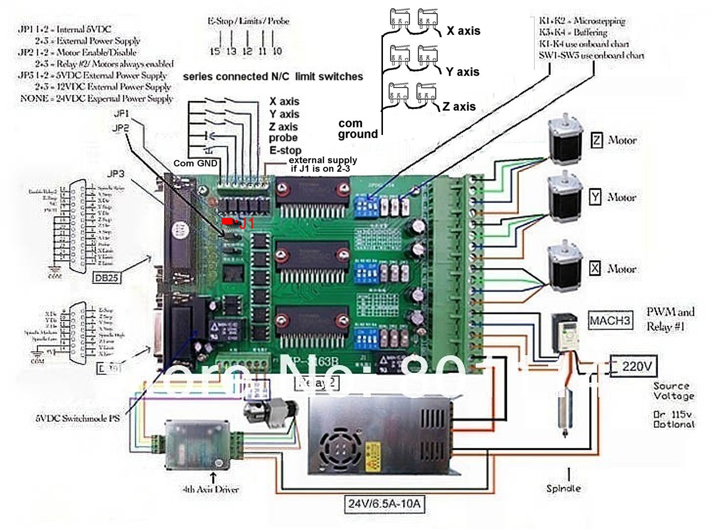

    This is how I would connect the limit switches.

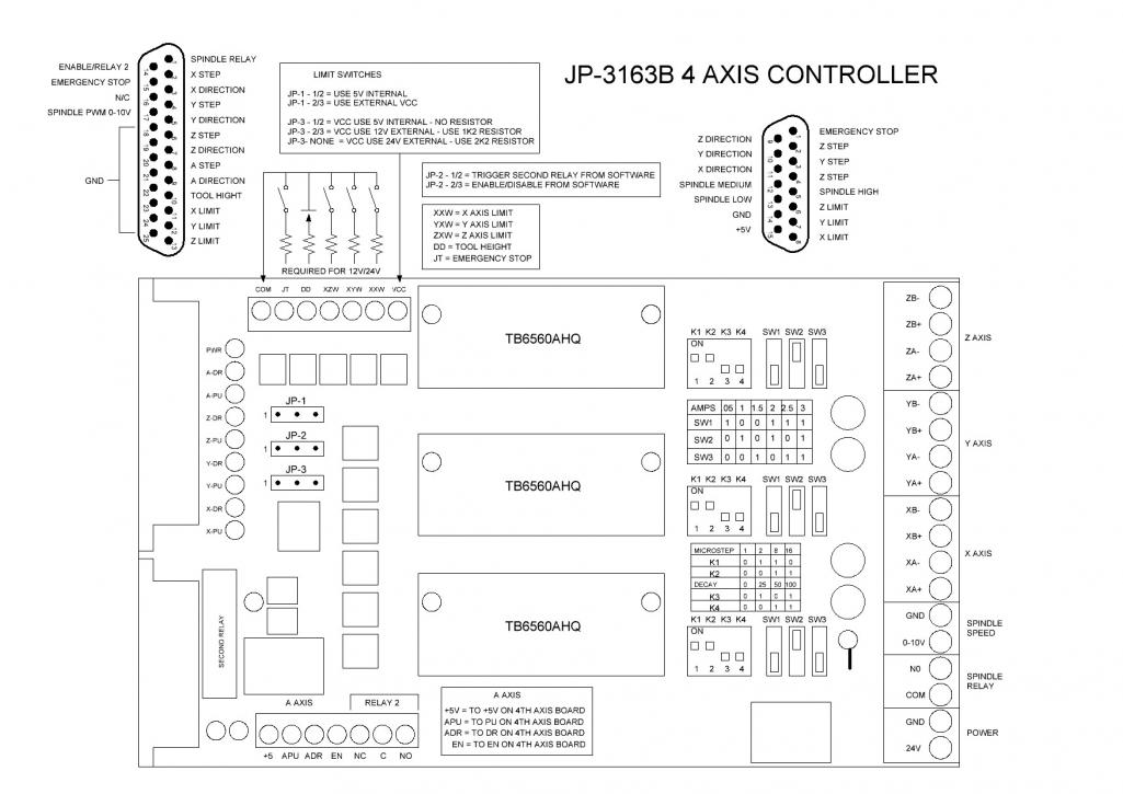

    I see Eddycurrent beet me to it
    while I was adding to one of your pictures
Name:	limit switch connections.jpg
    with only the link to select either the internal +5v or an external positive suppy for the input opto isolators
    but no link to break the ground connection
    it looks like you can not take full advantage of the input
    opto-isolators
    as soon as I can I will down load mach3 to see what the XML file setting are
    John

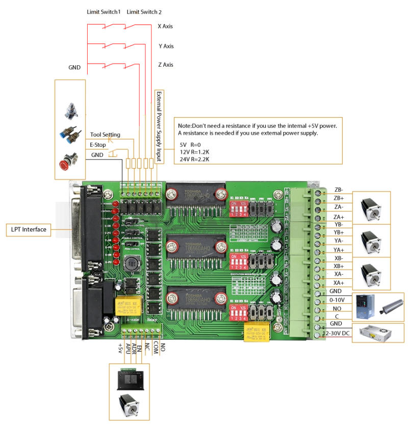

    version 2 of limit switch diagram
Name:	limit switch connections v2.jpg
    John
