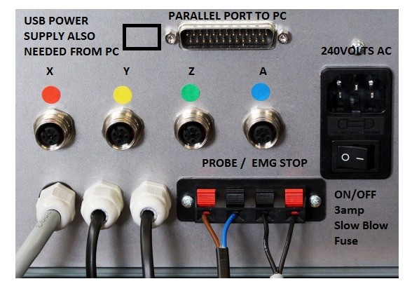

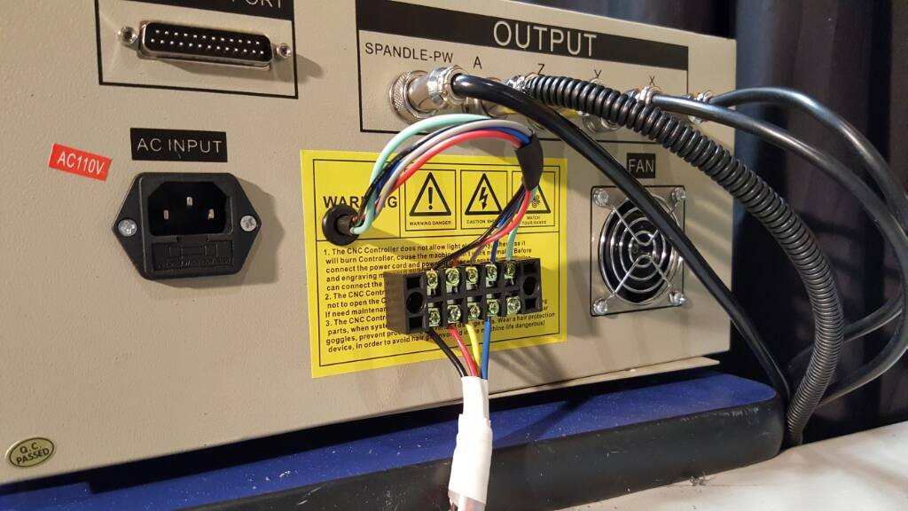

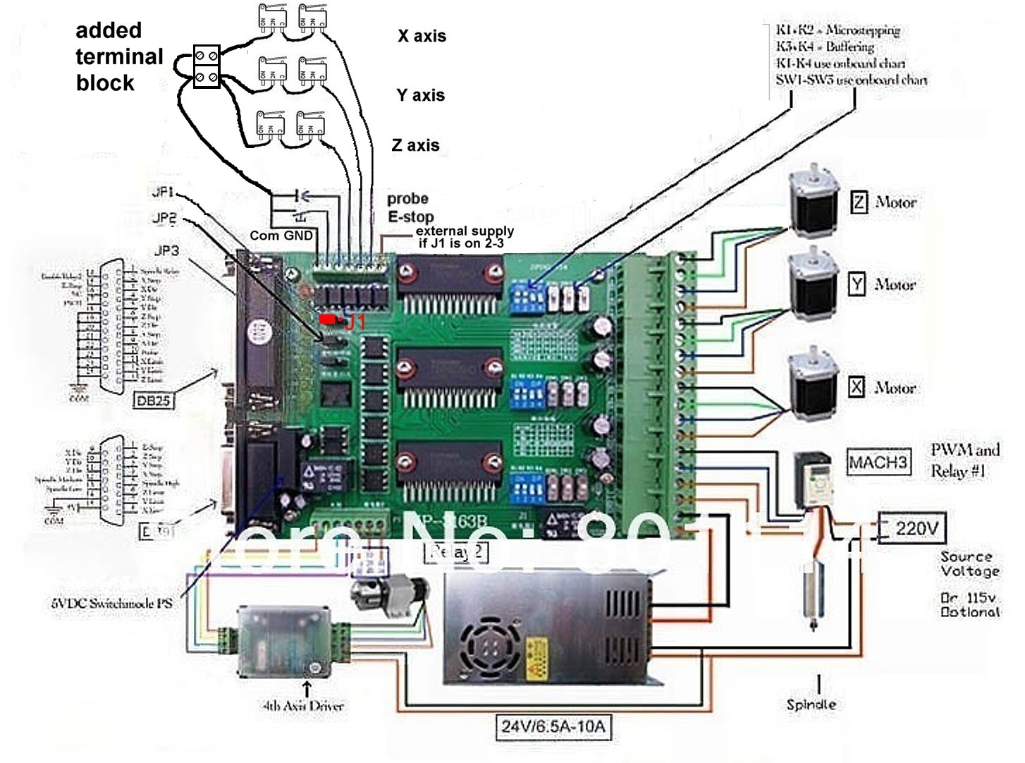

    Hi Schematicsman
    if you have the jumper J1 set for using the boards +5V supply
    you don't need to add any resistors - that's why I removed them from the original diagram
    as to how you physically wire the switches it depends on what connectors you have fitted to the control box
    very often you find "aviation" connectors are used on Chinese control boxes
    the boxes having a number of holes for 4 limit switches and a probe
    blanked off by a paper label when the connectors have not been installed
    a photo of your box will help
    if you fit four 2 pin connectors
    then one pin on each connector is connected to the common ground
    then printer port pins 10 ,11, 12, 13 can be connected to the remaining connector terminals
    pin 15 can go to your E-stop switch

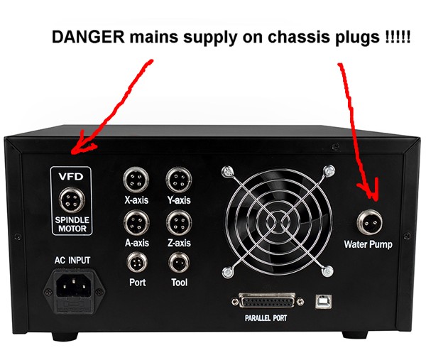

    this is the typical connectors found on Chinese control boxes
    note – the danger of mains voltage on chassis mounting plugs !!!

    some other DIY options that have been used are
    either pass the limit switch cable through a strain relief or
    used a terminal block fastened to the box

    once I know what you have and what method you want to use
    either wire the limit switches directly to the breakout board or go via connectors mounted on the box
    I will add more diagrams of the wiring

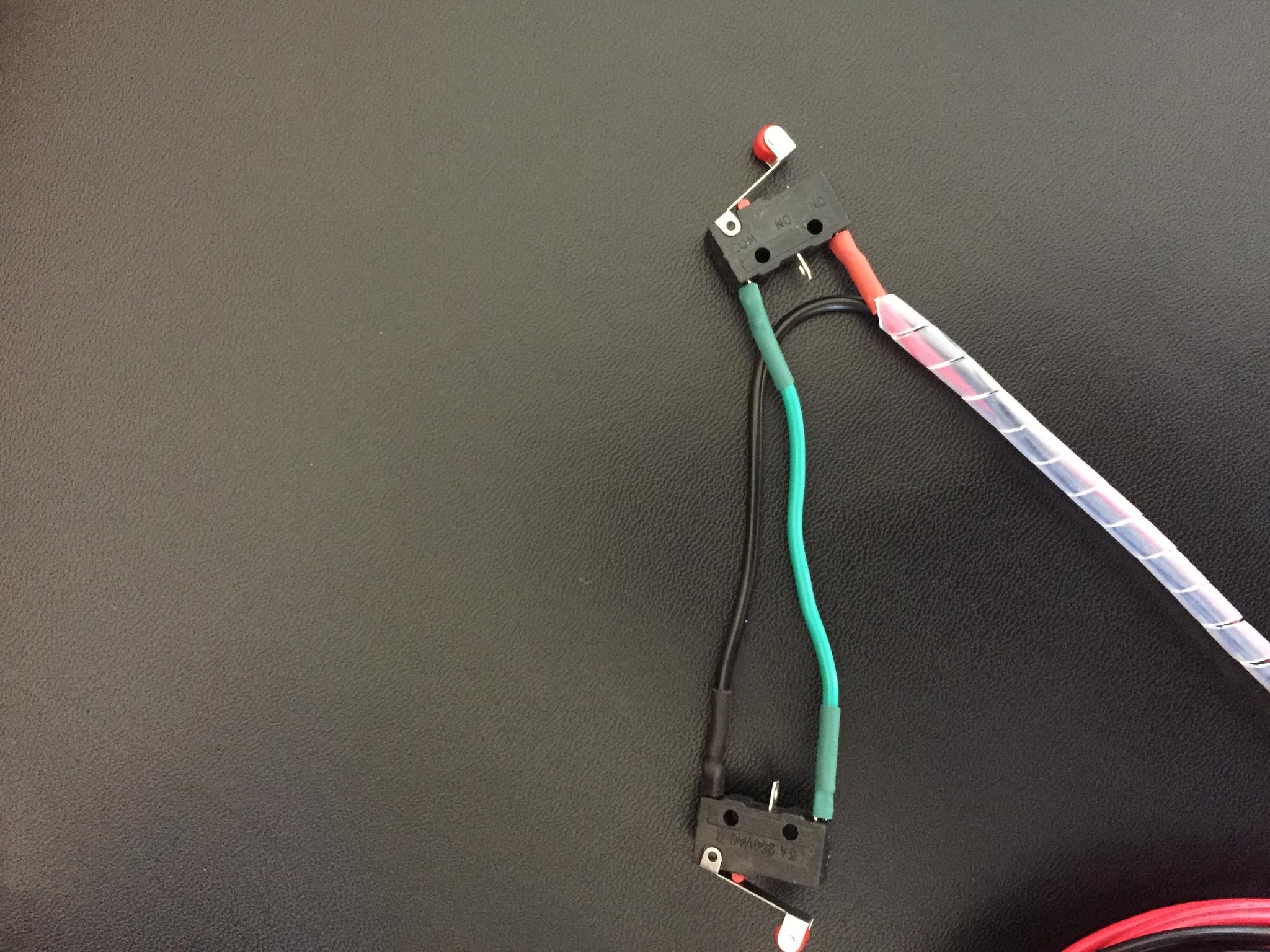

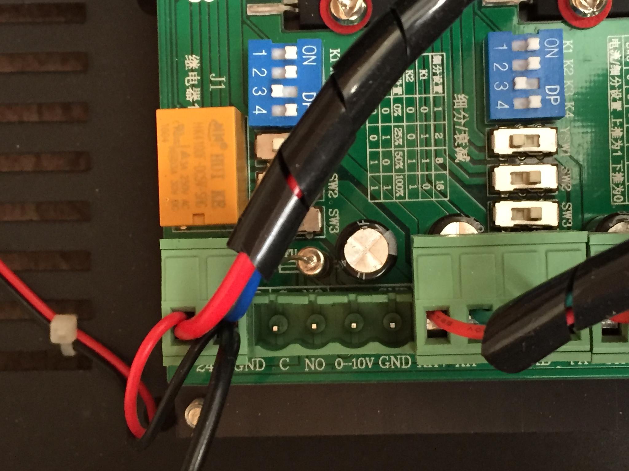

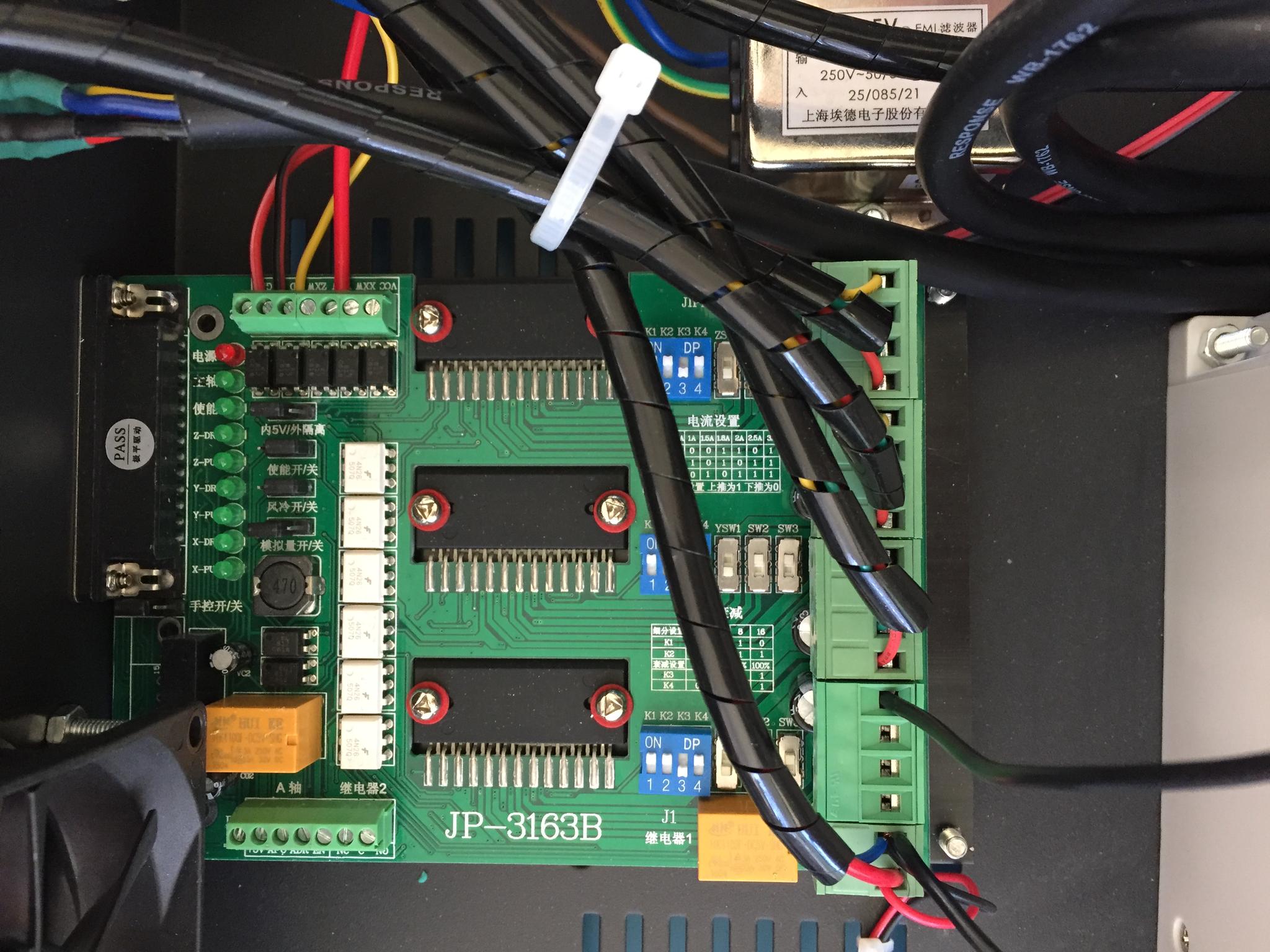

    Hi john I would like to know How to wire 2 limits so when either one
    Is pressed that axis stopes??? Which one Normally Opened
    or Normaly Closed??? Can I use the ground from the pic I upload of my board that has that single black
    Wire ??? Or does it need to come from what you have on your drawing???

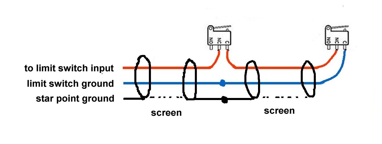

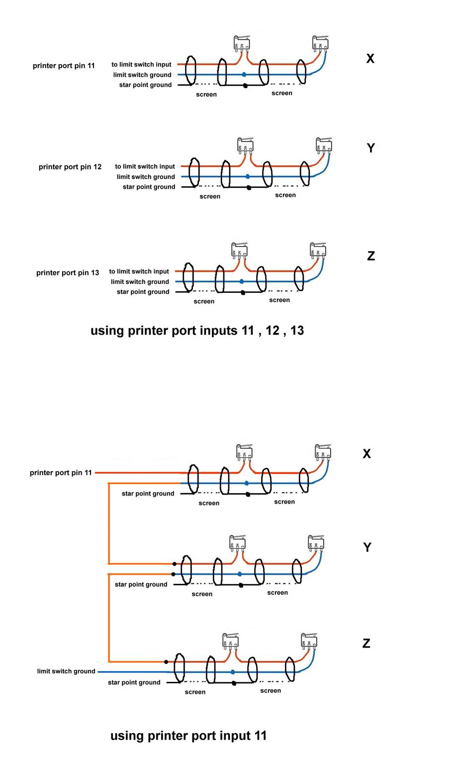

    If you are daisy chaining your switches together, ie connecting them in series then they need to be normally closed.
    If you look at John's post #11 he shows you the limit switch cables.
  4. #14
    as Clive said
    wire N/C switches in series
    it should be the safer option as the machine will stop if a wire breaks
    as this is more likely than a two core cable being short circuited
    (although it could happen if a cable is crushed)
    the last diagram of post 11 is for 1 axis ,
    you will need three pairs of N/C switches for the 3 axis
    as mach 3 only homes 1 axis at a time you could connect all 6 switches in series and use just 1 input

  5. #15

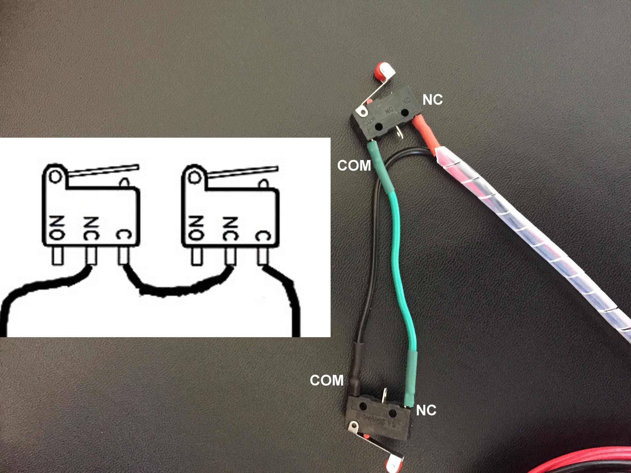

    Hi there John but your drawing has com and NO pin connected and mine is NC and COM pin on mini limit switches...
    check my pic of 2 switches for one axis in series connected and tell me if I have wired it correctly???Click image for larger version.

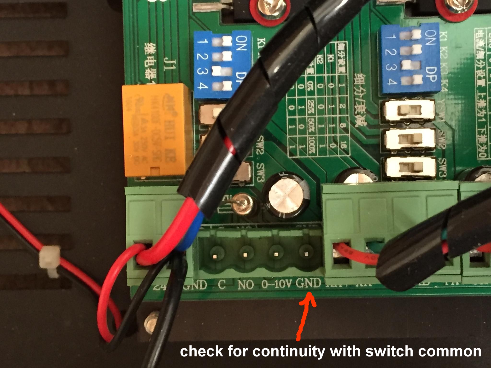

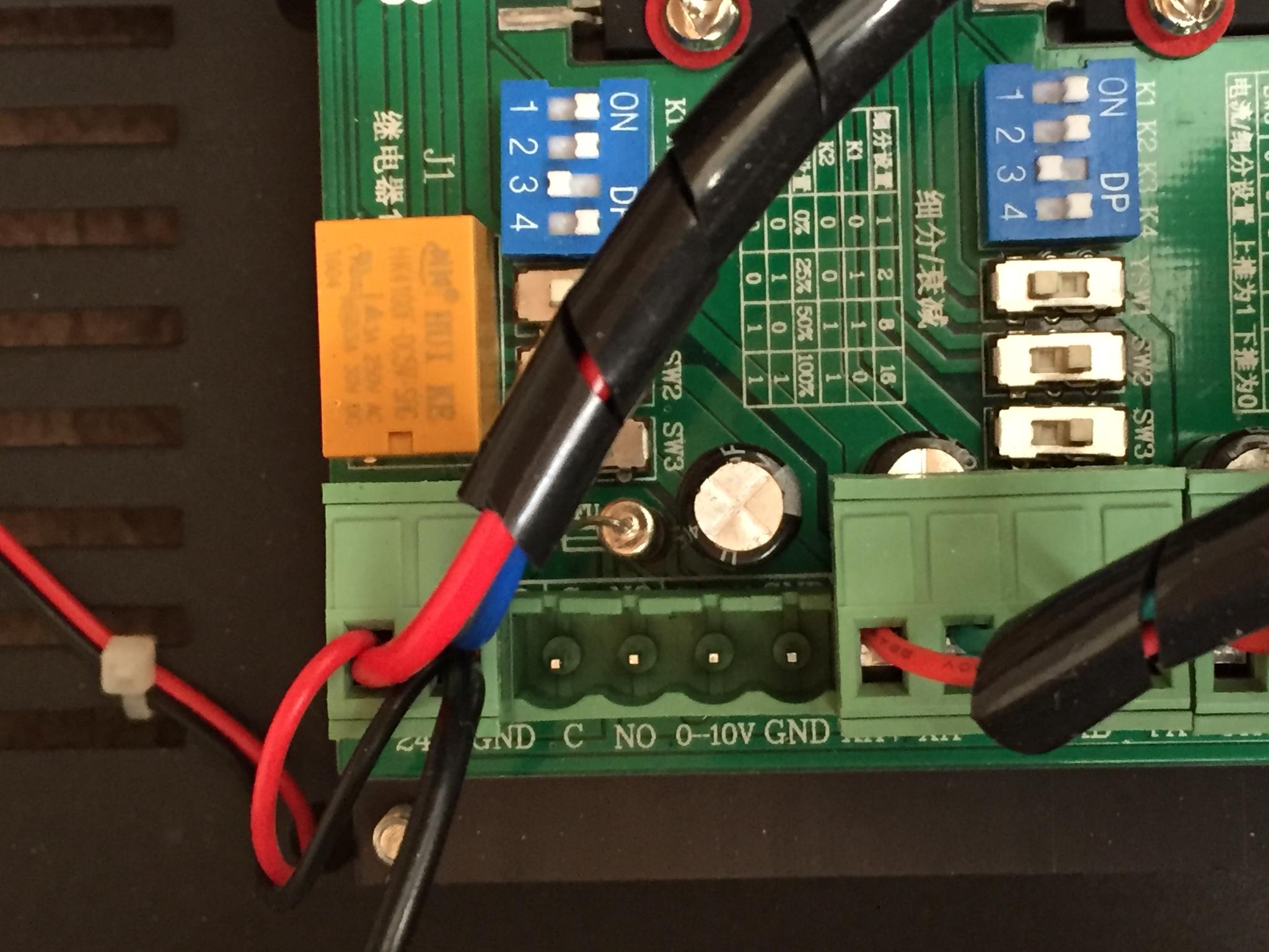

    Then which one of the COM or NC(NO) is GND or +5V and which one signal???
    also Can I use all ground connections from that free connector on the right side of the board near 24V that says::--->> C NO 0-10V GND-<<<---?????
ID:	22906 on this pic??????
    I'm confused
  6. #16
    Where does it say that John shows com and NO? Do you have a multi meter? I suggest you read the post again. As the drawing clearly shows you the way it is wired.
    With a multi meter is is very easy to check you have it OK. You can also check if the two grounds ie the 5V one and the one you referred to are indeed connected together. If you are not sure use the 5v ground
  7. #17
    now I have seen the photo of your micro switch
    I can see why you are confused
    on my diagram the N/C contact is shown as the centre terminal
    and on your switches the N/C terminal is at the opposite end to the common
Name:	micro switch wiring.jpg
    John
    PS
    I can not find any details of the board to tell if the unused GND
    terminal can be used as an additional Ground / common for your switches
Name:	spare GND .jpg
    you will have to check for continuiy with the switch common terminal
    or use an additional terminal block to connect all the common switch wires together to a single wire from the switch common terminal
Name:	limit switch connections.jpg

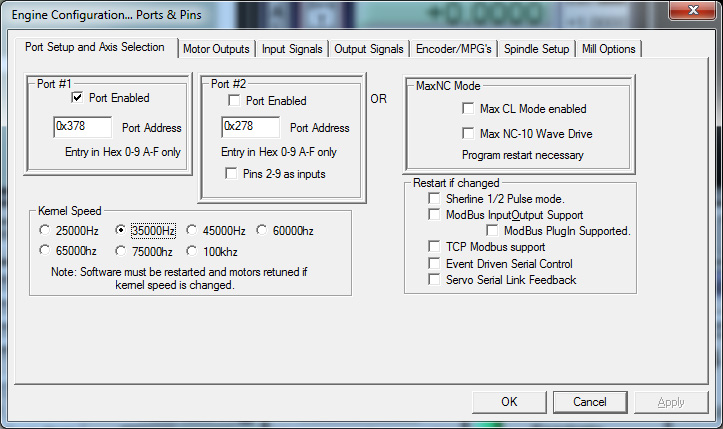

  8. #18

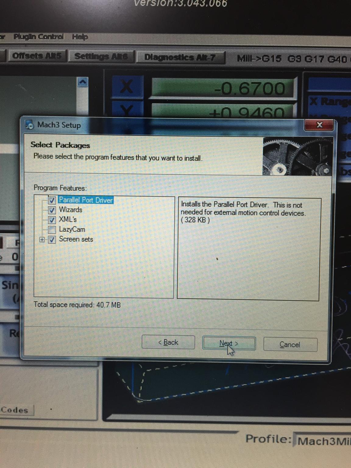

    Hi,there Clive I was saying that Johns pic of two limit switches in Normally Closed connection at the top of this page looked different to my limit switches in NC connection. that's all I guess the the limit switches were different, but thank you both for being patient and very supportive,as I wouldn't even get this far.:)
    Now My machine is a cnc6040Z USB 3 axis and I would like to know how and what I need to select from Step 1: of the installing of Mach 3.exe :::of this pic
    And then from Step 2: after installation on this pic---->Click image for larger version.
    ect ect..thank you sorry to be a pain but i'm learning allot from you guys :))

  9. #19
    Hi I suggest you read through the various manuals and installation vids first.
    http://www.machsupport.com/help-lear...eos-tutorials/
    http://www.machsupport.com/wp-conten...all_Config.pdf

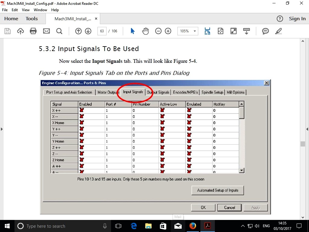

    assuming you have the USB motion controllers "plug in " installed so Mach3 works via the USB connection
    to add the probe you will need to go into mach 3 ports & pins
    and select input signals
Name:	mach3 inputs.jpg
    about halfway down you will find the probe
