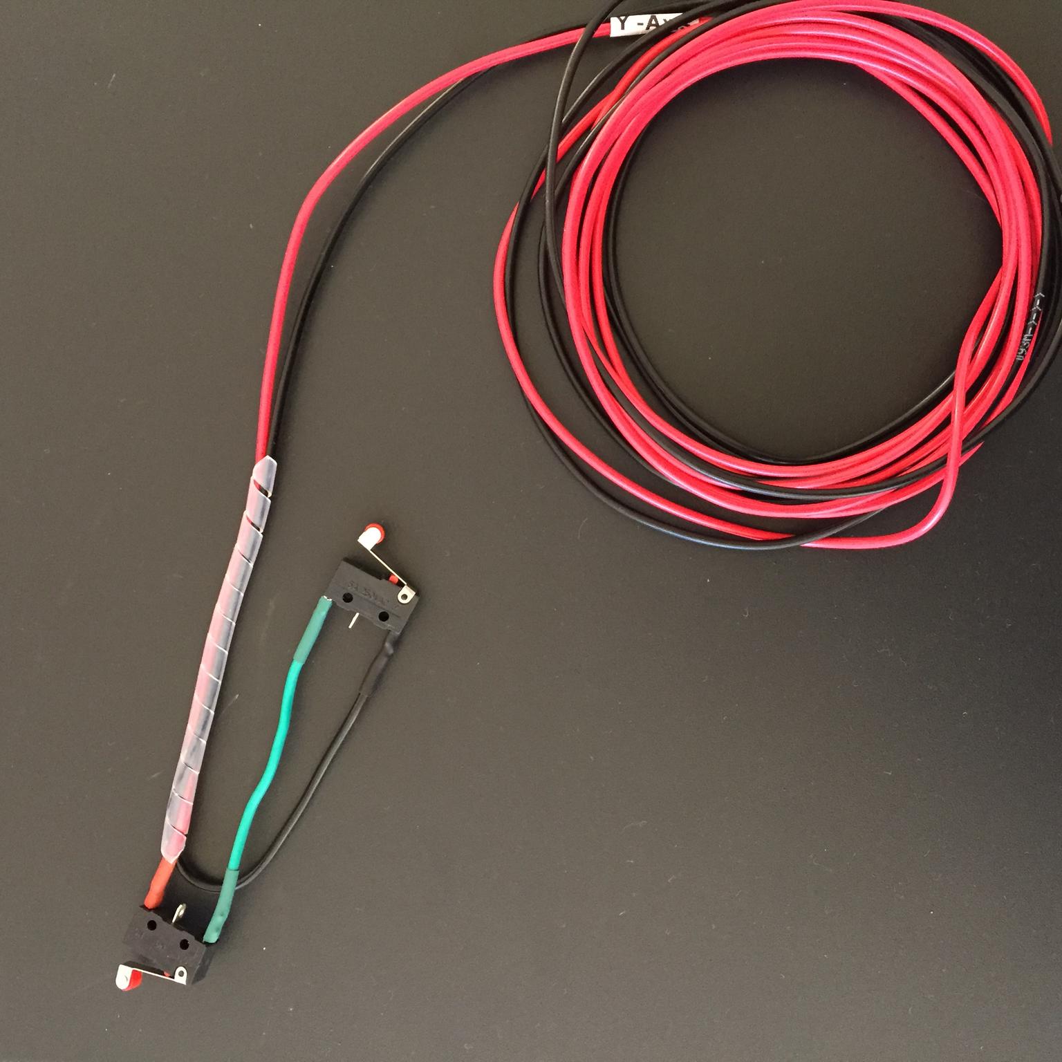

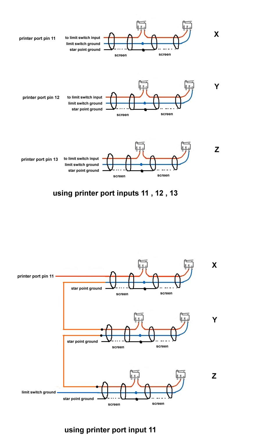

Hi john I would like to know How to wire 2 limits so when either one
Is pressed that axis stopes??? Which one Normally Opened
or Normaly Closed??? Can I use the ground from the pic I upload of my board that has that single black
Wire ??? Or does it need to come from what you have on your drawing???
If you are daisy chaining your switches together, ie connecting them in series then they need to be normally closed.
If you look at John's post #11 he shows you the limit switch cables.
