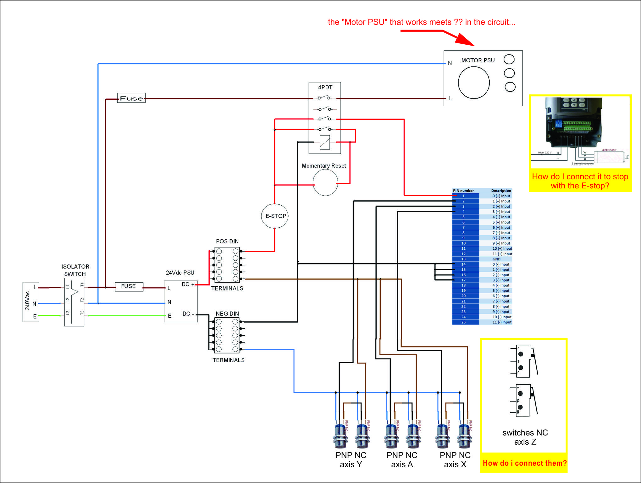

    Hi, I'm all doing a homemade CNC router and I'm in the final stage of my project, I have a CSMIO IP-M controller and I do not understand how to connect the emergency stop and the limit switches to the controller,
    1- the idea is to do it directly without the PILZ relay ... is this possible?
    or do you have to use the PILZ relay if or if?
    2- the limit switches are PNP sensors can someone help me how to connect it?
    I hope your collaboration !!!
    thank you very much
    Greetings Jorge

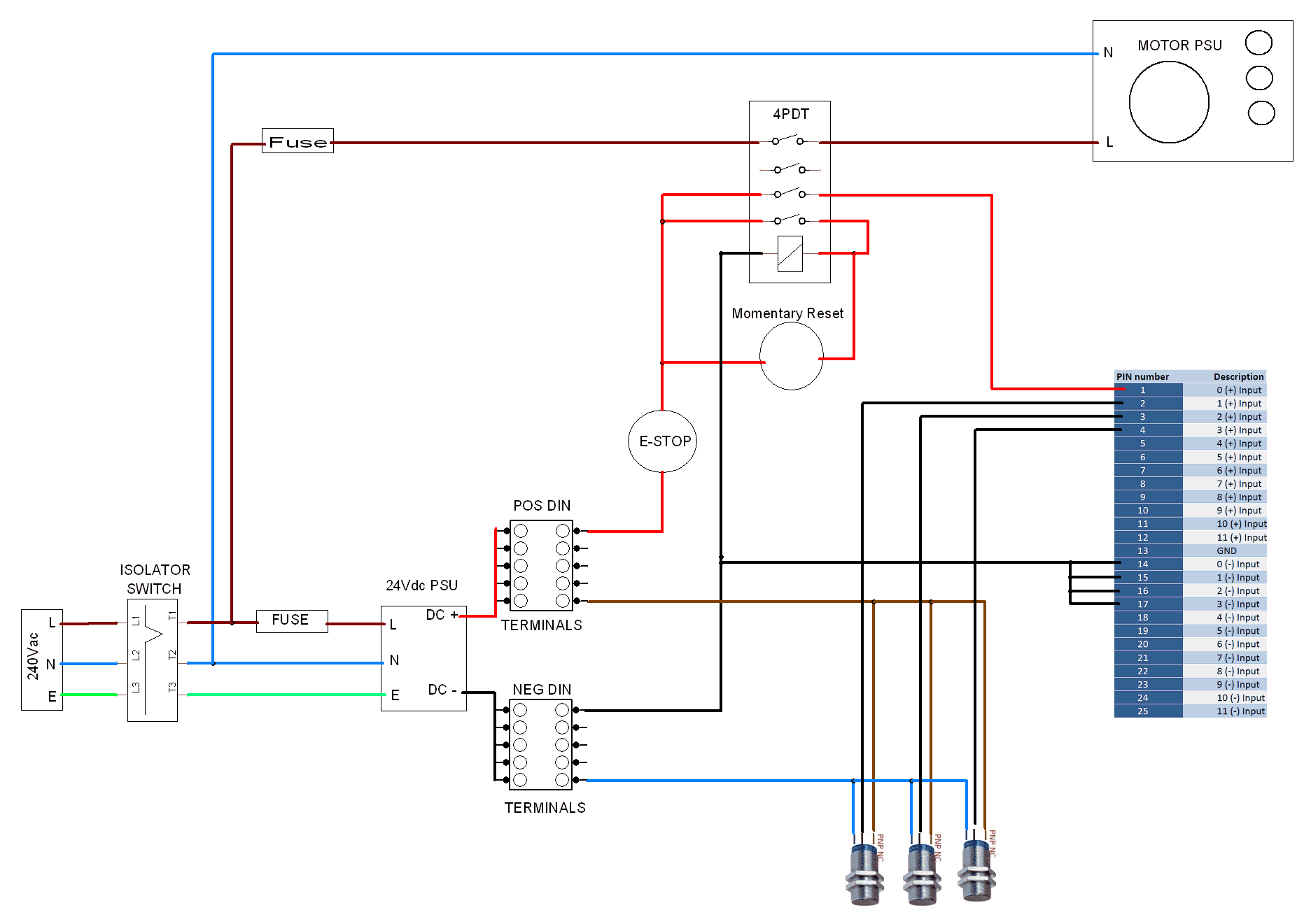

    Hi Jorge,
    To be completely safe you really should use hardware controlled E-stop safety circuit however you don't need to use an expensive Pilz relay, you can use an ordinary relay and create your own latching circuit. Just make sure the Contacts are rated to suit the current your pulling.
    Here's a diagram showing how to do it using standard 4pole 24Vdc relay. The spare contact can be used to inform VFD that E-stop occured so shuts spindle down or to control other relays etc.
    Also included wiring for PNP sensors.

    Hi Jorge,

    JAZZ, I appreciate your description and the diagram you send me !!!
    forgive my ignorance in the electronic and my translation into English
    I have several questions
    1- the "Motor PSU" that works meets ?? in the circuit...
    2- The VFD connection how do I do it? ...
    3- I send you a diagram of how it would look to see if it is ok, since I have several PNP sensors (Y-A-X axes) and 2 mechanical switches on the Z axis
    4- the Z axis switches how do I connect them?
    thank you very much !!!

Name:	IP-M Simple E-stop....modified.jpg
    See new drawing.
    Regards the Limit switches I just want to make you aware that can use just one switch that moves with the axis and sense targets at each end of travel. This lowers the number of switches required to one for each axis and less wiring required which means lower chance of faults.
    Each switch can also share the homing and limit switch dutys.
    .If want to use this method then wire limits like in my first drawing. Set Limits and homes for each axis to same pin number in mach3 and then go to general config and turn off Home SW safety option.
    In this new drawing the VFD is stopped if E-stop occurs. Also VFD will tell the controller if VFD faults. For this to work you will need to enable Spindle fault detection and set the Input # used.
