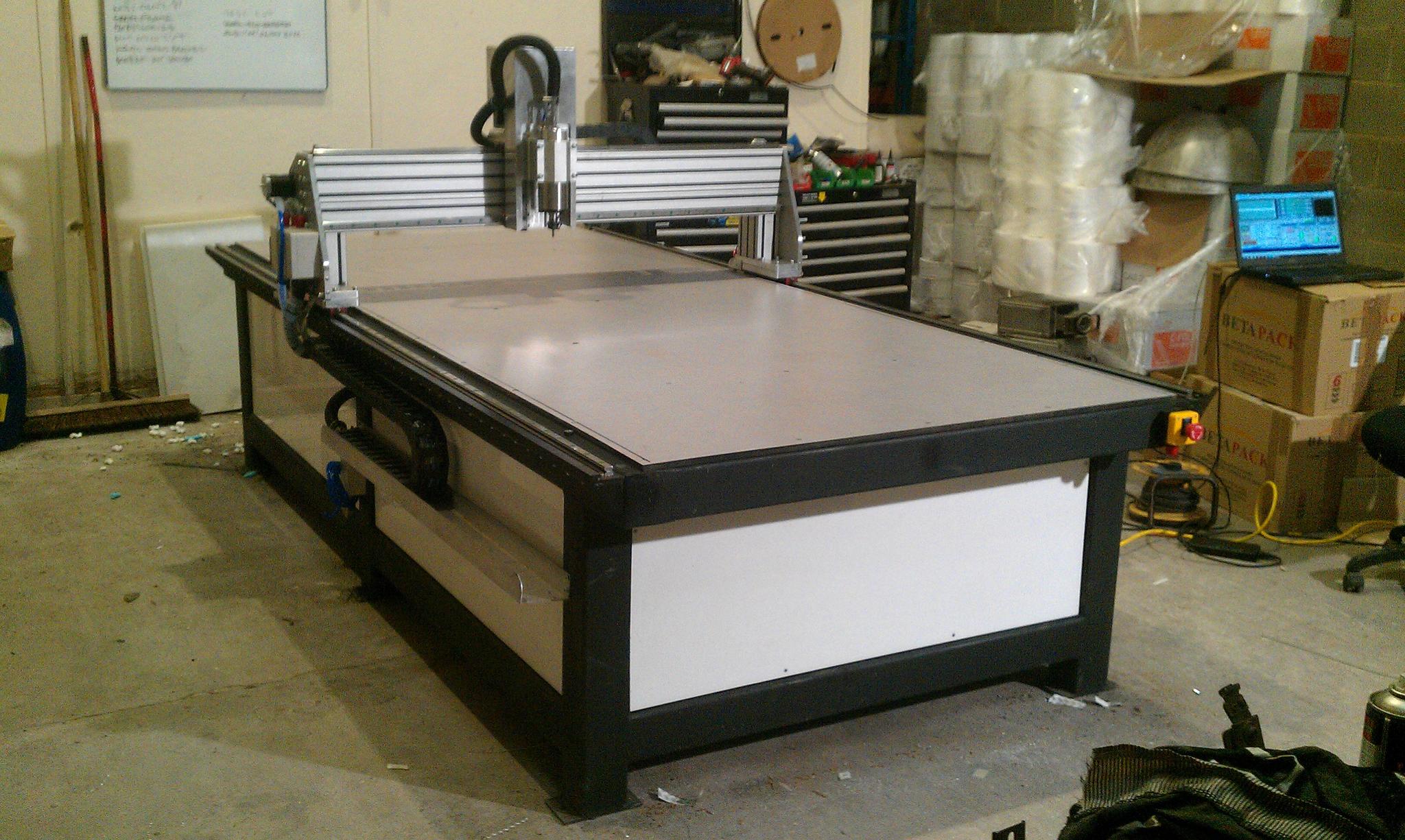

    For machine designs there is the fixed gantry style and moving table (which is very rigid but requires lots of space) and there is the moving gantry type which gives a much large working space for a given footprint.

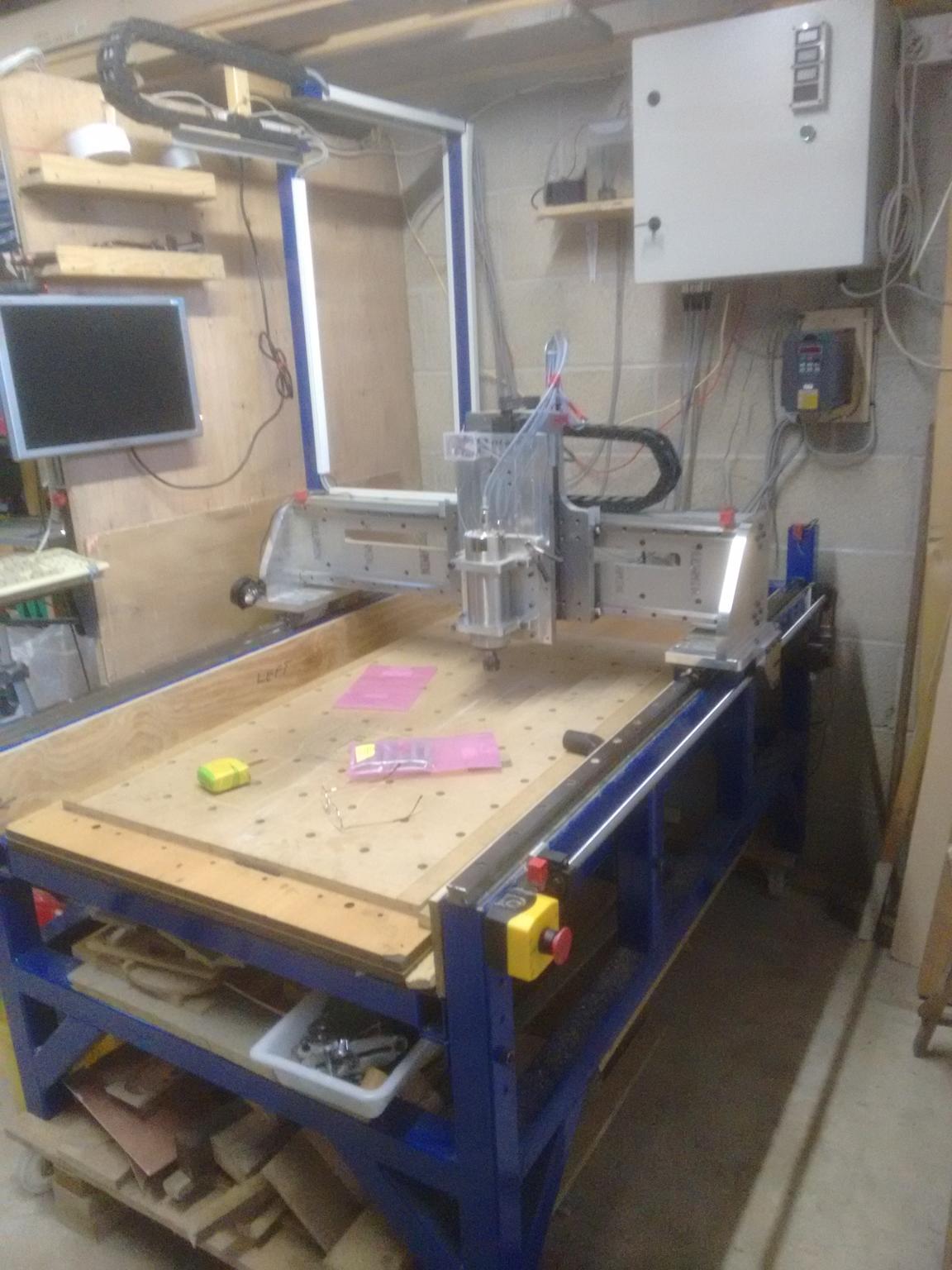

    The moving gantry type is generally use for wood working. This can be split a bit more into frame gantry where the gantry has sides dropping down to the bed:
    (c) Dean/Jazz
    and beam gantry, where the bed is raised up to give more stiffness but can limit access for sheet feeding onto the machine:
    (c) Clive
    On this forum we would usually recommend the beam gantry because of it's versatility (extra stiffness helps for aluminium cutting), but strictly for what you want to do the frame gantry would be fine.

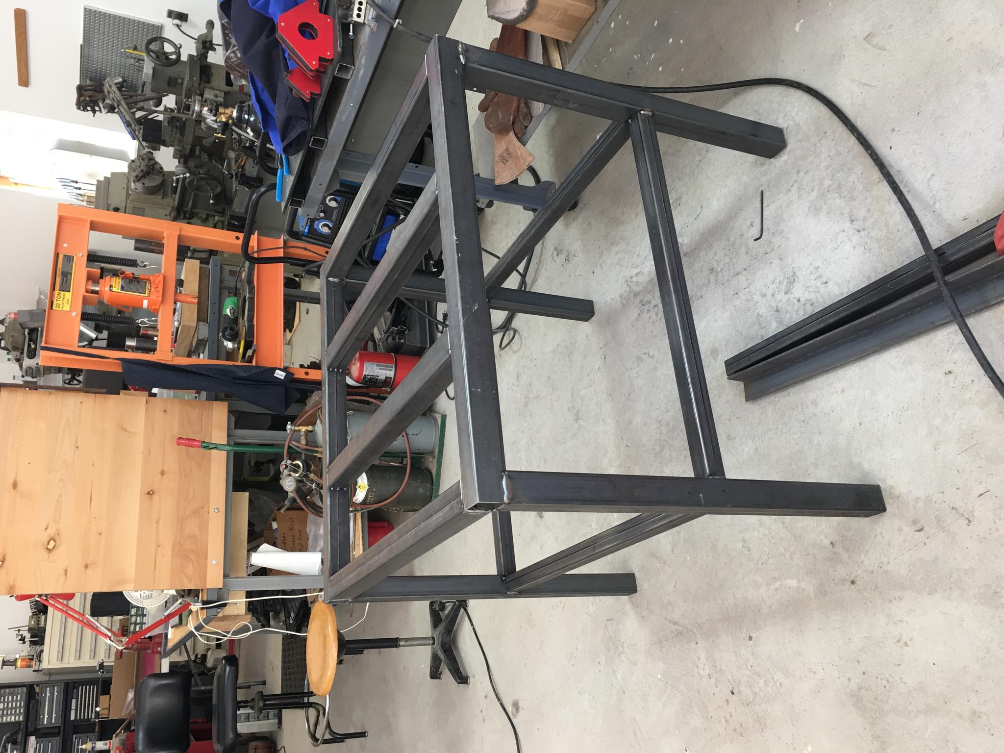

    Welded up the base and added legs.

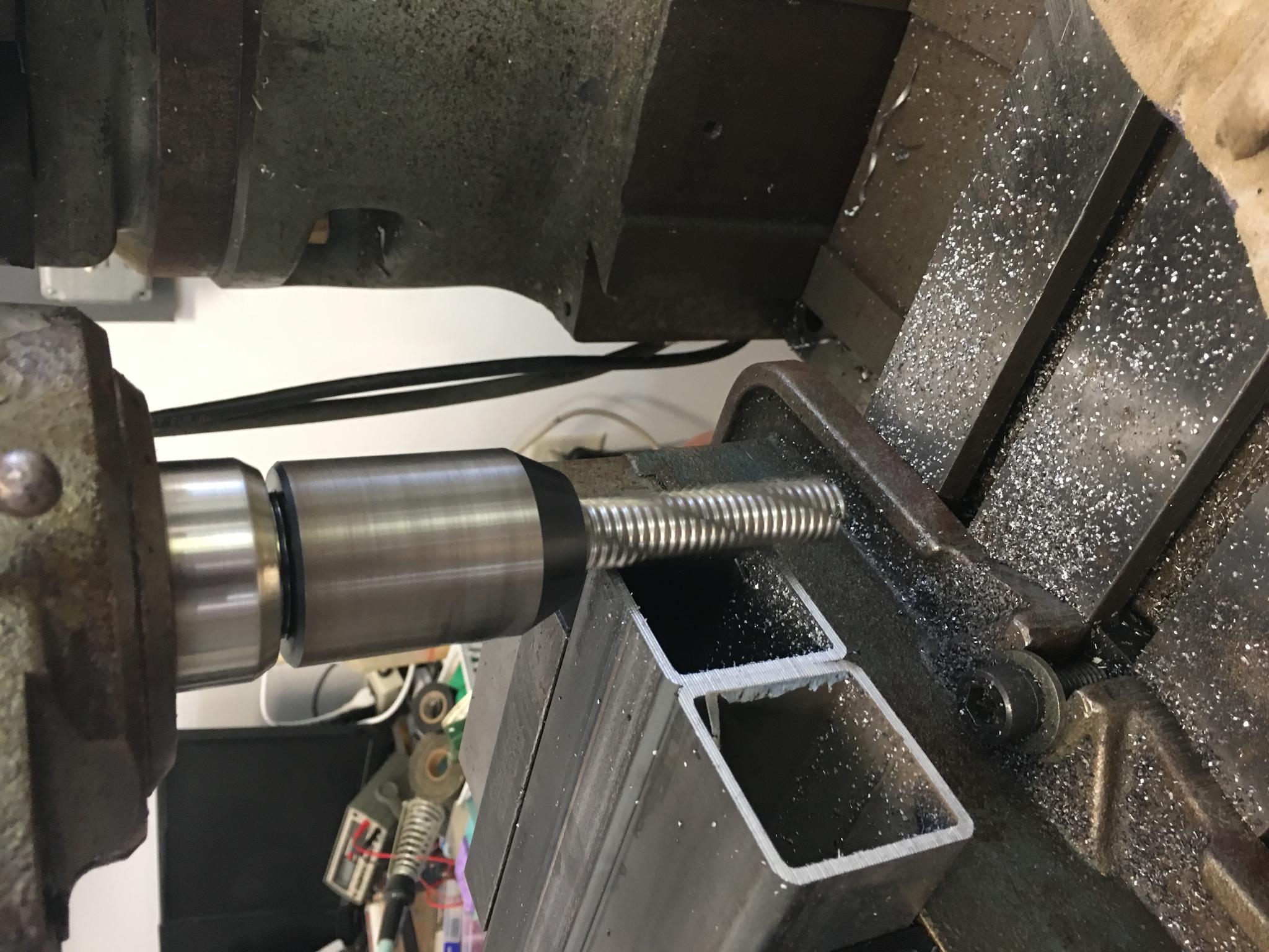

    Milling ends to be square and even:
ID:	22898Click image for larger version.

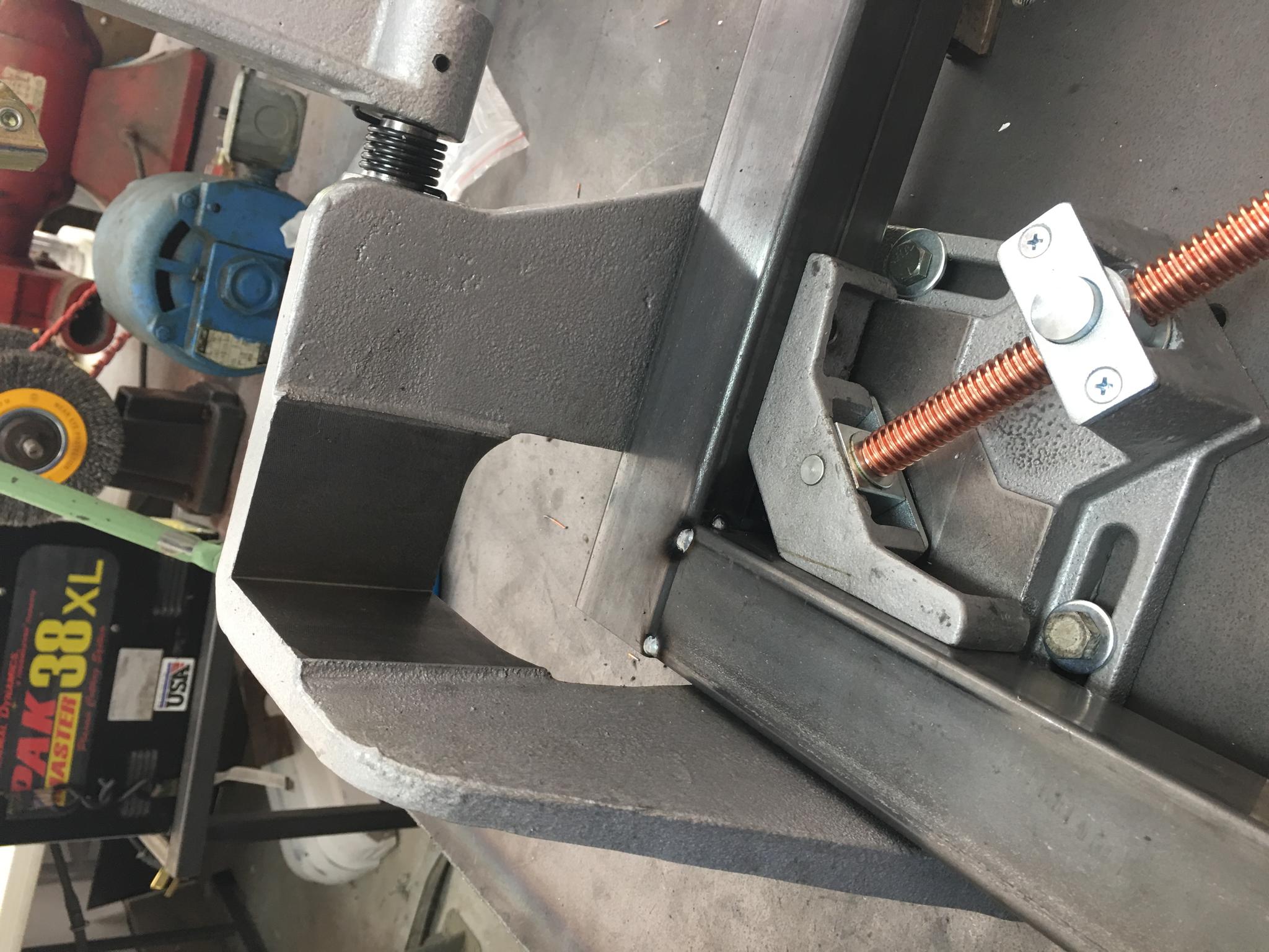

    My Strong Hand jig. Very handy for getting things square:
    So, here's where I'm at now:

    So, here are my next decisions. Any advice appreciated:
    - Putting another 2" square tube on top of existing ones for added stiffness. I can either mount rails on top (using epoxy to level), or mount rails to sides and use bolts for tubing to provide adjustment for parallelism. Leaning towards welding tube on and using epoxy...
    - Using only one of the trucks per rail. Given the size of these, would that work?
    All for now. Thanks!
    Wallace
