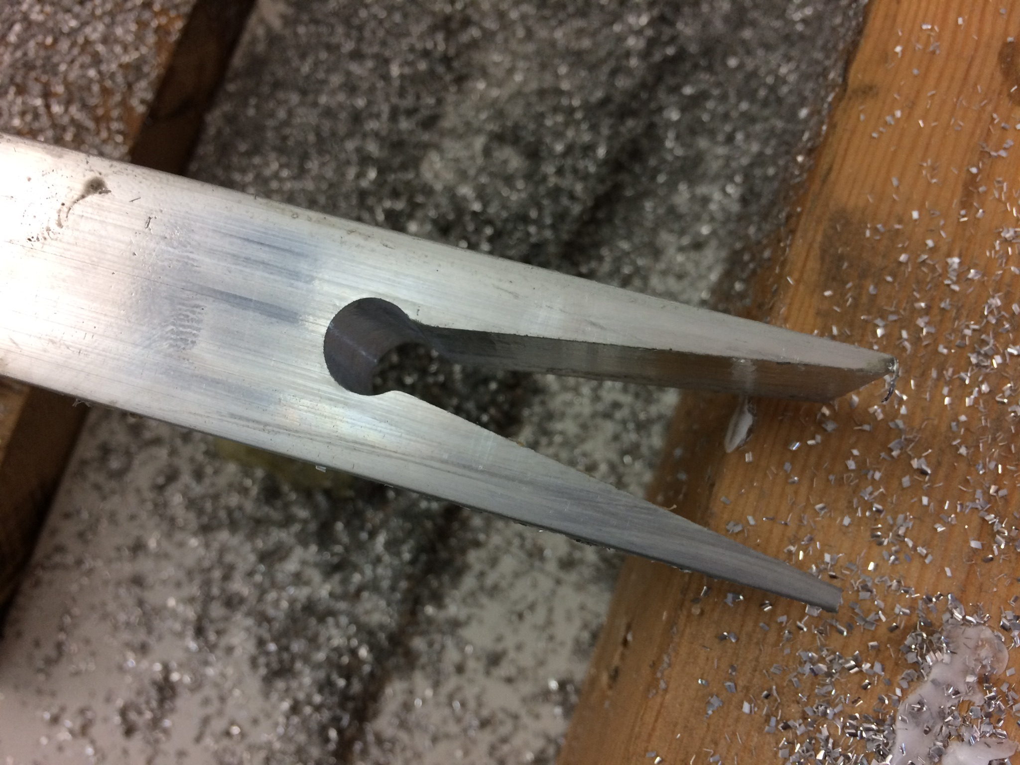

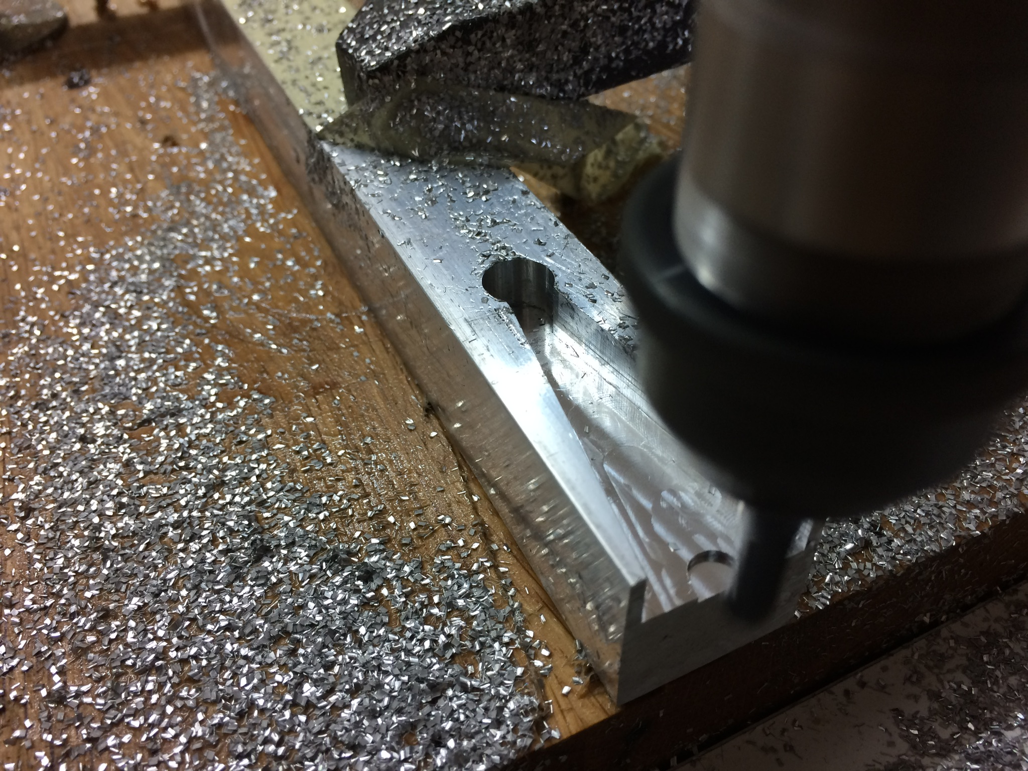

    I had a go at machineing the keyway yesterday with my less than perfect cnc designed for cutting polystyrene and although I had to go very slow and I only took 1mm cuts it did get the job done quite well, it would have been even better if I had a long enuff bit too.
    Now I just need to find some one with a machine that can do the radius a bit better.
