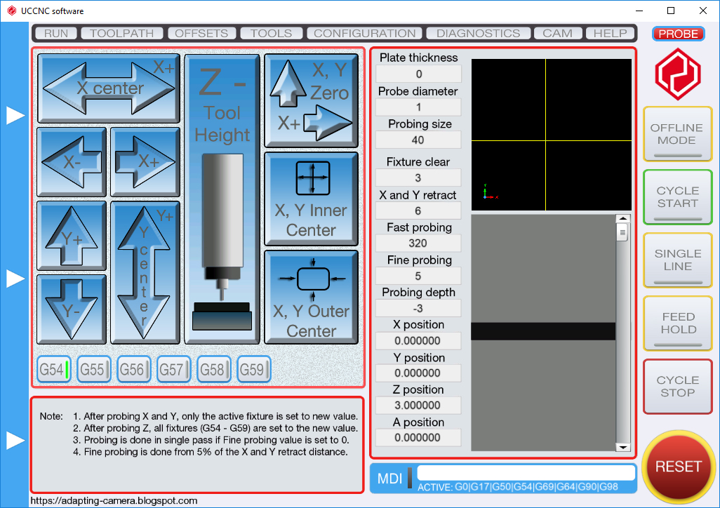

    Finally, today I managed to release my new Probe screen, the version 3. The files include a simpler installation procedure than the one before, as well as a modified RUN tab, which is optional, if you don't want it you don't need to install it. There is also a pdf document explaining how to install and use the Probe screen.
    The new Probe tab looks like this:
    The parametrised version is considerably more flexible to use but it needs to be set up by the user.

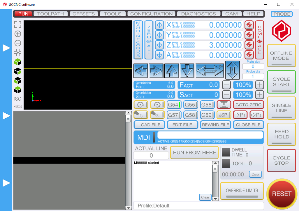

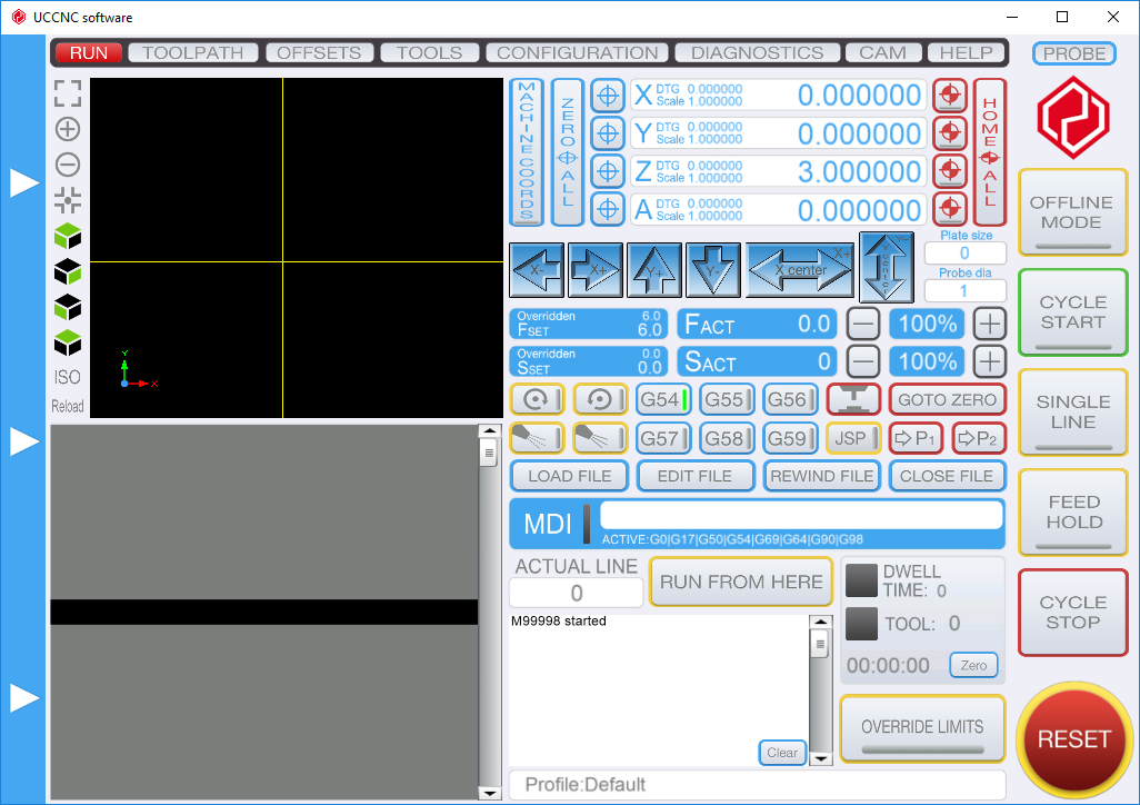

    The additional screen is a support screen for probing from the RUN tab.

    If anyone is using this feature, please download again and replace the M20040.txt macro with the new one. I have just detected a bug, which may result in that your probe will be crashed into the work piece if you are probing the outer centre of an object, using the "X, Y Outer Center" button. I don't think many people use that button, but be aware of the problem.
    What happens is that after probing in Y direction the probe is Y centred and moved towards negative X but the movement is only half the distance of the Probing size value when the probe is lowered. This is now corrected in the new macro.
    Sorry.
