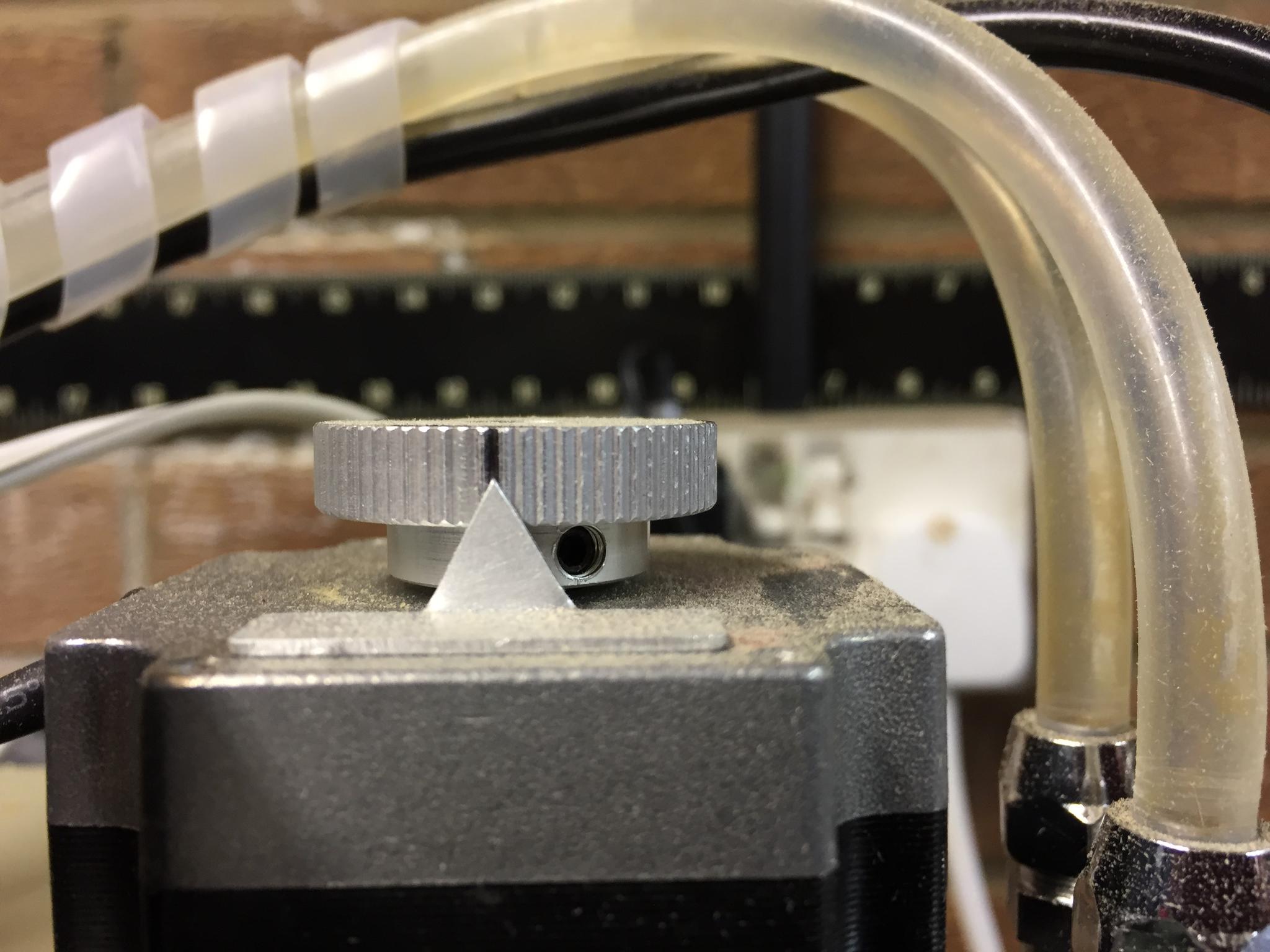

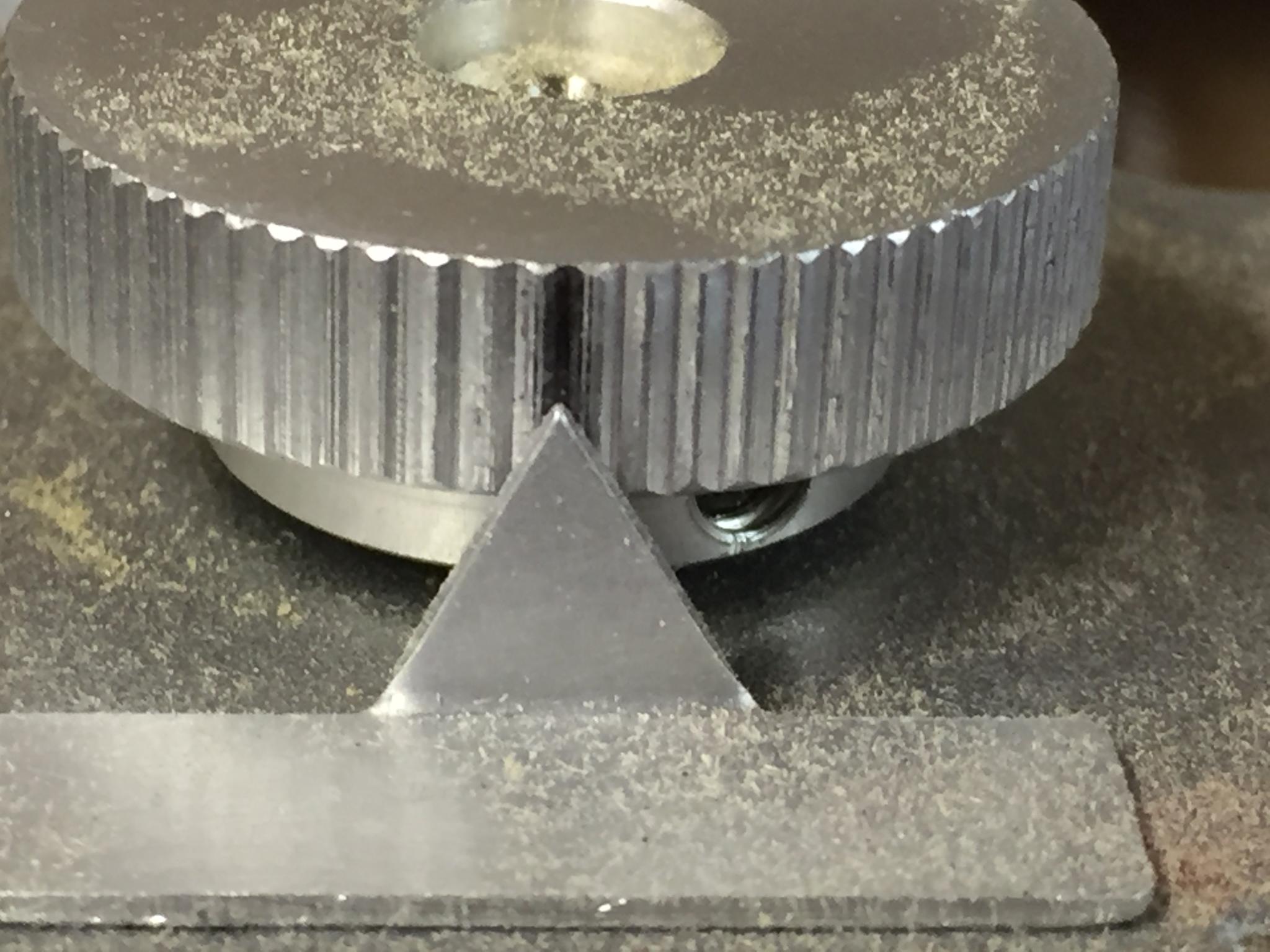

    If like me you just want a quick check to make sure your chinese steppers are returning to zero every time you move around the table, I made these yesterday, one for each stepper
