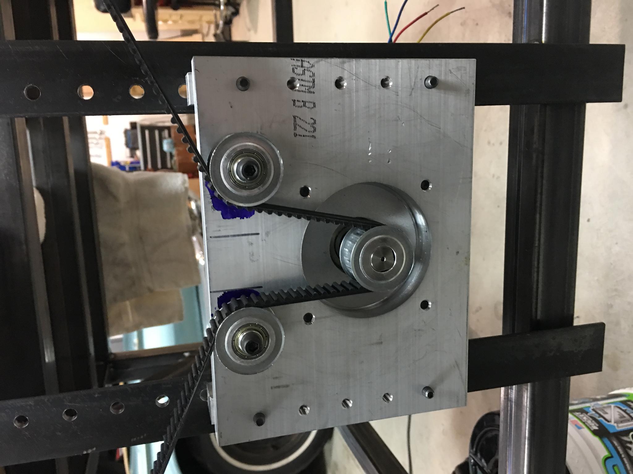

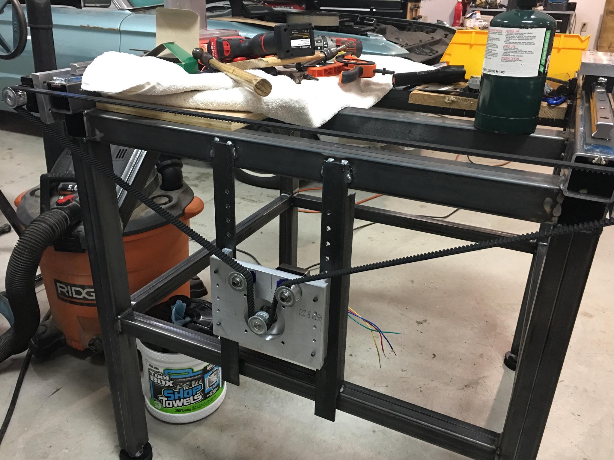

    Well, here is what I ended up with:
    Sorry the 2nd pic is rotated (again) - but I think I figured it out now that I have one that is and one that isn't...
    Anyway, I am thinking of an adjustable tensioner. Seems like a long span there on top - you guys think that'll be a problem? I really have no experience with timing belts like this.

    Hey Wally!
    I have no experience with such long belts, but I can imagine that the top part will flap if going fast?
    A tensioner on top might be a good stabilizer ;)

    The commercial printers we scrap always have tensioners on and the belt lengths are measured in inches (Short), if you can get tensioners easily enough than I'd fit them. They're sprung to apply constant tension and are adjustable.

    I think I will try to fab up a tensioner for the top span.
