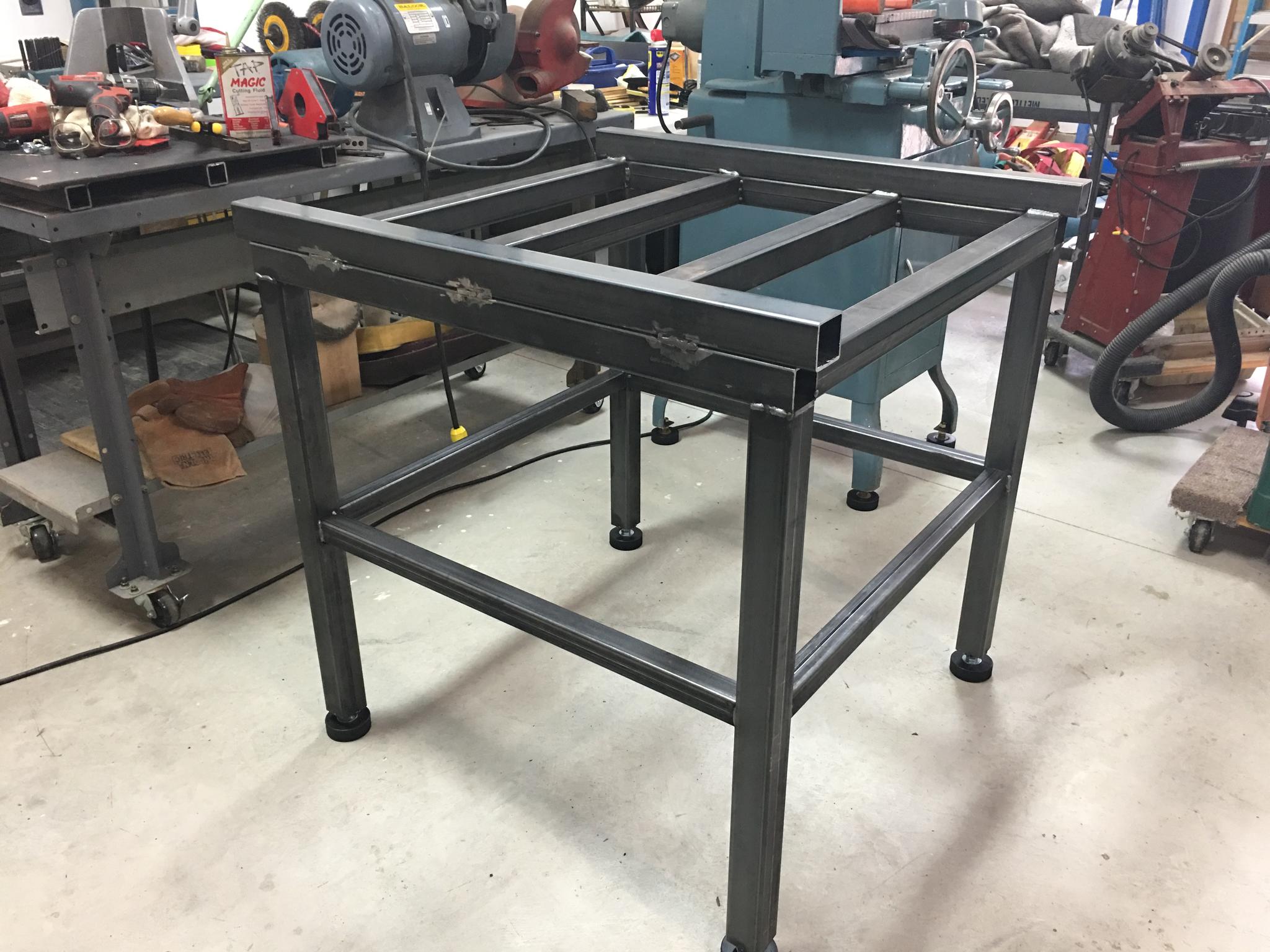

    Decided I'm at the point where a build log is in order. Still looking at wood only, but would like to toss 3D carving into the mix. Table is built from 2"x2" square tube steel, 1/8" thick. I will be adding steel strips for more thread engagement where needed.
    Ordered linear rails and ballscrews for Y-axis (X-axis?, still haven't figured that out) from Fred at BST. Trying the 20mm Chinese ones. Saving the 35mm NSK surplus ones I ordered before for a later project.
    I know I'll get bruised up a bit for this, but I am somewhat "designing as I go". Getting handier with F360 though, so I'll finalize a gantry design before going that far. Here's what I have for now:

    Questions:
    1. More bracing needed? I am thinking of angled supports for top rails.
    2. Any experience with the Chinese rails from BST?
    3. What should I be thinking about now to avoid headaches later?
    Thank!
    Wallace
    Hi Wallace,
    I would brace the underframe a bit with either some vertical pieces mid span, or diagonal across each side.
    1.5kW spindles often come with ER11 collet (max 7 mm), although some are ER16 (max 10 mm). But my advice is go for 2.2 kW and ER20 (max 13 mm) as it will give you more options. The extra power will help with the torque at lower speeds. They are all 80mm diameter for the main body so shouldn't effect your design.
    If the gantry will ride on those side members is there enough clearance in Z movement to the bed? Check they are going to be high enough.
    If I did a couple vertical braces mid-span, you think I'd have to then add legs in the middle too?
    You are dead right on the collets. I have an ER32 shank for my Bridgeport and was thinking ER16 was ER32 (powers of 2...damn computer geek :). I'll look at 2.2kW spindles.
    Not sure I understand the Z clearance question... I'm planning on a beam gantry (if I have my terms correct), so wouldn't taller sides give me the clearance needed? Within reason of course.
    Thanks,
    Wallace
    Taller sides will get you there! And from what I understand that's perfectly alright for wood routing.
    If you plan on aluminium then raising the frame sides are a more rigid solution then taller side plates for the gantry.
    Glad to see that you are progressing :D
    Skickat från min SM-N910C via Tapatalk
    Also the braces that routercnc mentioned are most likely diagonal braces.
    If you brace diagonally in as many directions as possible it will reduce flex in the entire machine when you are routing full speed later.

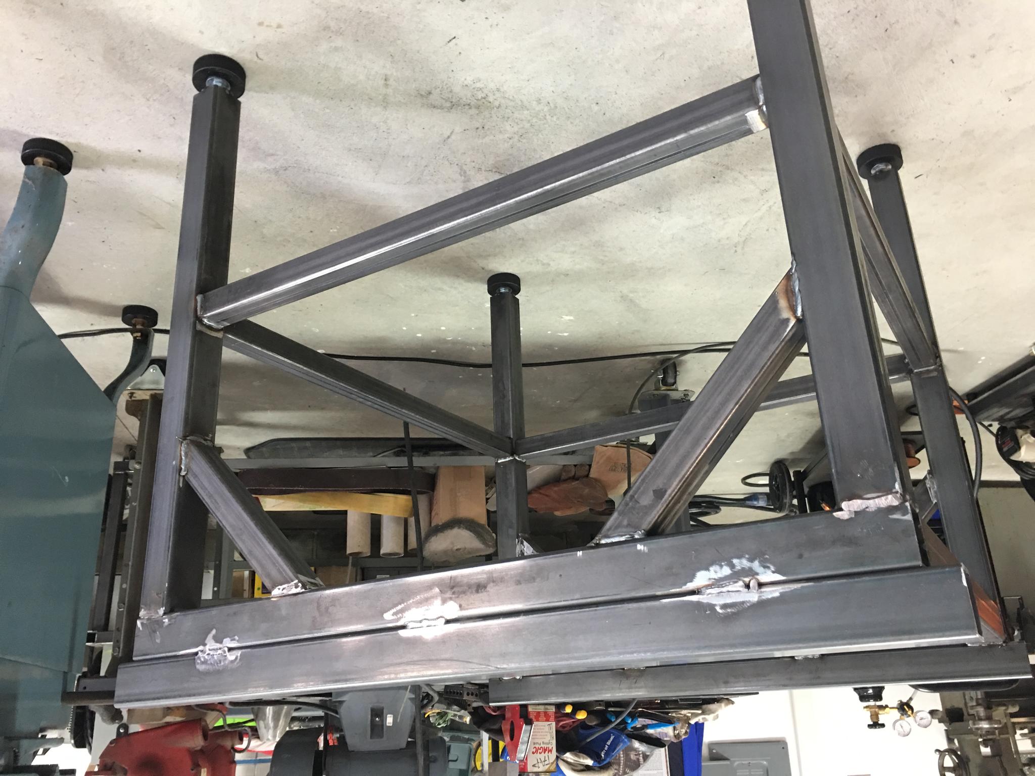

    Added these:
    Epoxy should be here this week...
    That's good in front to back direction.
    Side to side could use some diagonal lovin aswell ;)
    What epoxy have you ordered?
    Yeah, you're probably right. Sigh, I never thought I'd get tired of welding!
